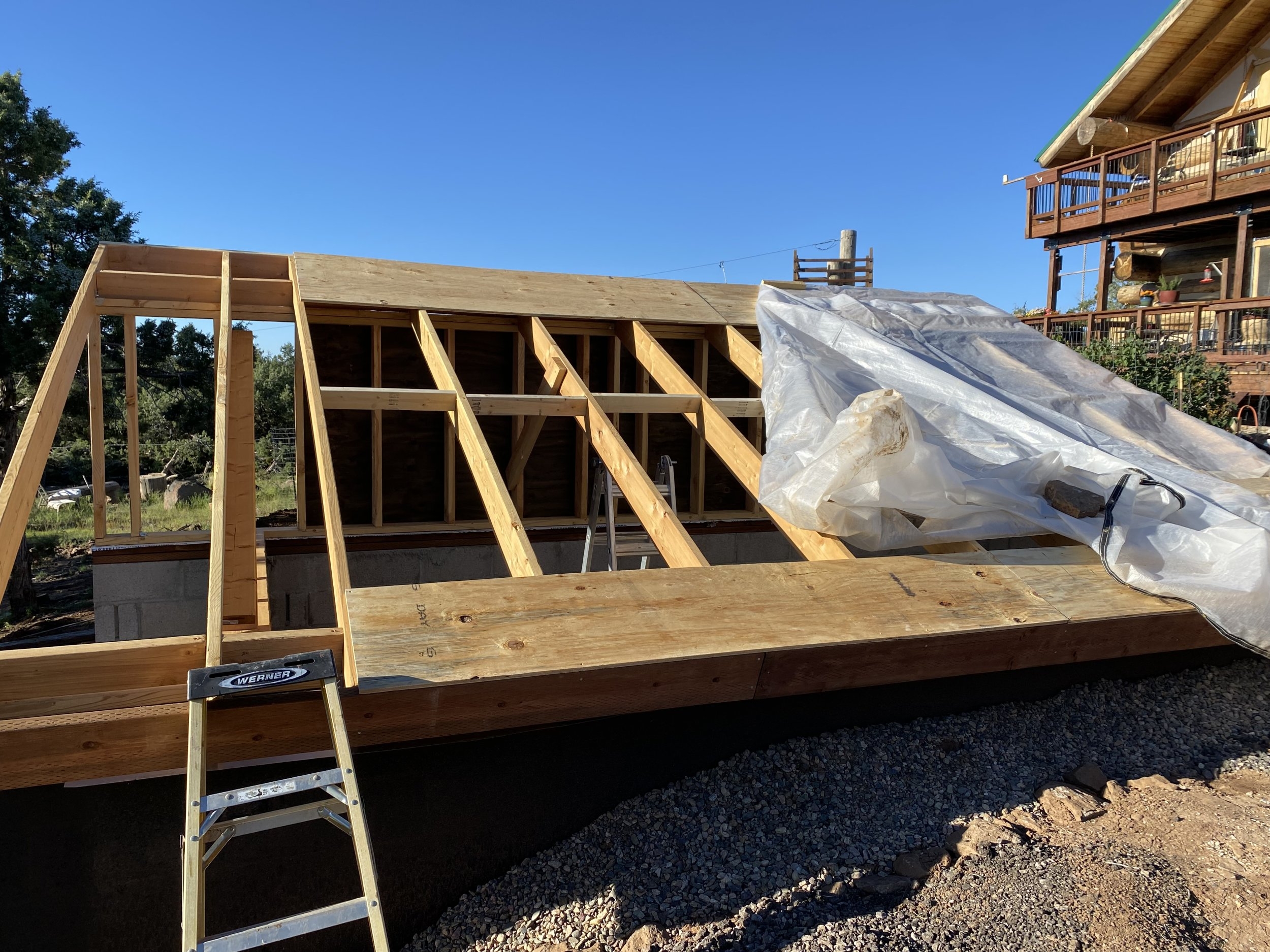

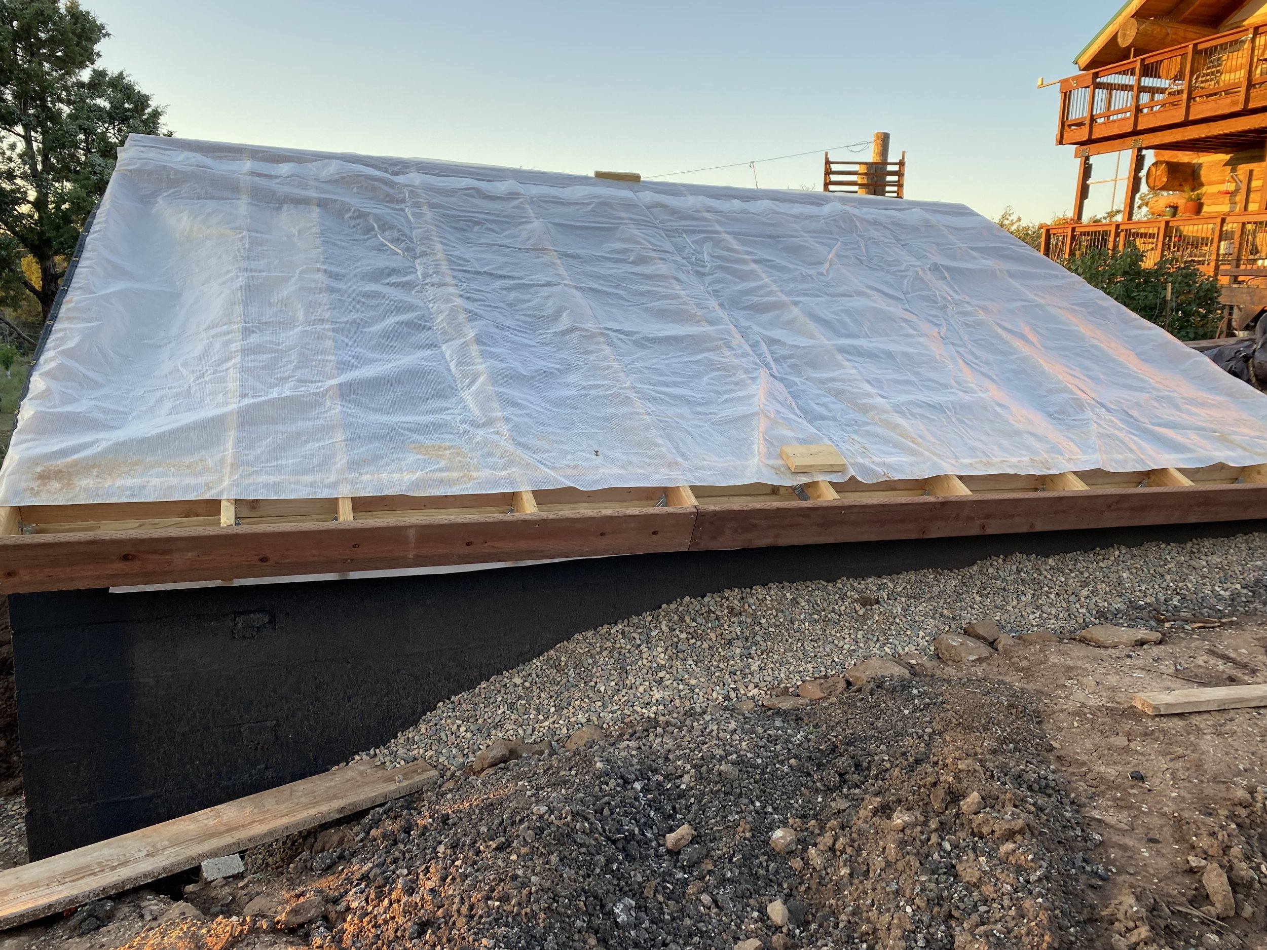

Framing done. I found an old roll of heavy plastic in the Conex and it’s exactly the right size. It will do until I order my polycarbonate panels.

Don't you need purlins going across your rafters for the poly panels?
   / AZ ranch
#1,424
I’m still honing my search for panels. Hopefully they will be 4x10, in which case I’ll put a 2x4 at the top and bottom.
I’m trying to keep it as open as possible to keep anything from blocking the sun.
The rafters are 12 ft long, so I’m thinking of putting a 12 inch strip of plywood across the top and bottom to fill in where the 10 ft panel doesn’t cover.
My neighbor suggested 2 rows of 6 ft panels but I don’t see any point in having polycarbonate panels beyond the bird blocks, as well as having a purlin right in the middle of the roof.
   / AZ ranch #1,425
I know there are 4 x 8 sheets, but I've never needed 4x 10 so you may have to go to a distributor. I would recommend some purlins. Mainly to keep it from warping over time. Make sure you predrill it first, then don't tighten your fasteners too tight, where it dishes the plastic.
How are you going to join the sheets? Does it matter if it leaks rainwater? Are you going to put a rainfall collector inside? Sorry for so many questions.

Home Depot has Lexan sheets with “H” profile strips to go between the panels and “U” profiles for the ends. But they only carry 6mm in that brand. They have Ejoy panels in 10mm, which I’d rather have, but they don’t carry any profiles or connectors. Go figure. So I haven’t finalized which panel or size yet.
And if I can’t get 10ft panels, should I settle for 8 ft or use 8 footers and cut up a panel into 2 ft wide strips to get my 10 ft? Just makes more seams.
One company online had what I wanted but then wanted $550 for shipping. Ouch. So I’m still looking.
I already cut a dozen 2x4’s at 22 1/2 inches that I was going to put midspan to prevent warping. Just haven’t put them in yet.
Yes, I will put a gutter at bottom edge and put a barrel just inside.
I prefer that there are not any leaks.

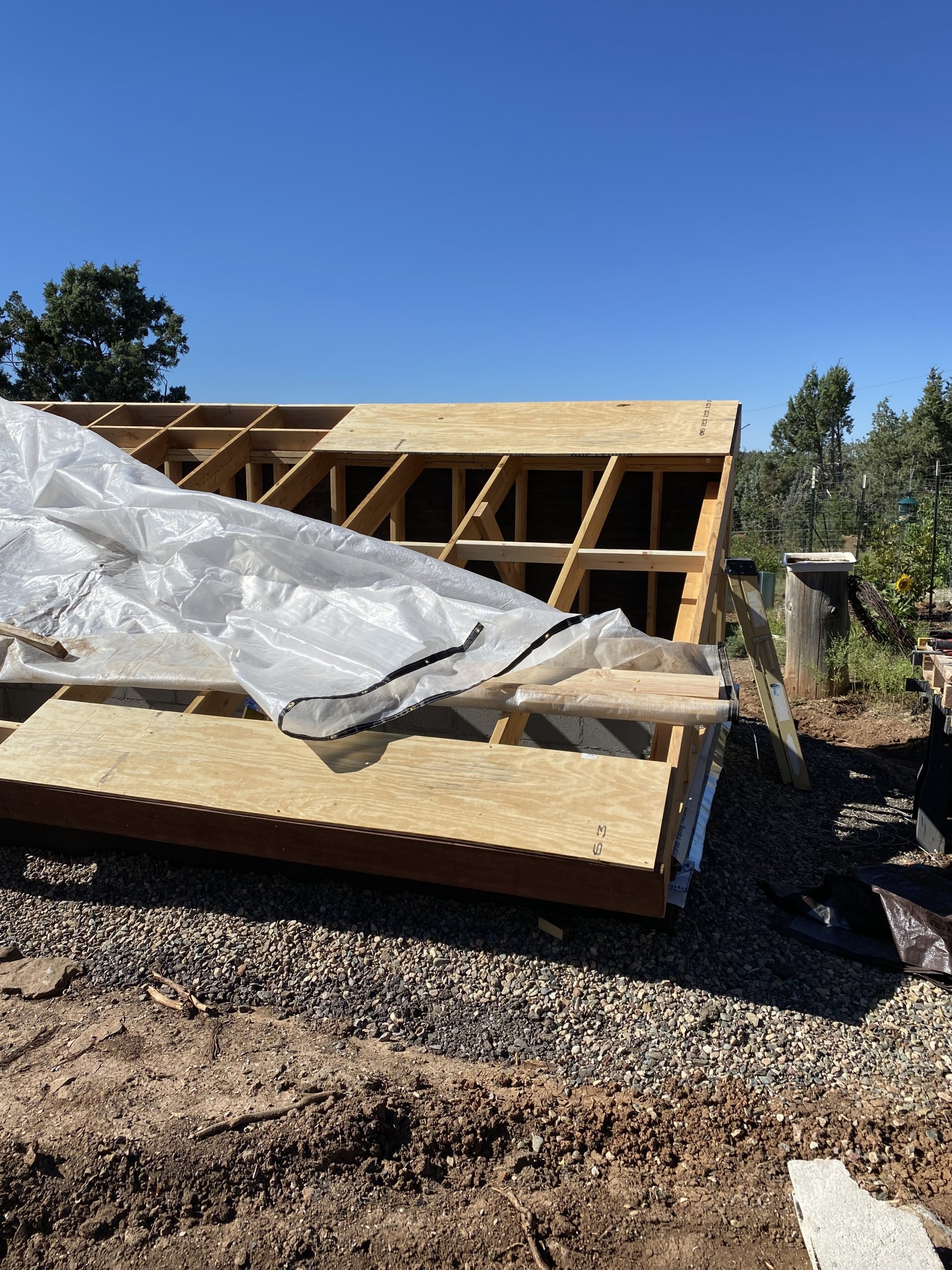

Eddie, is this what you meant by purloins? I always intended to put 2x4’s in between the rafters, but I’ve always heard that referred to as “blocking”.
So I have 2x4 blocking at the center of the span. Then I put 30” of plywood at the top and 18” at the bottom. That leaves 96” for my panels, that just ordered.
