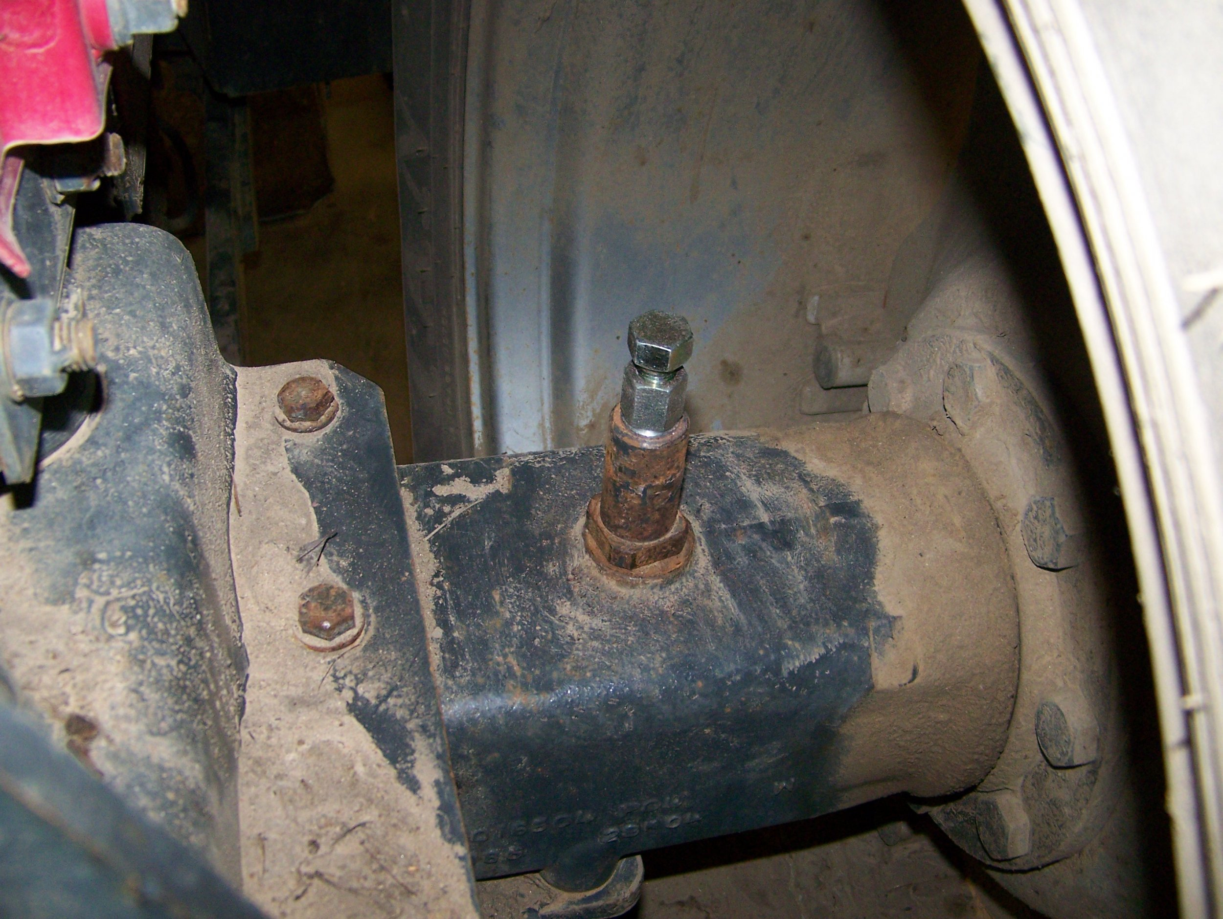

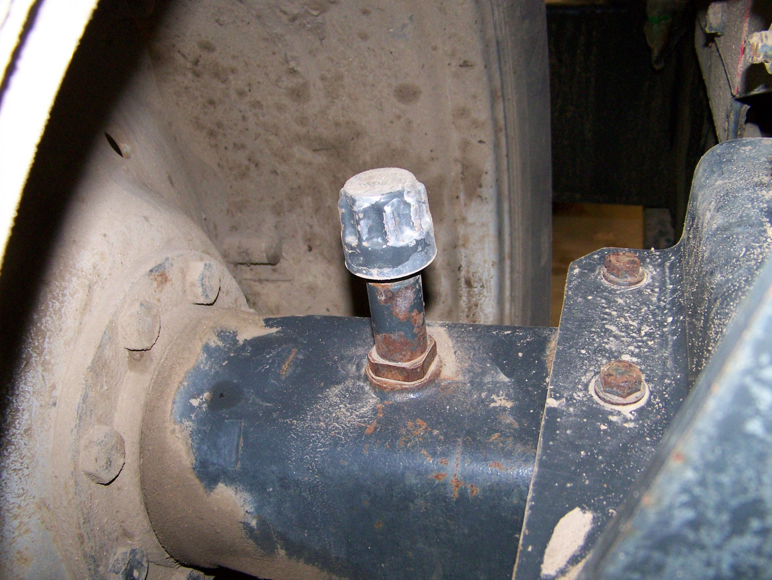

Anyone got one of these...........
I need to replace this one.........
MahindraUSA has none and doesn't know when they will.
hugs, Brandi

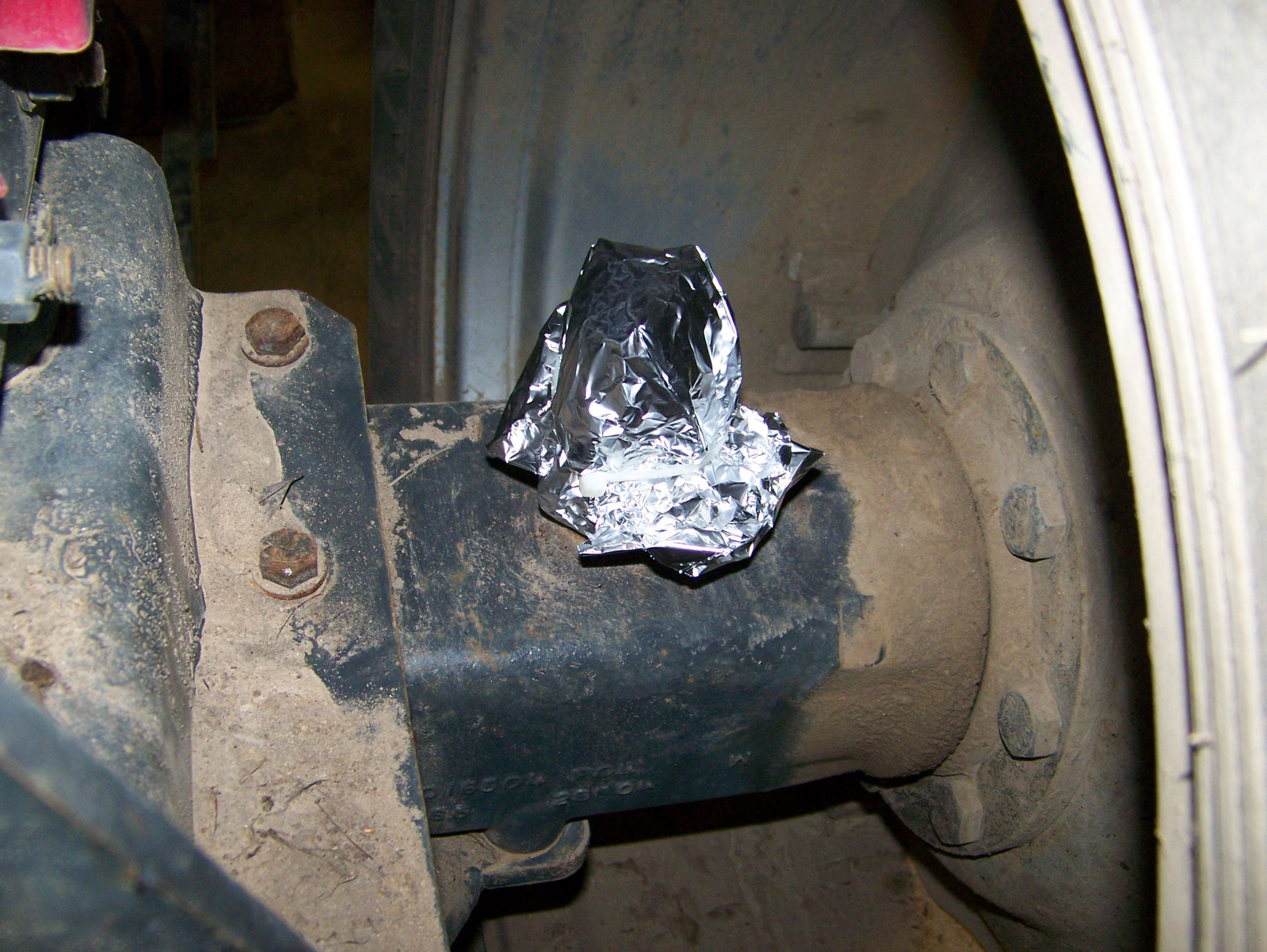

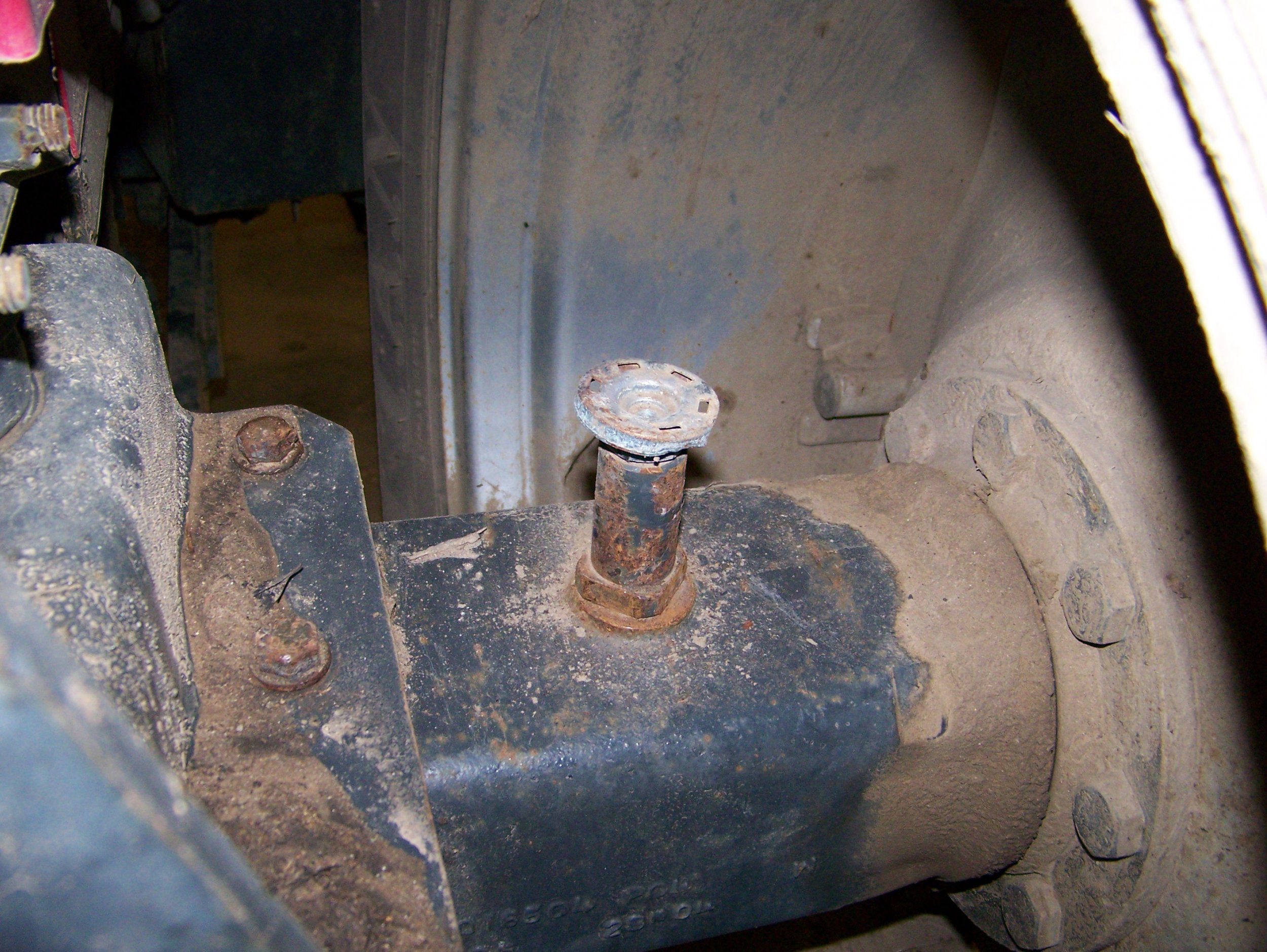

Mahindra says around 3 months. I have two back ordered. I got a thread adapter at my local hydraulic shop, along with a vented cap. No capped breathers. The adapter is 1/4 BSPP to 3/8 NPT. I ordered two 3/8 inch breathers from easternmarine.com. BSPP is British Standard Parallel Pipe
For now, I installed the vent........
Wrapped it in scotchbrite..........
Covered that with foil to keep the dust out...........
hugs, Brandi
