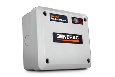

Generac makes load shed devices that don't need the extra low voltage wiring back to the generator. And they work with any generator not just Generacs. You can set the preference order for the loads. They work by sensing the drop from 60hz that indicates the generator is struggling.
There's also a cool open source monitor that runs on cheap generic HW:
