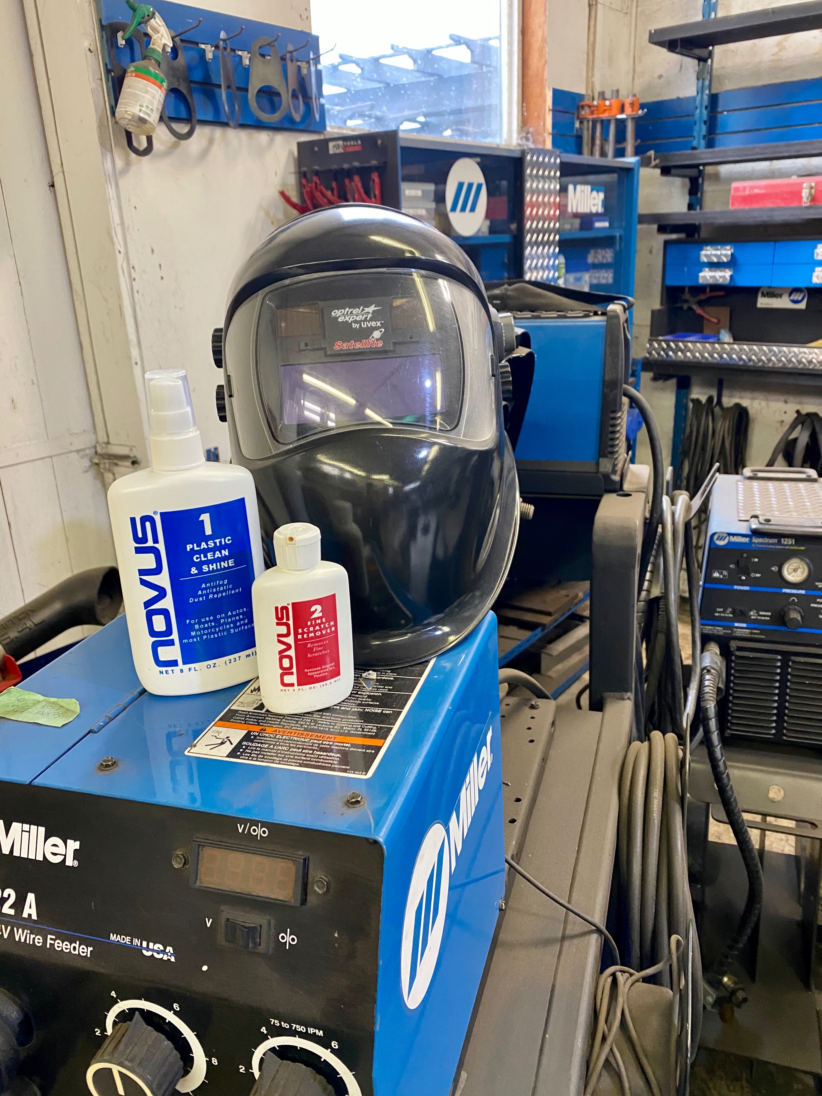

Another thing to consider is scratches on the outer lens cover impeding vision.
This is what I use.

Heck the protective 'cover' is merely a clear plastic. Lots of sources for that material.
My el cheapo even provided me spares.
Correct but nothing wrong with keeping them clean or scratch free rather than bitching about not being able to see.
