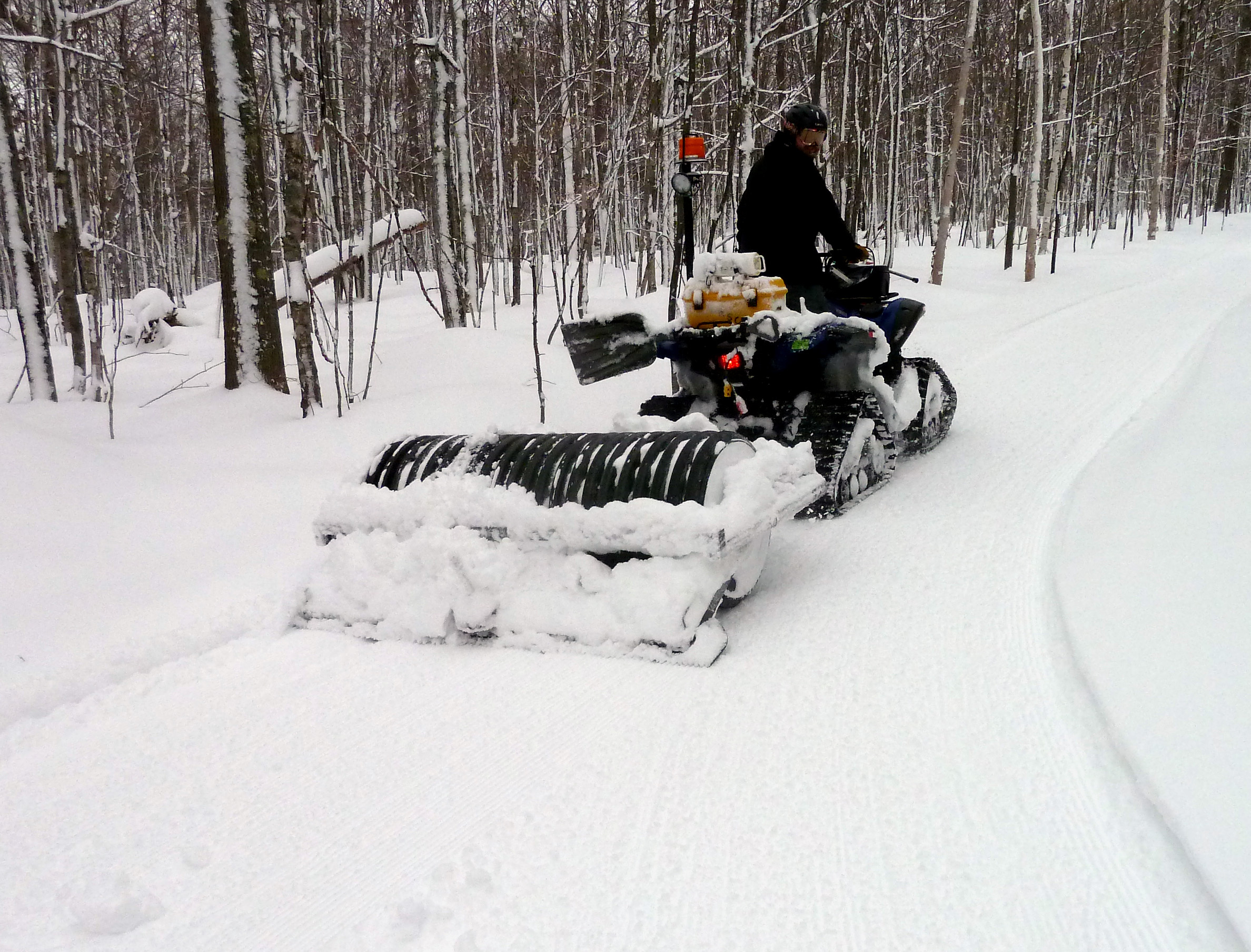

For years we operated 700 Grizzly's and Kodiak in hash conditions. I'd call them good.
