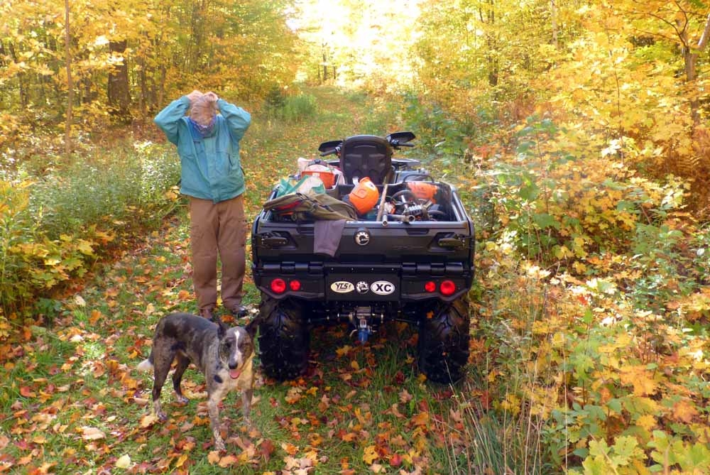

After 35 years of riding Honda, Suzuki, Polaris, and Arctic Cat I bought a brand new Can-Am Outlander 570 last year. It's been the worst piece of **** I've ever spent money on. I work on it more than we ride it. 13 months old now, 800ish miles on it, and I think it might be to the point where I can use it this summer without fixing something else. What a piece of trash.
The plastics have gone brittle and literally fell apart in some areas, it overheated constantly so I had to install a radiator relocation kit, servicing it is a nightmare, brakes literally fell apart and the pads and calipers were destroyed, front diff whines like a couple of cats fighting, front diff drain screw is installed from the factory at an angle so it got stripped upon first service, I can't even remember all the issues. And this is in the first 12 months. Pathetic.
