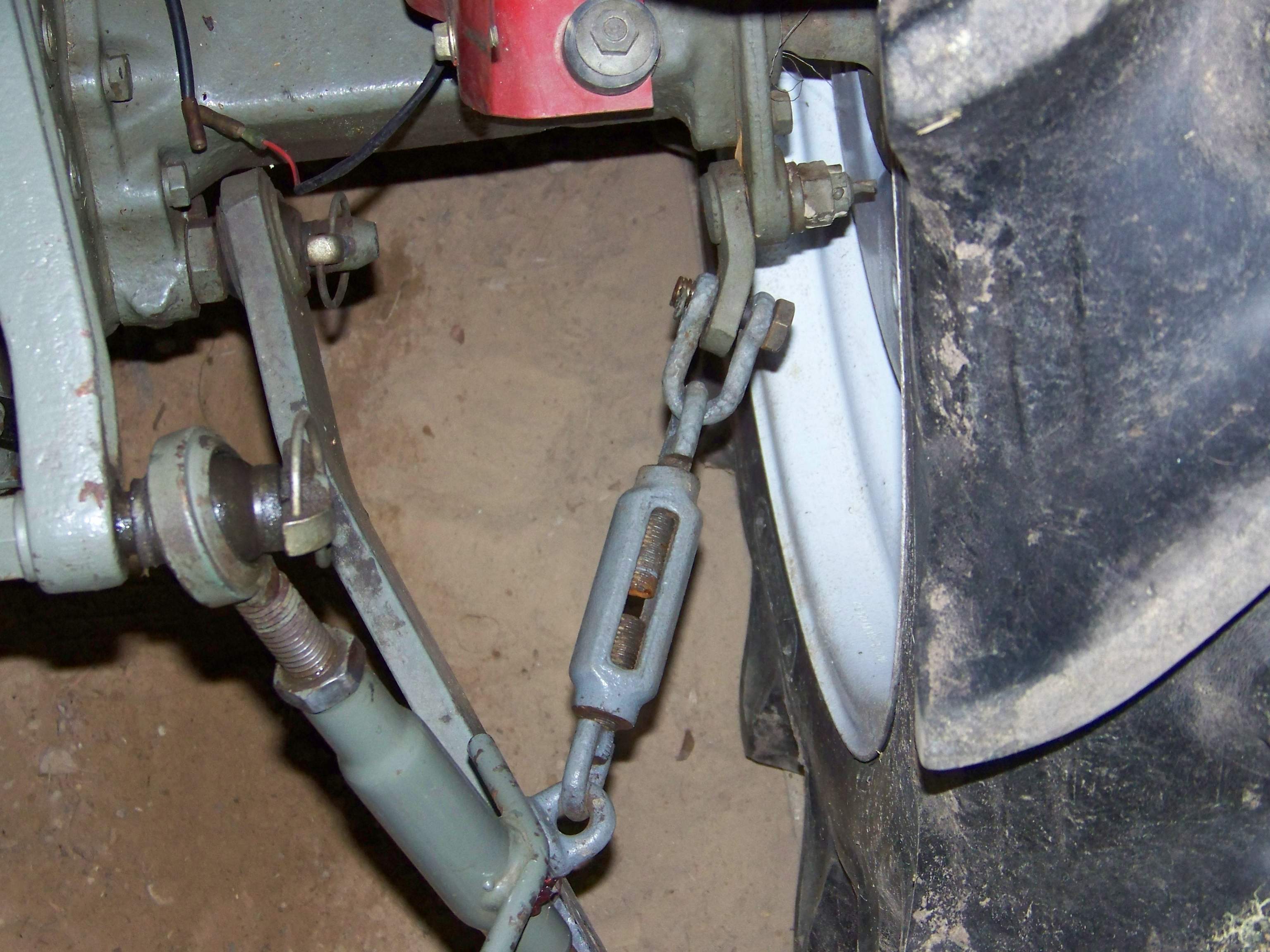

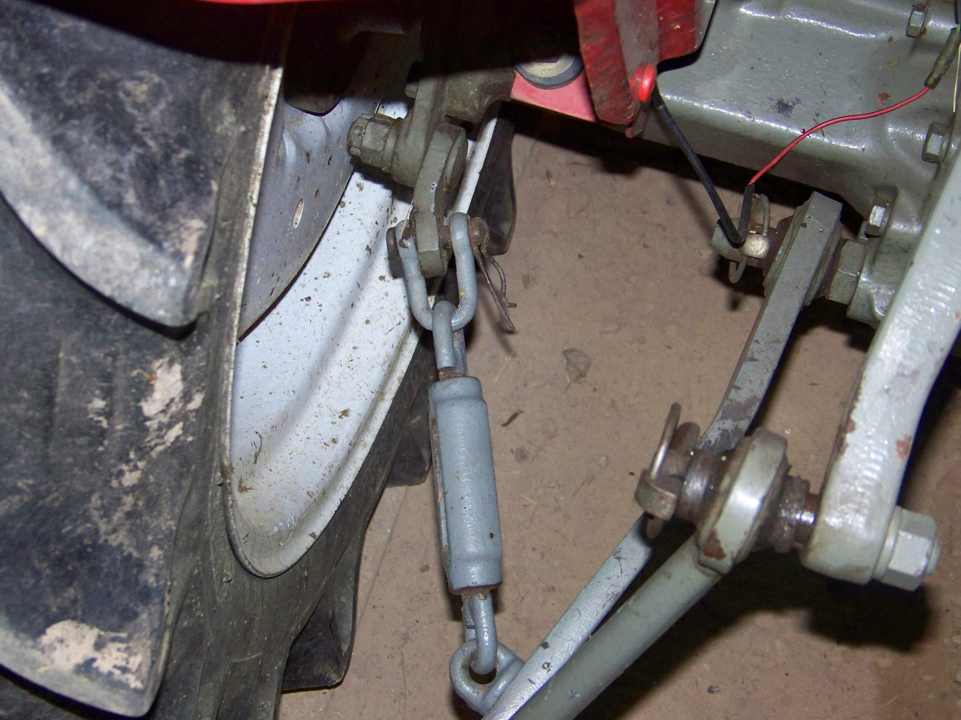

When I have my tiller or box scrapper attached and I get tipped to either side just a little bit the attachment starts to rub against the tire on that side and it is tearing up the rubber. This also tends to happen when I am turning around. How do I keep my attachments from beating up my tires?
/ Attachments rubbing tires #2
There should be adjustable anti-sway bars or chains holding the arms from moving over to rub the tires. That or fix the attachments so they are pinned closer to the center.
Post a pic if this doesn't seem like it will work for you.
/ Attachments rubbing tires #3
Here's some pictures of a typical sway chain (stabalizer chain). You should have something similiar to this, if not you need it.:)

If you have the mounting pins on the attachment pointing to the outside, reverse them so they point inward, on the inside of the attachment frame. That will gain a few inches clearance for you.
/ Attachments rubbing tires #5
i second tightining sway chains and turing the lift pins on the implement inward.
/ Attachments rubbing tires #6
Pins inward, tires reversed to wider stance, tighten sway chains. nothing else to do....I had to sell a landscape rake that did the same thing, with above mentioned solutions it was still to wide. The pins need to be no greater then 26" apart, if an implement is wider I pass on it and look for another.

reversing the tires will give you about 3-6 inches clearence and the pins will yield about 1-3 inches, do both easier to hook up with inner pins and wider tires will also make you more stable and these are such narrow machines even in widest setting you wont give up manuverability.

My Yanmar is a 2310D, it does have the sway chains that I have tried to shorten (I'll need to play with this some more), I thought about switching the tires because I noticed that the mount point is not in the center of the rim (question: are the bolts on these Left for Loose or are they the opposite?), I hadn't thought about changing the mounting pins. Thanks for all of the help, I'll let you know how it goes.
Layton, Just in case you are talking about the turnbuckle bolts one end is right hand and one end is left hand. When you turn the turnbuckle it will lengthen or shorten depending on which way you turn it.
