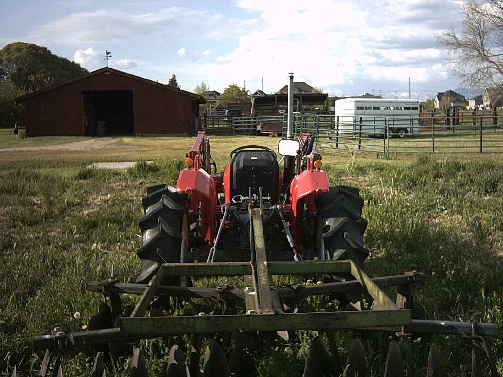

Man what a bueatiful view you have there.

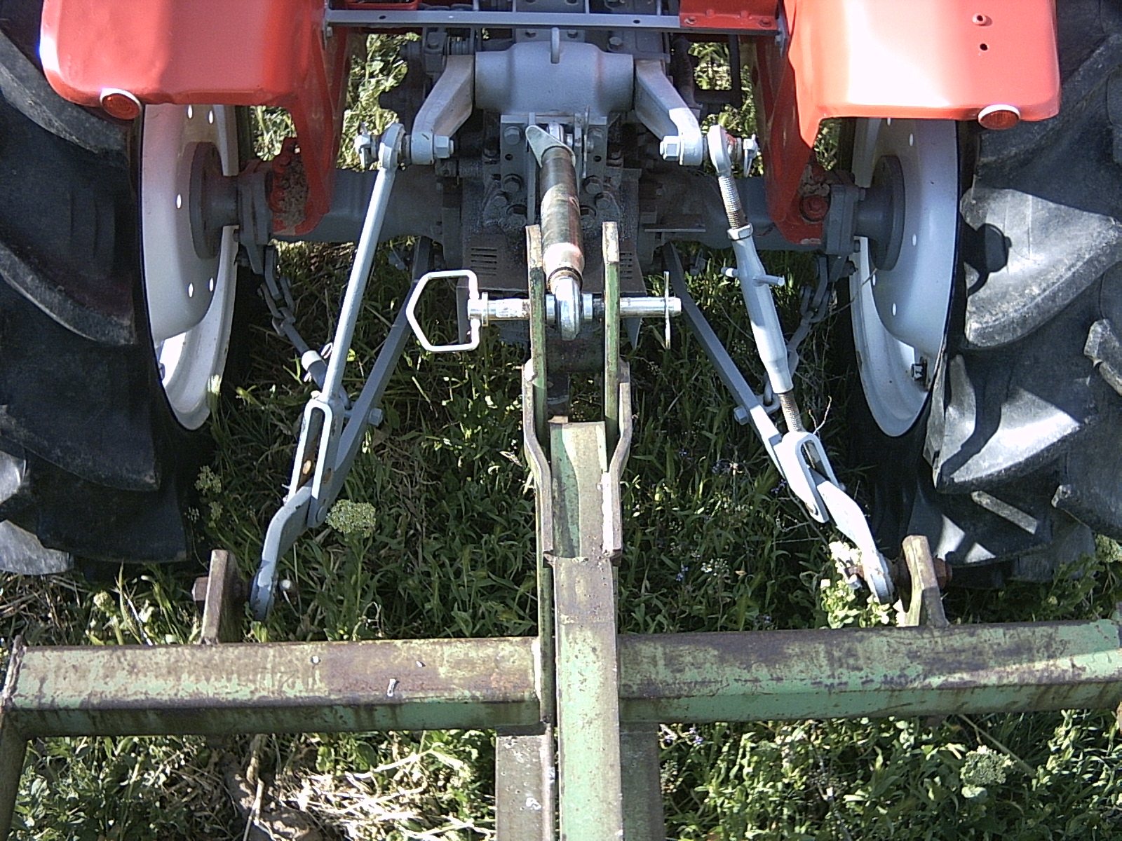

Smoody, i can lift my 16'' disk off the ground but not much room, it barely clears when i go to back it on the trailer.

Just thinking out loud .... would not longer arms help... like 30 something ??

I love the view too, and the neighbors are the best. I do have one more pinhole on the liftarm that will give me another inch or two but the height is a bit of a challenge going through any kind of dip. The disks are 19" and in the picture with the 3 point fully raised I have about 6" of clearance on the front row and about 11" on the back.

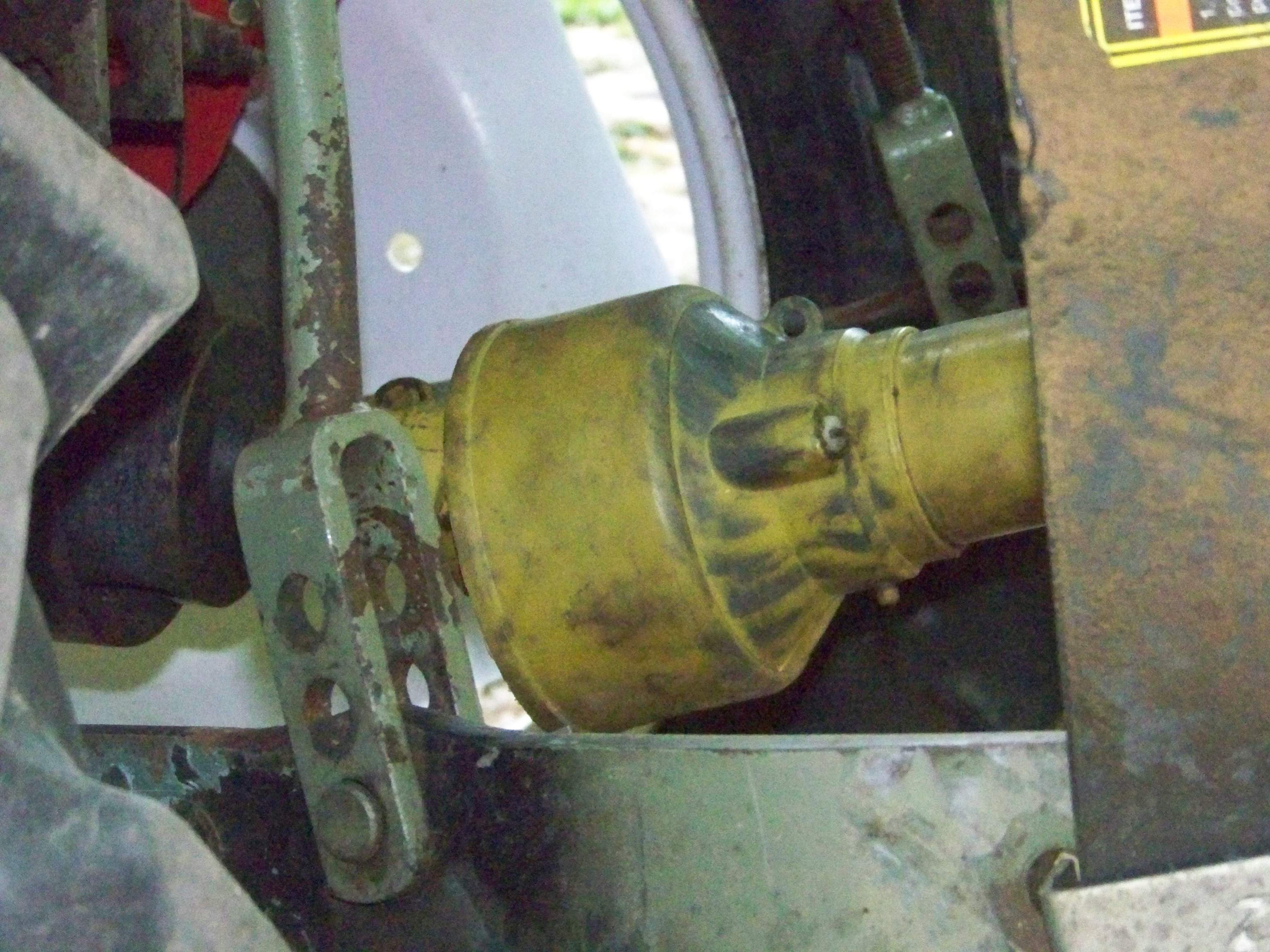

I bought a hay spear and the pins would rub even when turned inward. I had a local machine shop to make me some more pin brackets and angle braces. I welded them to the spear hitch and it brought the sway arms into a good position so no more rub.
/ Attachments rubbing tires #27

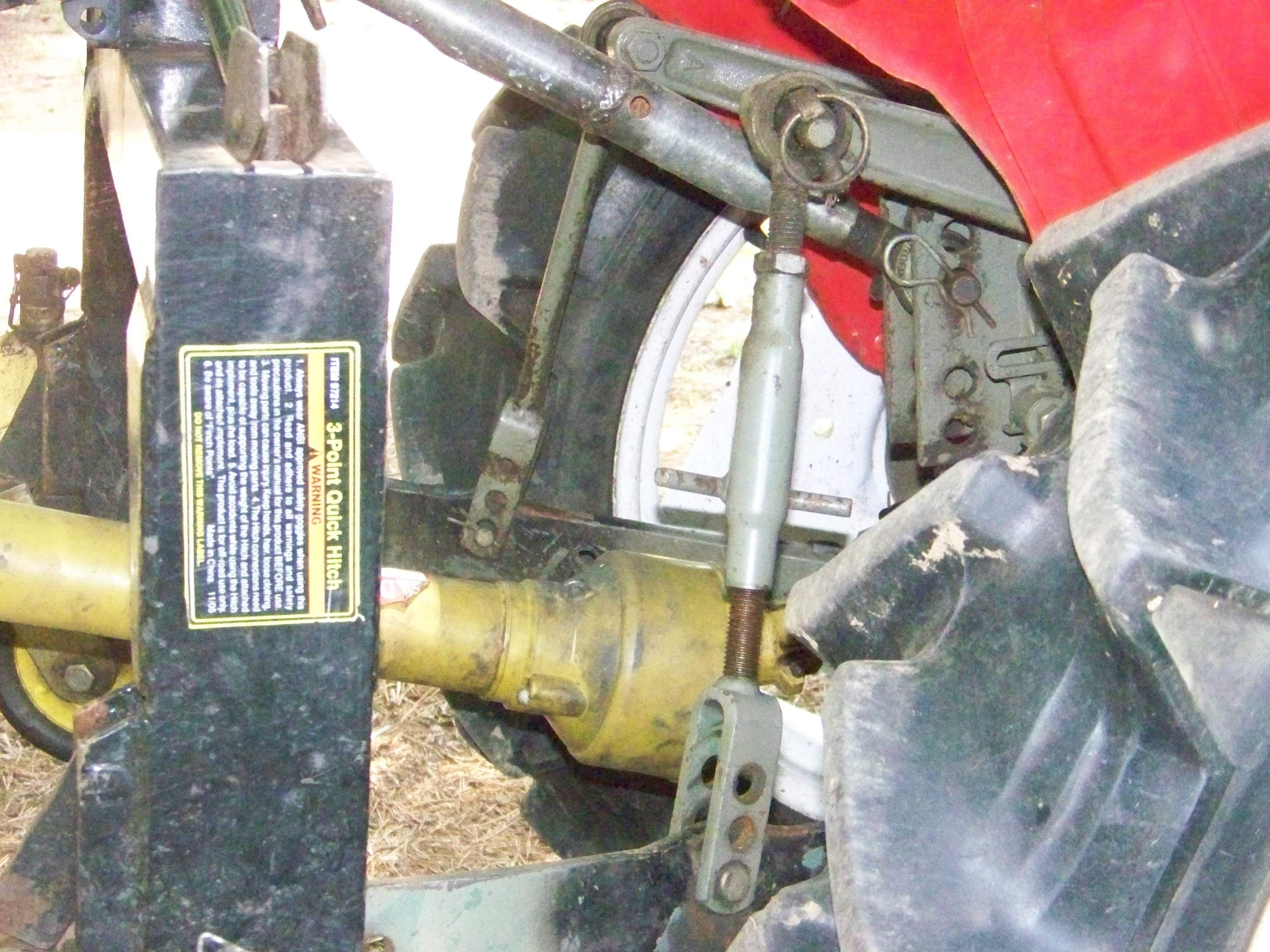

If the pins were rubbing your lift arms are too short. If the lift arms were rubbing, either your sway chains are too loose, you need to widen the wheel stance, or you have the wrong size implement. You should never have to re-design anything to make it work.

I think it was just the width on the hay spear. On my bush hog and box blade i just had to turn the pins inward, but with the spear, the arms were spread just about to the tire tread. Every time I bounced, the lift arm would grab the tire. So I modified the spear and brought the arms in more. It looks great now, I just havent used it yet..

When I bought this 5' FM. it was close to my Rears also which are spun to the Furthest apart and still was to close for comfort for me so I turned in my Pins also. Works Great :thumbsup:
