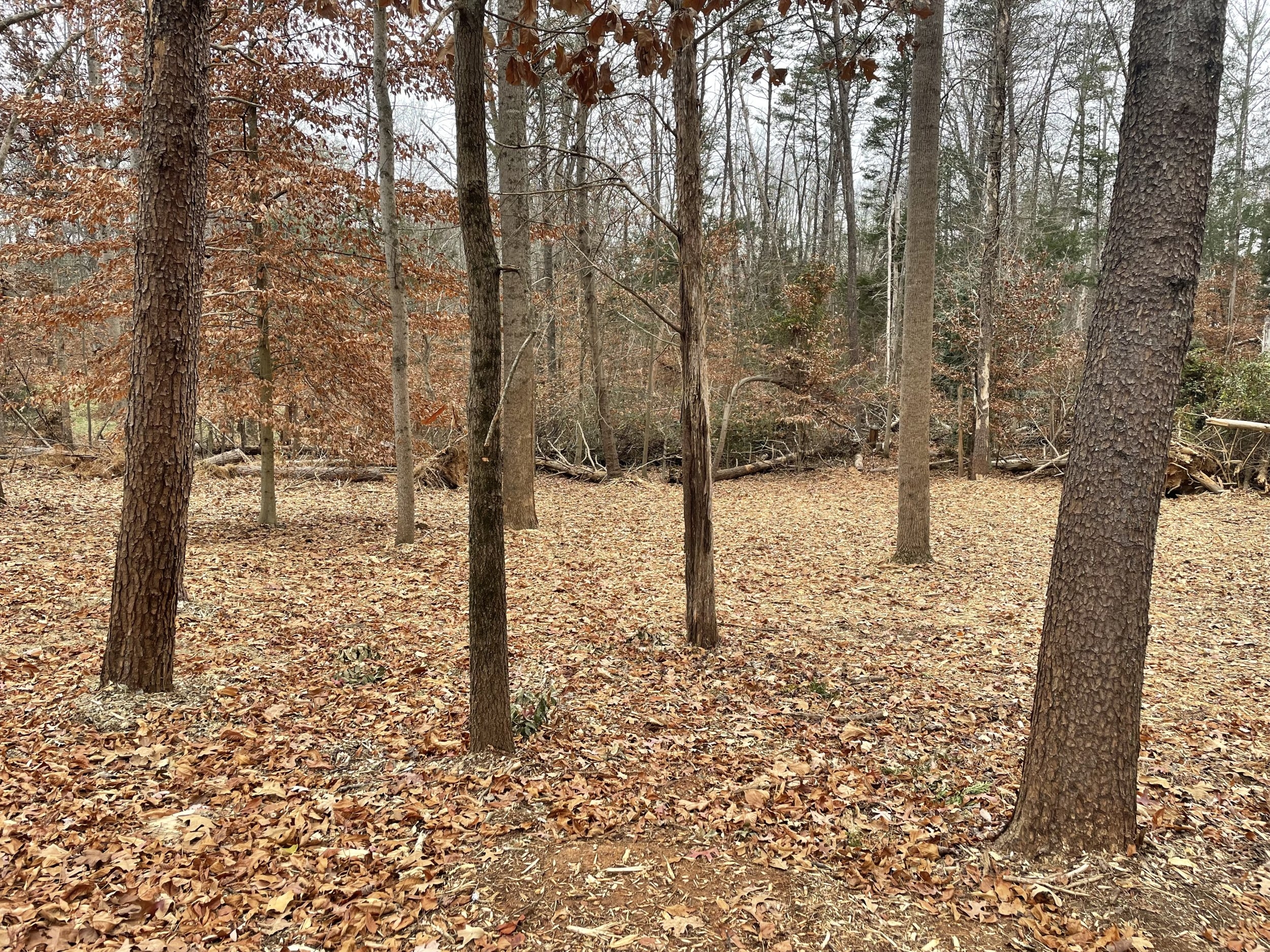

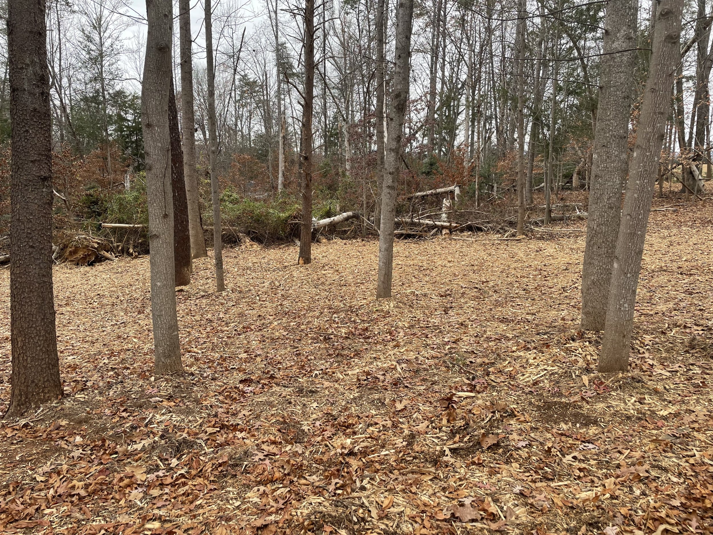

Recently I had a forestry mulching service clear much of our wooded lot. It looks fantastic! So, in order to maintain it - dig up saplings, weeds, undergrowth, etc. I am looking at a ratchet rake for my John Deere 1025R. I previously had a rear rake but never used it. Other thoughts were the rear dethatcher from Good Works. This seems less ideal but I have a BXpanded tooth bar on my bucket so between the two I might be ok, and the dethatcher would be good for fall leaf cleanup. Any thoughts?

So, I guess the question is; what do you want it too look like? Do you want grass, and non-woody veg to take over? Are you wanting to plant grass, cover, or food plots? If so, I would disc, staying about 4 ft from the base of the trees. I know a 1025 isn't going to pull much of a disc, but the problem with a mulcher is, it doesn't do anything about the root systems, and they will quickly shoot woody stems back up. Or is it a general wood chip/leaf thing you want to clean up?
Without seeing what was there before the mulcher; I would expect a lot of regrowth come early summer, once it starts raining. (or when ever your rains start; here, springs are can be extremely dry)
If it's the leaves/wood chips that your concerned with; I'd try to rake/blow/burn

Why not get a flail mower and mow it occasionally? It'll mulch up small branches and get the little stubble that starts popping up. Along with mulching up the leaves.
Would do much better than a brush cutter.

Looks clean and no sapling stumps or rocks to hang up on - use one of your GT's and mow at the highest setting a few times a year would be easiest. Get mulching or gator blades - they will chop up the leaves and are good for the soil and remaining trees.
I have a ratchet rake and it doesn't like rough/rocky ground - the loader jumps over the difficult stuff and makes more of a mess exposing the remaining tree roots you dig up trying to remove the saplings. If you still are set on removing them, you have a tooth bar so no need to get a RR IMO.
For stumps sticking out cut them down level with old chainsaw or trimmer with brush blade.

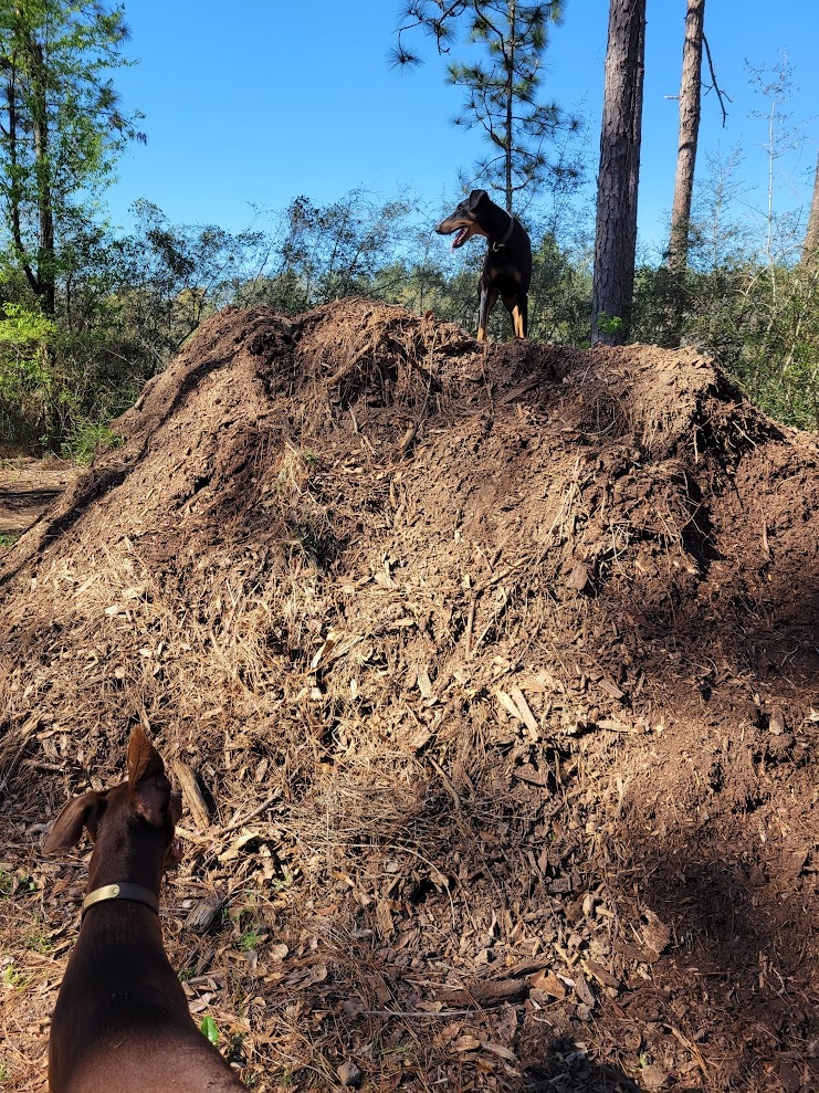

We did use a landscape rake to pile up a lot of the mulcher shreddings, and now just mow it.
This is one of a few mulch piles we have, and we are 2 years post mulch, things are starting to break down and a decent compost is forming. Maybe another year or 2 and it'll be great for the garden, for now, the dogs like it.

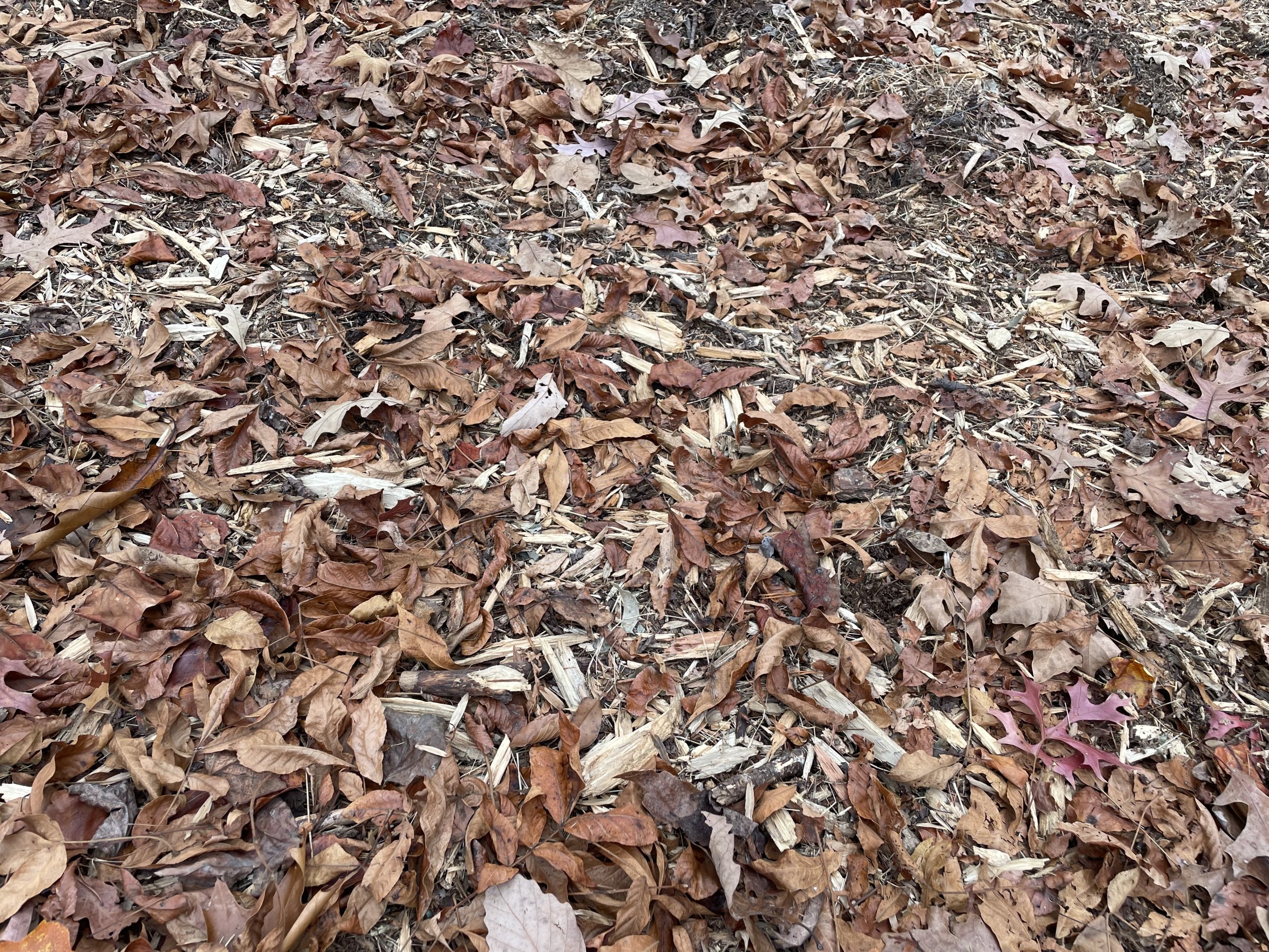

Grass is starting to fill in the areas that get enough light. As above, we've found zero turn mowing is the fastest and easiest to get around the trees. Unless you want a golf course, just mow the leaves a time or two and they'll be gone for the most part.

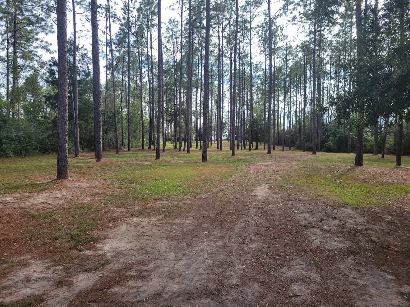

We use a heavy duty zero turn, the deck pulled to highest setting. What we cannot mow with the ZT we do with the tractor's brush hog. What we can't do with the tractor, we do with our walk behind brush hog.
We cleared a lot of land, seeded with a mix designed for low light, and now maintain with monthly mowings. So far it has worked well for us.
