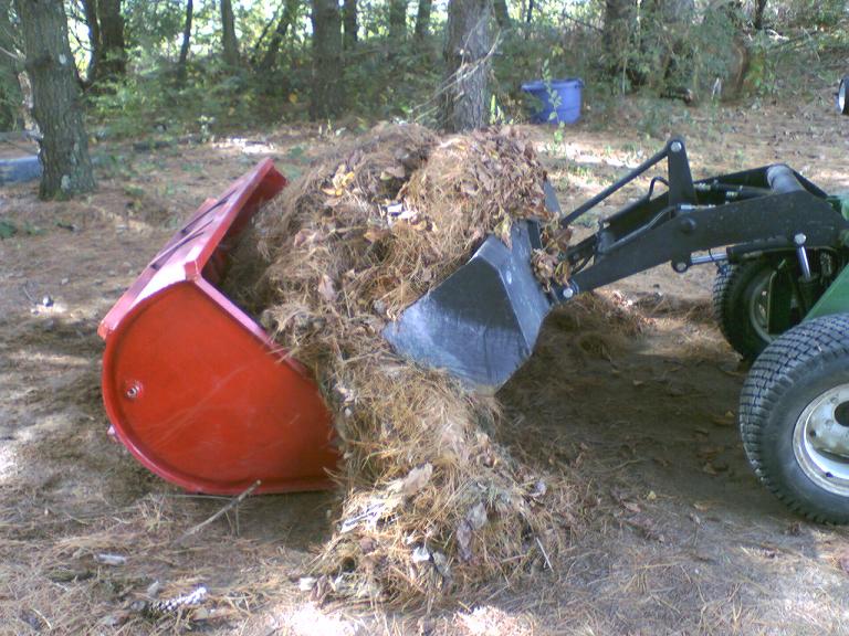

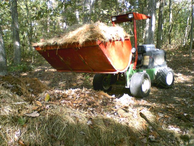

It took me awhile but i get it now. the teeth on the graple bucket /forums/images/graemlins/shocked.gif
/ Attachment Effectiveness #22
All you need is a nice big red grapple to finish out the bucket. /forums/images/graemlins/grin.gif /forums/images/graemlins/grin.gif
/ Attachment Effectiveness #23
</font><font color="blue" class="small">( All you need is a nice big red grapple to finish out the bucket. /forums/images/graemlins/grin.gif /forums/images/graemlins/grin.gif )</font>
May be so but it already weights about 250 pounds. Remember JJ i don't have a 1445 /forums/images/graemlins/smirk.gif
