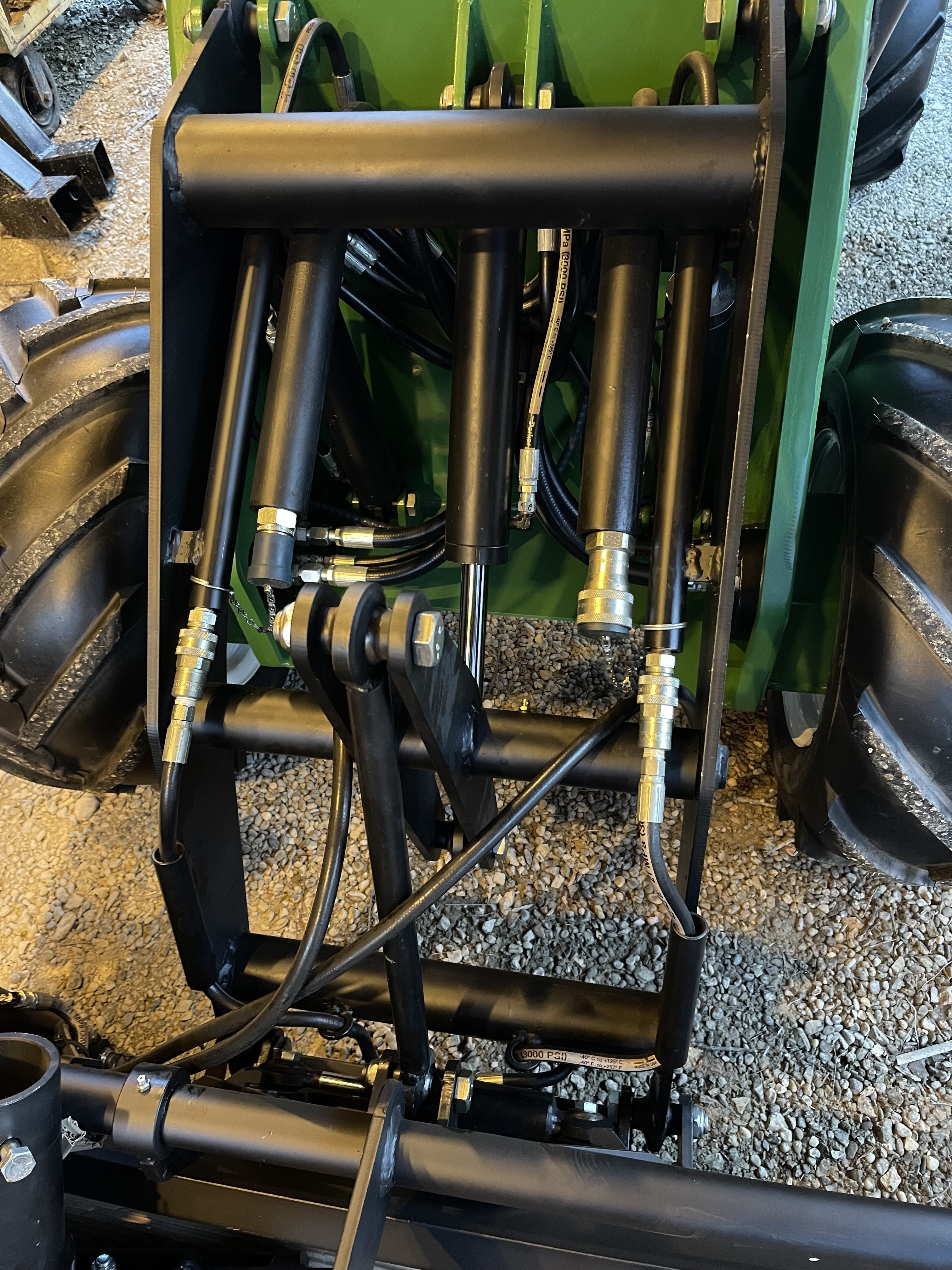

Our new 425 has the quick-attach feature that our old one didn’t have. I’m about ready to swap out the grapple bucket and put on the auger head. I got the run down from Terry on how to take off the grapple, but I didn’t think about any particulars hooking up the auger. I know there are the 4 hose attachments on the front end—the bucket currently uses two of them but the hoses to the quick connect are not hooked up. He did mention that the hoses only hook to particular connectors—can’t make a mistake. So, I drop the bucket all way down, then close grapple completely. Shut off engine. Move the lower PTO lever up and down several times to relieve any pressure, then unhook it all. Don’t I have to couple up the quick connect after that to position for the auger? And if so, after that connect auger hoses? Then unhook Connect hoses? 😯

Here is a pic of my hose connectors:
The outer two are for Q/A and a few other attachments that need it. E.g. post driver, 4n1, etc. Normally they stay hooked up. For my sanity, I put a colored zip tie on one of them, and then on one hose for each piece of equipment that I have that uses that circuit so the lever under the dash works the same way every time.
The inner two are the PTO supply and return, male and female, so you can't mix them up.

So the FAT hose connectors on the FEL arms are the MAIN PTO. These are for things like the mower, brush cutter, etc... things with hydraulic motors that spin fast. They are operated by the PTO switch on the dash.
The SMALL hose connectors on the FEL arms are the AUX PTO connections. They are operated by the lever by your right knee under the joystick. They are usually used to open and close the Quick Attach.
For things like the grapple, power angle snow blade, etc... you first pick up the implement and lock it in place with the quick attach, then remove the quick attach cylinder hoses from those small connectors on the FEL arms and let them hang. You'd then connect the small hoses for the grapple, power angle snow blade, etc... to those small connectors on the FEL arm.
Now, the lever by your right knew controls the grapple or the angle of the plow.
When you're done, remove them in reverse order, reconnect the Quick Attach hoses, and you can then unlock and drop the implement off of the FEL arms.
Make sense?

You want to be sure that all the connectors are clean before connecting them so that dirt doesn't enter the hydraulic system. I don't know if it's the best option, but I sometimes spray the connectors with carb cleaner and then wipe them with clean shop towels. There's a lot of dust and debris from mowing with the front mount cutter.

@Modrob one other tip on the Q/A hoses: if they are hard to connect, it means that there is pressure in the hose. For implements that need the Q/A hydraulics to control something, I find that after I put an implement on and lock it, that it helps to turn the tractor off, cycle the Q/A lever back and forth and then remove the Q/A hoses that the hoses have depressurized, and the poppets can be pressed in easily to meet the hoses on the attachment. Once in a blue moon the attachment hose is under pressure, and I use something like a short metal dowel or drift and a hammer.
While I just wiped my connectors initially, I have gone to shooting brake or carb cleaner into or onto the hydraulic quick connects to make sure that there is no debris in the connectors. There's no filter on anything that comes back on the return lines.

That's a good point to mention for new PT owners regarding hydraulic connectors that won't connect. I found the same issue when I first got mine.
I left the mower disconnected in direct sunlight. For the life of me, I could not get the connectors to attach to the machine. I resorted to taking a wrench and cracking the connection on the hose open to let some fluid out.
Later, it was Bird (RIP Bird) who told me to put a flat punch in a rag, push it against the bump in the connector and give it a light rap with a hammer. It only took one drop of hydraulic fluid to come out to relieve that pressure.
So over the years, I've had to do that 3-4 times.

I finally got around to seeing that little nib down in there and on the feeder line (maybe I should call it “tractor” line?) It did cross my mind that maybe a little pressure could be holding things up, so I did press on them and they moved. Still was having no luck…but it was soooo close. Both were difficult but one side went on a little easier with just some maneuvering/twisting. It was as if they were so new that they were just really tight fitting. I lubed up the locking collars a bit and with a little more fiddling, it finally went on and locked. Whew!

I buy caps from PT, or Summit racing, the latter either via Amazon or directly. Just make sure that you are getting the size right. I prefer the softer ones as some of the hard vinyl caps that I have bought over the years hardened to the point where they wouldn't come off, or go back on.
I couple all of my implement hoses together M/F. It helps the couplers stay cleaner, and keeps the pressure equalized for the most part.
Even with caps, at least around here, it seems like dirt gets in there, but caps are way better than no caps. Also, the sliding collar of the coupler needs to be clean outside and inside because the locking balls can carry dirt into the coupler. Every so often, I will blast air, then brake cleaner then air until everything moves freely, and then lubricate with PTFE laced silicone (SuperLube). Yes, it attracts dirt, but less than dry lubricants for me because the dry lubricants don't keep dirt out of the collar.

I replaced mine with flat face connectors - easier to keep clean and connect.
I have some on other equipment, and love them. They do stay much cleaner and are easier to connect. I do wish I had them on the PT, but the total expense seemed like a personal extravagance. I will probably get there.

If you decide to go the flat face route, check that the couplings are up to the flow and pressure of your PT.
