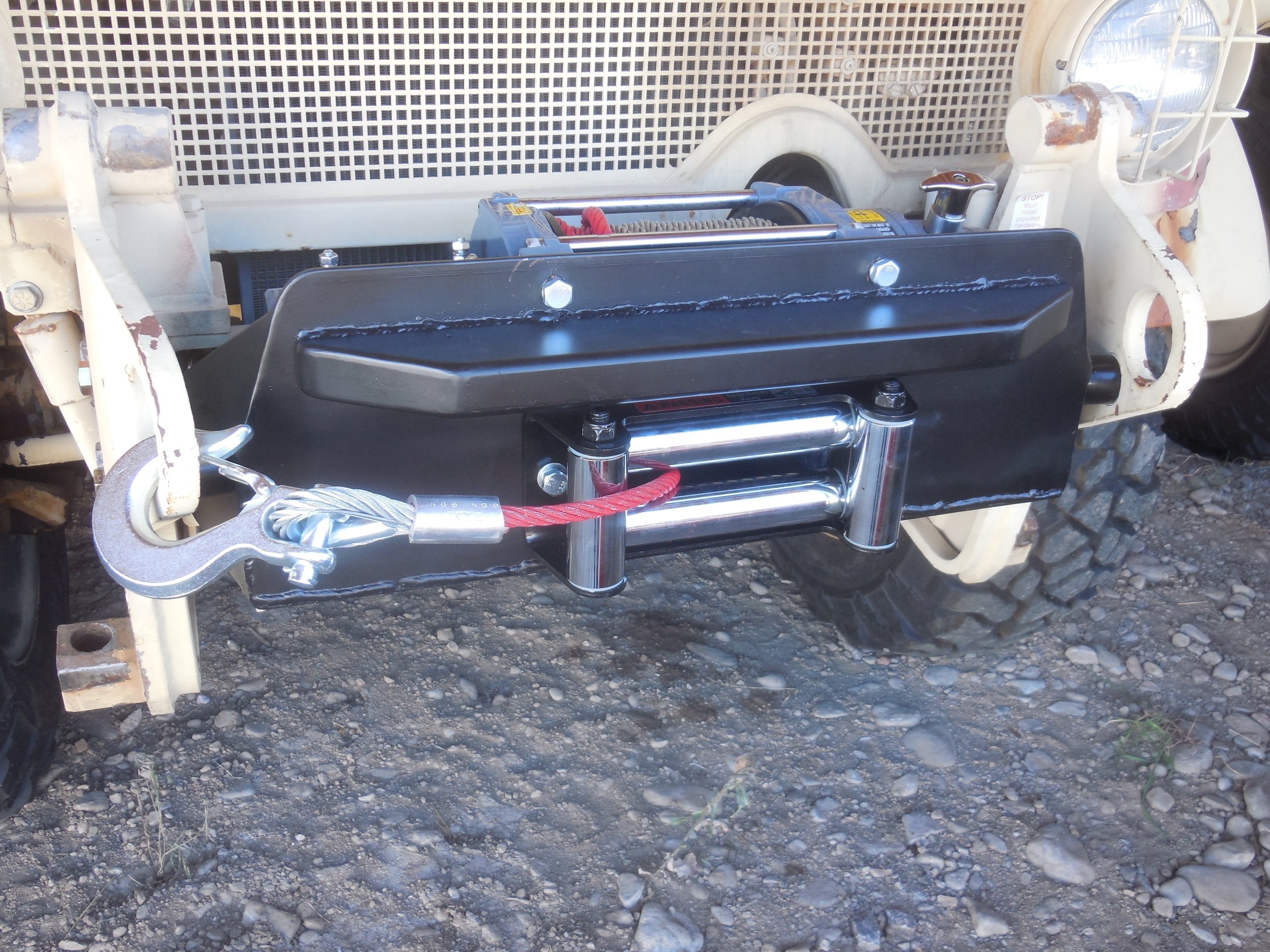

About two years ago I installed an 18K winch on one of the Unimogs, one of maybe two dozen winches I've added to various vehicles, basically to be able to upright a tractor if needed.
That was the most complicated mount to make to date, due to very little space to work with, but being able to pull the skid steer out a couple of times made it well worth it.

No, there's no PTO capability on that particular model. It's used up by a pump for the rear hydraulics, which power the backhoe.
So I went with an electric 18K ComeUp. One big advantage is that it can be operated remotely, so I can be in stuck vehicle while winching.

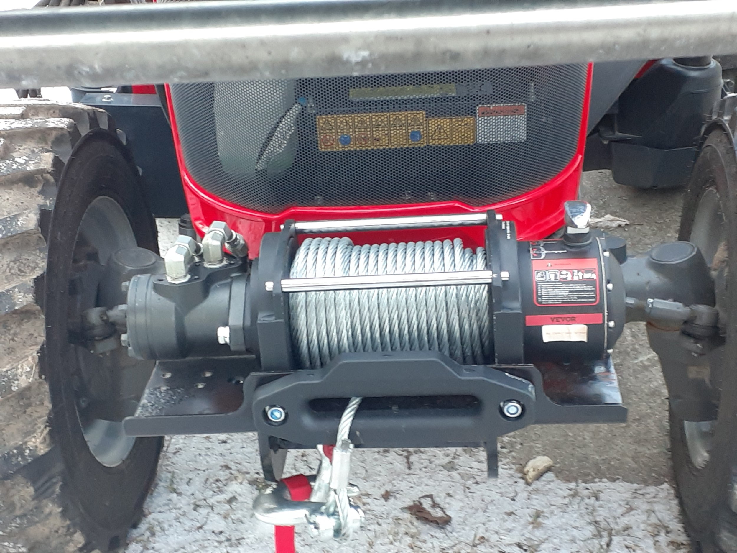

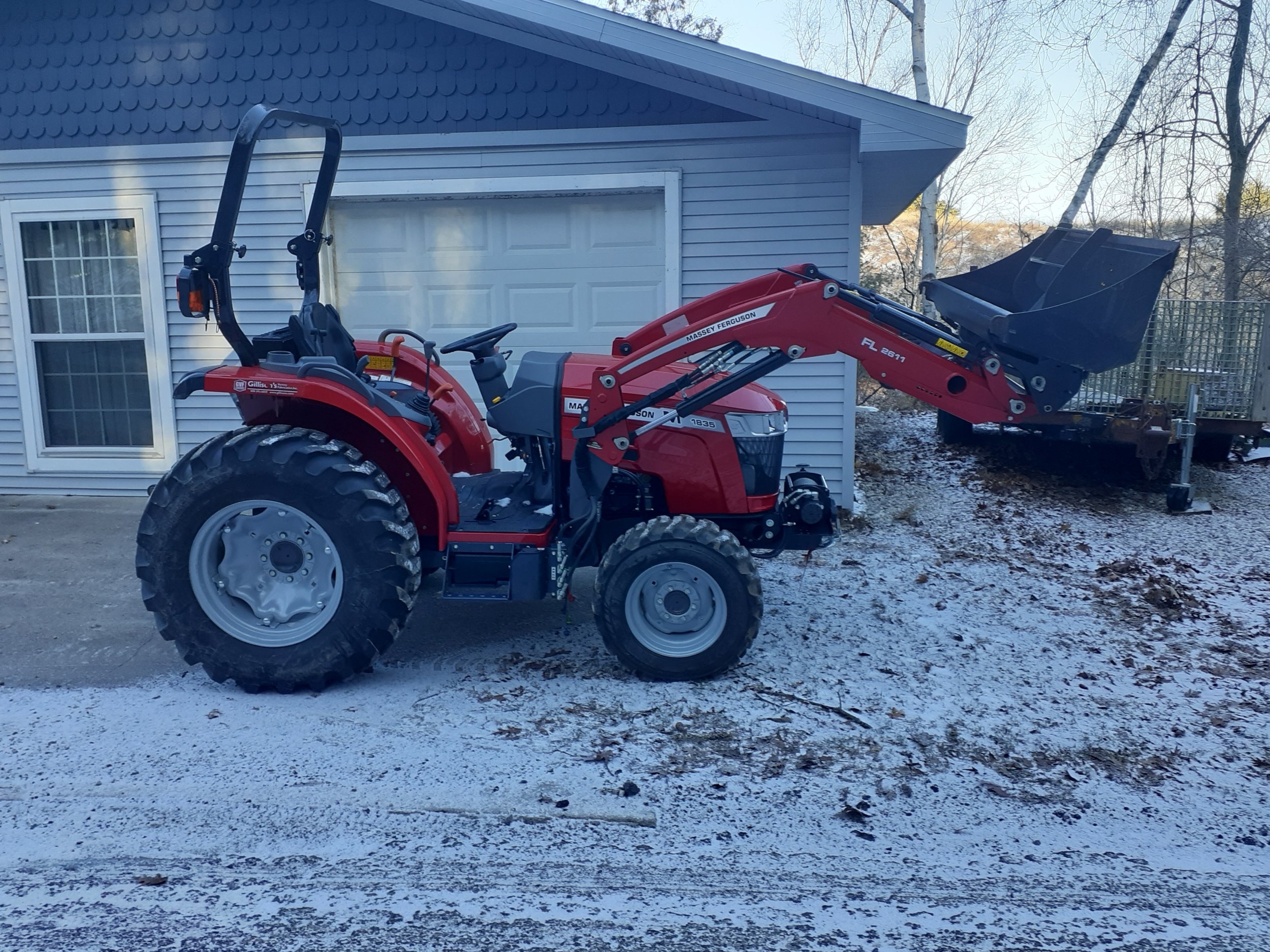

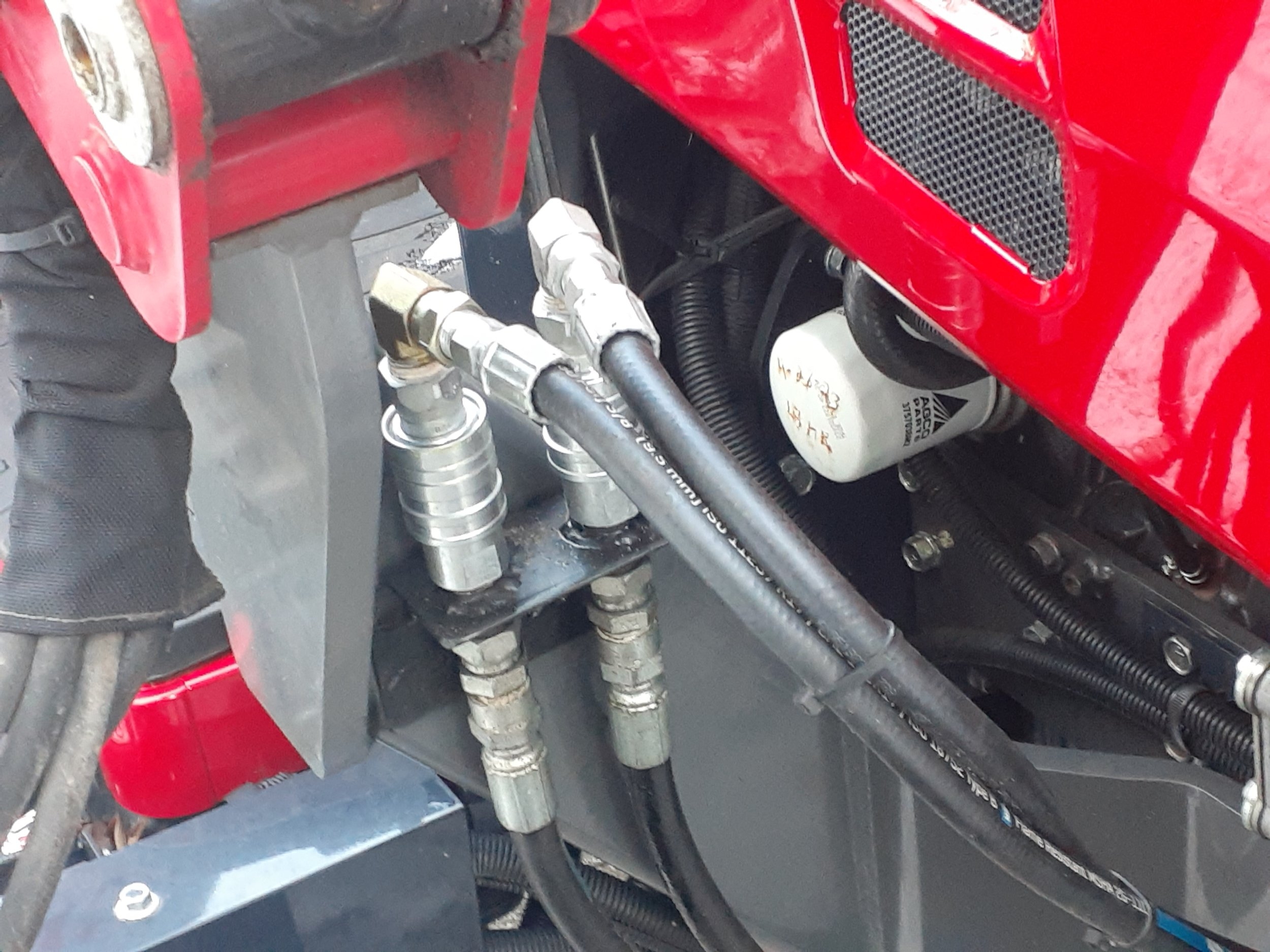

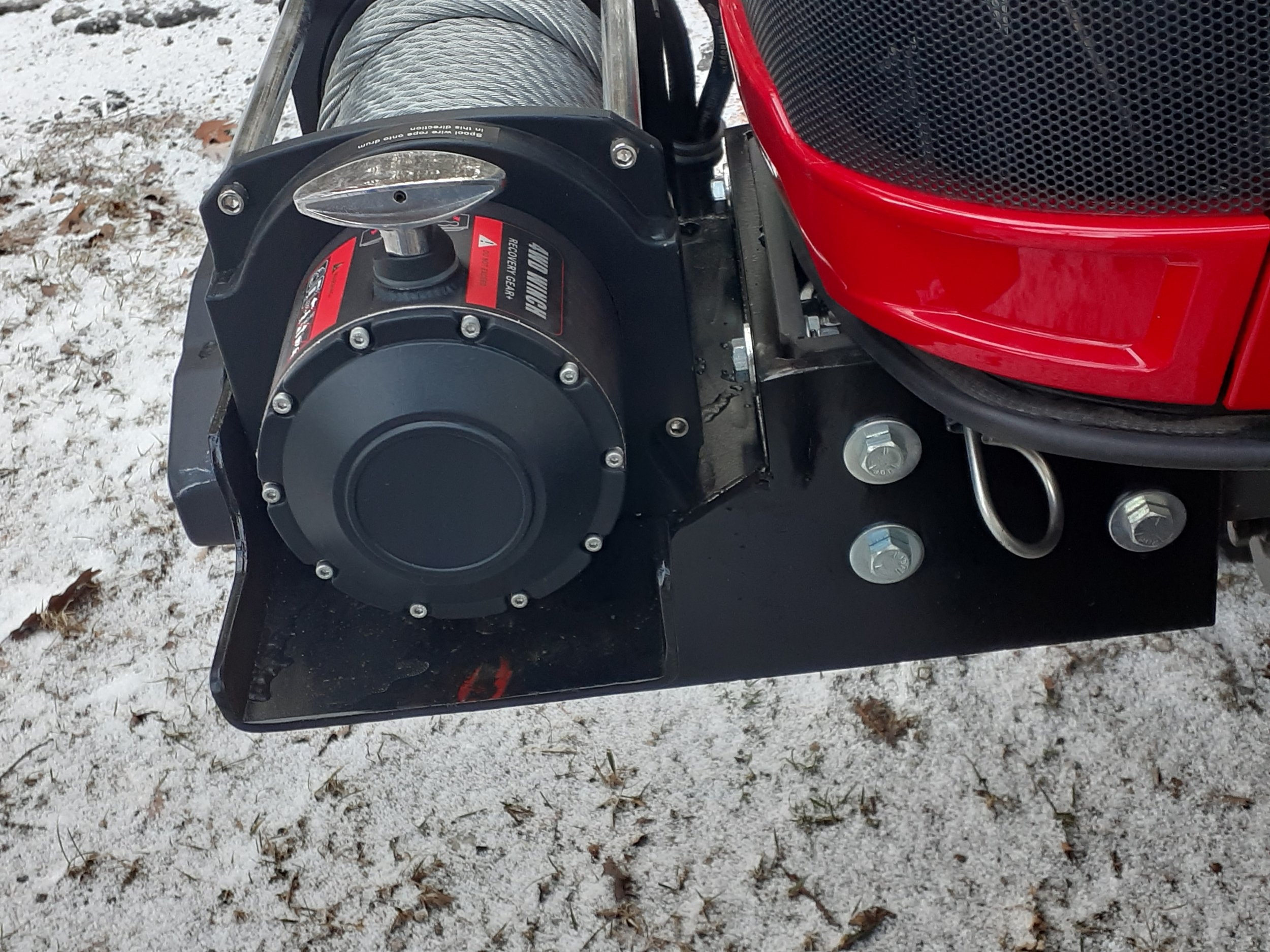

I'd love to see pics of it installed and your hydraulics connection to it.
Here are some pictures I have of the tractor and installation. Hope this helps. The picture with the hoses is where they mounted the hoses with the quick connects so I could easily disconnect the winch and connect the hoses for the grapple.
   / Attaching Winch to Front of Tractor? #57
Is the winch hooked up to a third-function valve?
   / Attaching Winch to Front of Tractor? #59
I added a second remote just for the winch/grapple on the front. I leave the original remote for the bachhoe.
