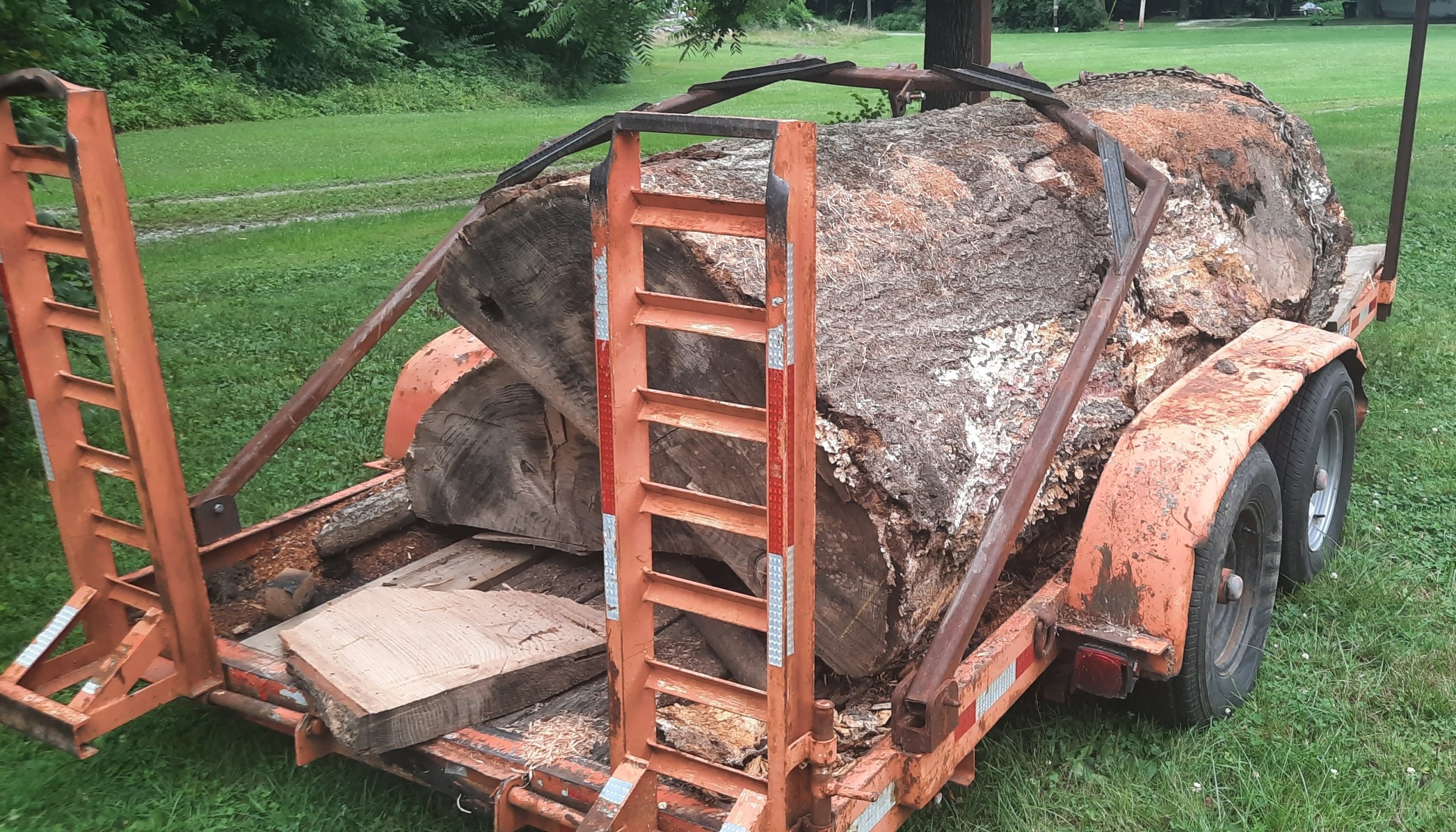

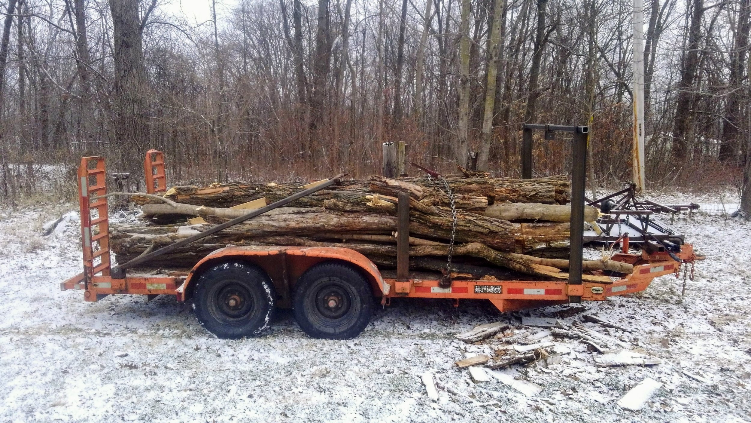

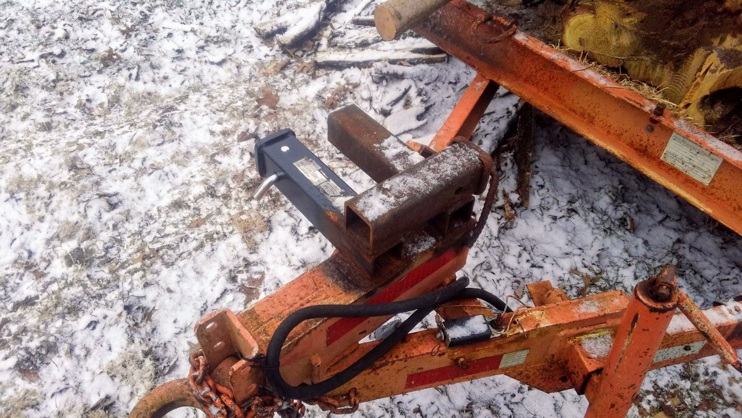

Get yourself a Group 31 marine starting battery, preferably the heaviest one you can get. I use one to run a 13k Xbull winch. I use the winch to drag 16' logs up onto my trailer. I can normally drag about 2 cords worth without totally draining the battery, but I'm also doing lots of 8' to 10' pulls, not supper long pulls. It takes me about 3 hours to get the trailer fully loaded. I don't have the battery connected to any kind of power source when I'm doing this. If you can have it connected to an alternator, that would be even better. I bought Anderson plugs to do that, and was going to use a cheap set of 2 awg jumper cables to route power to the back of my truck. Before going through the work of wiring power to the back of the truck, I decided to do a trial run with just the battery (I took a backup battery as well), and didn't end up needing the spare battery.
I also buried my 1710 in a sand bar and used the winch and battery to pull it out. The frame was in the ground, and I had dug everything the bucket could reach trying to push myself backwards. The winch had to do 100% of the work. I had to make 3 full length (+75') pulls to get the tractor out of the sand bar, and up the hill (backwards - poor traction from the loaded ag tires). The battery held up fine. I do 2 or 3 loads of logs per year, and just replaced the battery this winter. I didn't maintain it very well and let the water get really low, and then forgot to put it on the charger after the last trip last year. Coincidently, I use the same size battery in my 1710, and it was bought at the same time, and I also had to replace it this winter as well. Originally I had them in a '93 F250 diesel. I ran them in that truck for about 2 years before I ended up parking it. The tractor battery needed replaced at the time, so I dropped one in the tractor. I had just bought the winch, so I used the 2nd one to feed that.
Attached are some pics of my trailer and a load of black locust that I brought home, as well as a pick of a pin oak log from a tree that I had to take down in the back yard. I hang a snatch block off the overhead trolley to keep the cable up above the load.
