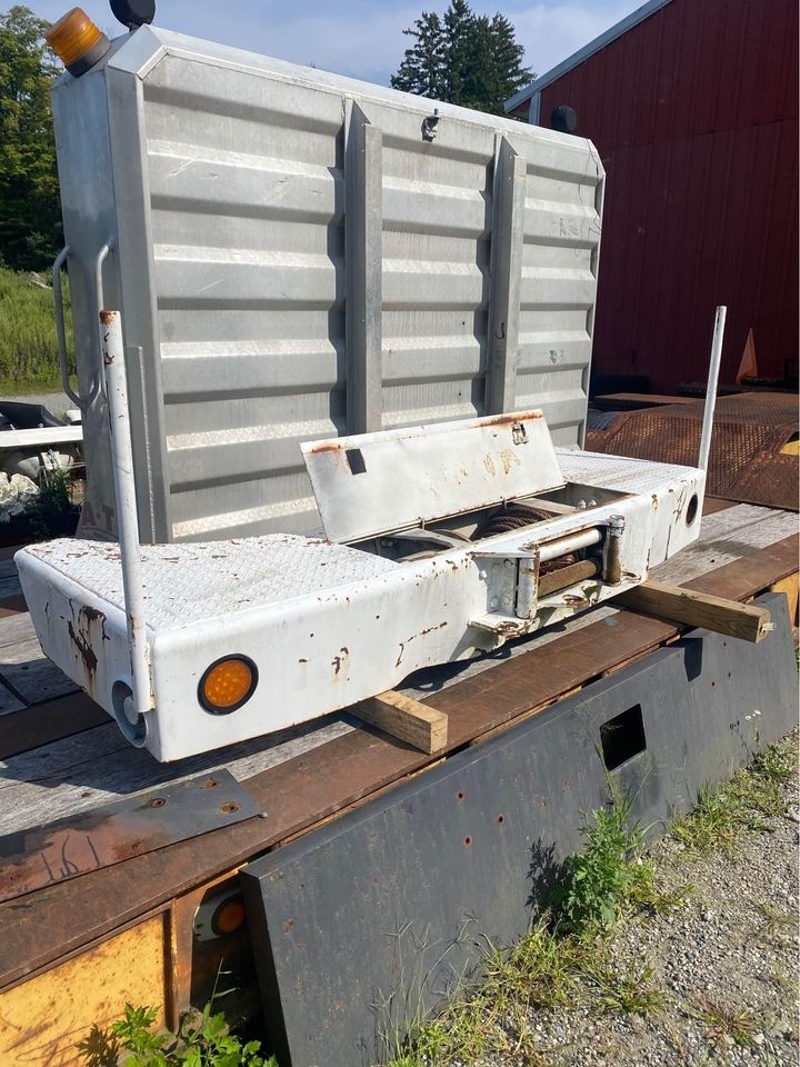

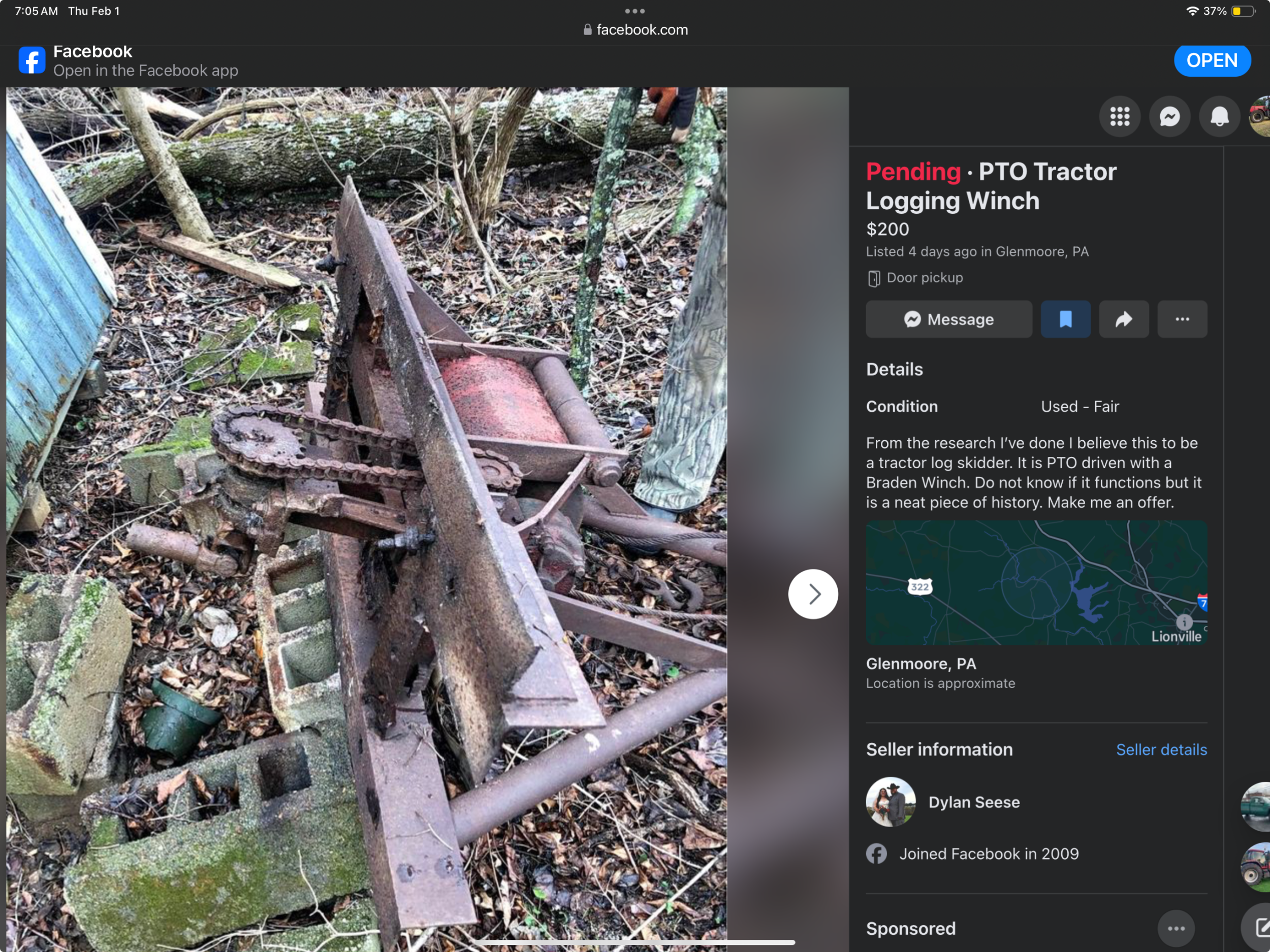

I’m going to be adding a winch for an upcoming project.
Found this little beaut laying in the weeds on FBM.
Looks like I’m a day late.
   / Attaching Winch to Front of Tractor? #13
Send him an email, subject: "I'll give you $210 for the skidder"
He said OBO... I got so much stuff by outbidding by $5 or $10 bucks...

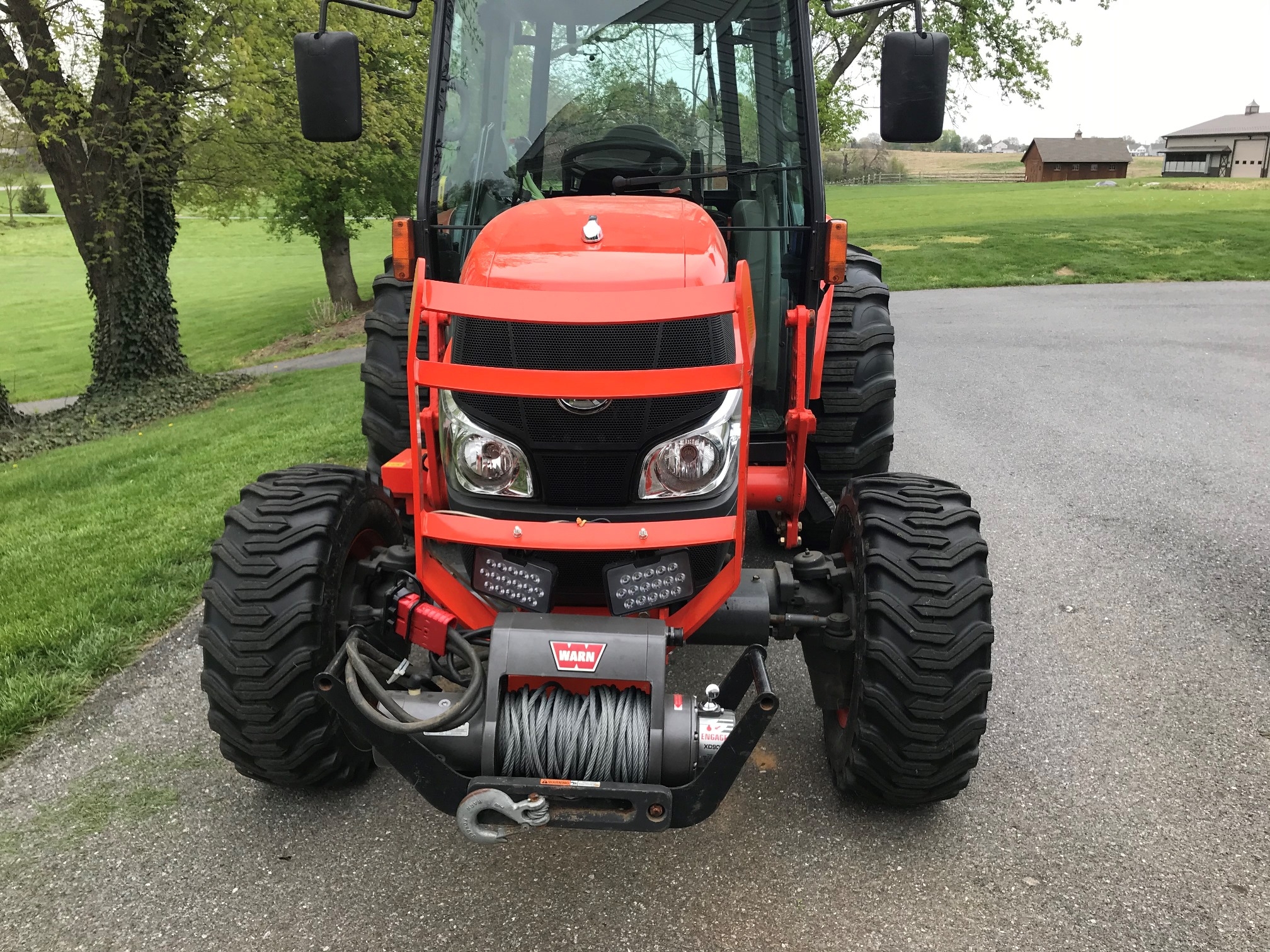

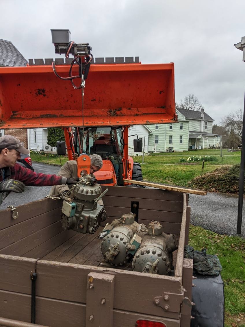

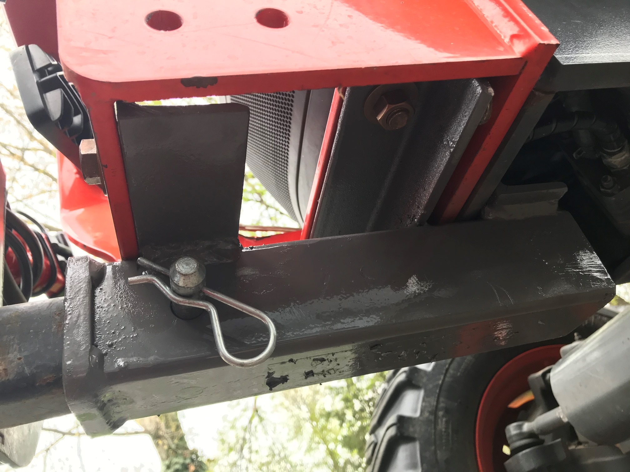

Pretty much what others have said. Add some structure and don't figure on extended use of a 12V winch. My smaller HF 3500# and larger Warn XD9000i Multi-Mount both slide into a 2" receiver. There's a receiver tube on the loader bucket and another on a structure below the grille guard.

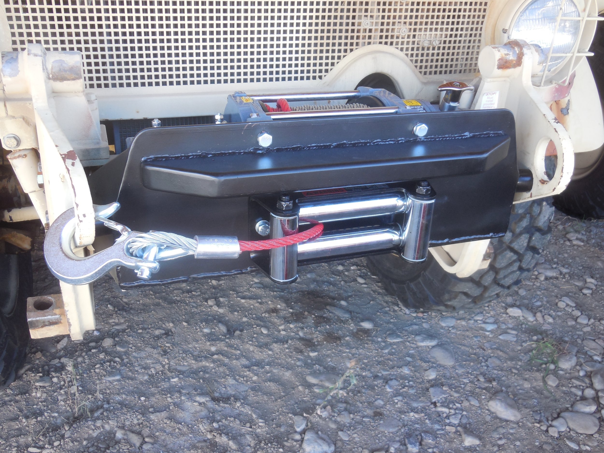

About two years ago I installed an 18K winch on one of the Unimogs, one of maybe two dozen winches I've added to various vehicles, basically to be able to upright a tractor if needed.
That was the most complicated mount to make to date, due to very little space to work with, but being able to pull the skid steer out a couple of times made it well worth it.

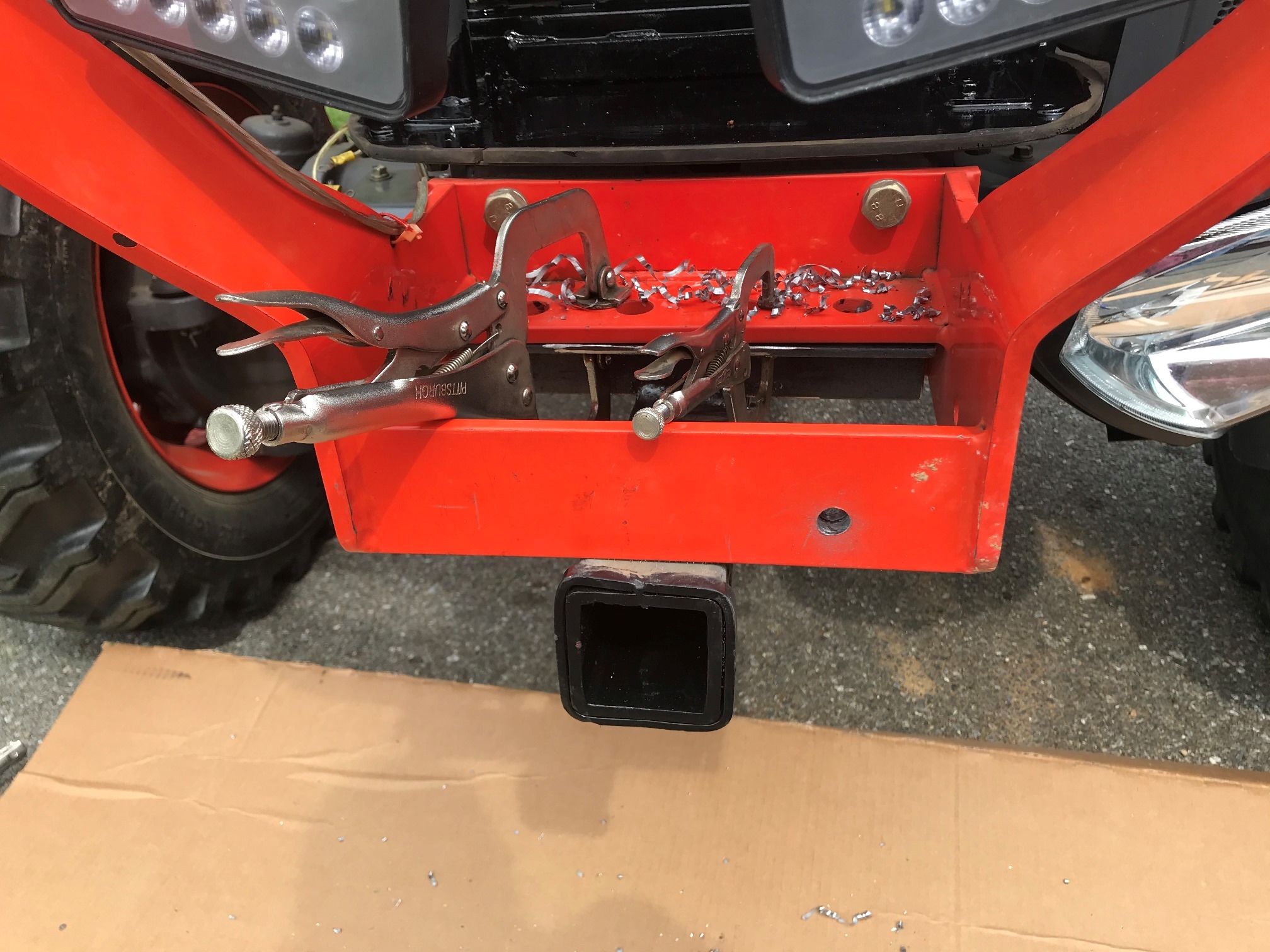

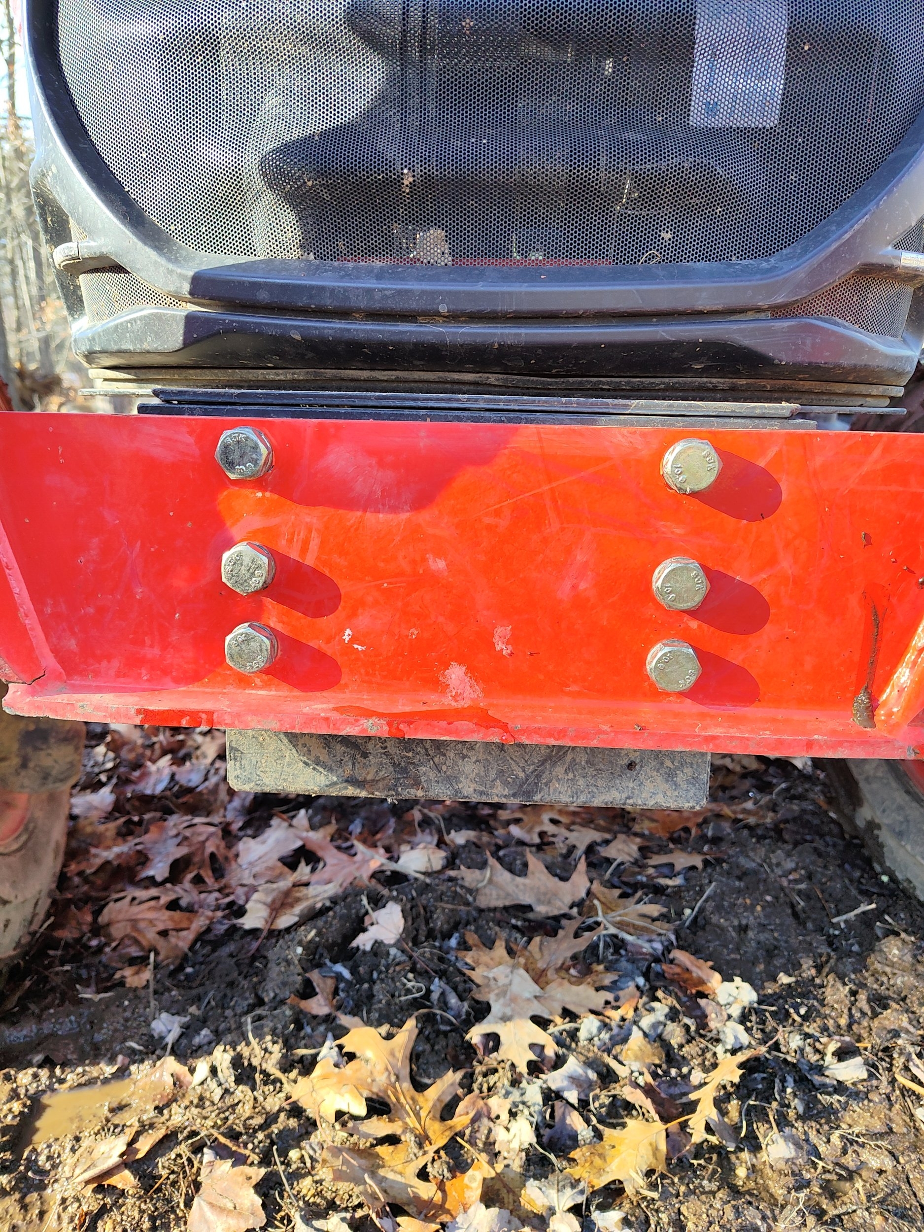

This is probably somewhat of a newb question. I have a Harbor Freight winch and was originally thinking I'd have to attach it to the back with a towing receiver or some configuration like that. Then I noticed the front of my tractor has this plate on the front as shown in the image below. Can a winch mount be attached there? If so what would be the best way to mount?
I've considered similar recently.
Before you go too far on this path though, put the loader down and see how much clearance you have between the back of the lower cross tube and that lower place. Barely any room there on my tractor, though that part sticks out a ways from the front of the tractor on mine.
I suspect for my case I could replace the front plate and put a smaller winch in the space behind it, but I'm not sure if such a smaller winch in a still-useful capacity exists (my tractor is probably usually 6k# - 4k bare weight + loaded rears and loader)...

There's no permanent winch on anything here. Both are made to slip in a receiver and plug into the tractor or Trailblazer when it's time to use them. I've had permanent mounts on several 4X4's since back in the 70's. The only permanently mounted winch on a tractor was the 3500# HF that I've since made into a plug-in.
The to-do list includes finishing a front receiver mount on the Trailblazer so the Warm will plug in either end.
