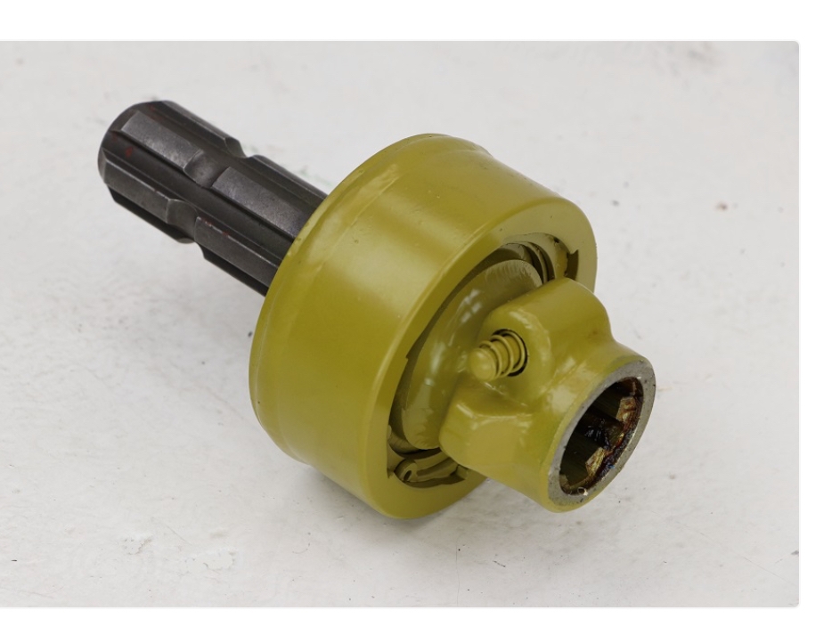

I find the PTO connections with the little "pushbuttons" to be the most difficult. Not because they are any harder to line up, but because the sadists who designed the buttons made them pointed on the end so they hurt your finger when trying to push it. I have to wear gloves to push the button on my Woodland Mills grinder, plus the splines are new and it is very tricky to line up.
That’s funny, I hate the pull-collar types! If I had huge hands, I’d probably prefer the pull collar, but I can never seem to keep the collar pulled and push the stub on with one hand at the same time, and getting two hands thru the linkage and under the stupid shield they put on modern tractors requires a level of balance and contortion only available to teenage gymnasts.
The push-button types at least allow me to get the stub started, then hit the button and slide the thing home. Much easier, at least for my “medium” glove-sized hands.
/ Attaching pto implements #33
The pull collar works the same way: once you get the splines lined up, you can push it on far enough that it will hang there, then give the collar a pull while pushing the shaft past the "breakover point", then you can let it go and slide it on until it clicks. The pulling and pushing at the same time IS an unnatural movement for sure....
