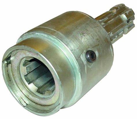

In this PTO safety talk know that implements with a flywheel, like a baler, often roll or bump just a bit and will turn the PTO shaft. Sometimes the flywheel or some part that drives it is near the point where it can "cam over" with very little or no effort.
I once saw a guy working on a 273 NH baler on a slight incline in the field. Tractor and PTO off. He was working near the ultra sharp knives when I came upon him and he had his hand in the path of the knives. One small bump or downhill move at the wrong time and he'll need help tying his shoes. The inertia in that flywheel will move those knives and oopsie...
   / Can you manually turn the pto hookup on the back of the tractor? #42
I marked mine with a paint marker also and it definitely helps to line it up.
The odds of having the tractor running and something going wrong that engages the PTO are slim, but possible. If it happens, the odds of losing fingers, a hand, an arm, or worse are highly likely. Turn the tractor off and hook it up, and be healthy to do it again another day. Or spend the rest of your life wishing that you had.
   / Can you manually turn the pto hookup on the back of the tractor? #43
And that's why I said: "The people around me, know better to not touch any of the controls on the tractor when anyone is handling the PTO shaft."
On my Branson, it wouldn't be an issue. The PTO only turns On after you flip the switch on the dash. So it's either On or Off, no inbetween. Then the lever sits to the left of the seat but also slightly to the rear and a lot lower. Almost impossible to accidentally hit it, you would really have to try.
On the Agria, this is an old tractor and the PTO lever is fairly exposed. I want to make a guard for it that will also serve as handrail. Then again, people around me know not touch any of that stuff when someone is around the PTO.
Regardless, I've been around lathes, milling machines, and other shop tools capable of killing you for a long time, so you learn how to behave around those machines and what you wear/use around those. Longs sleeves are a no no and so are gloves. Exactly the stuff that can pull you and wrap around the shaft. At on point or another, you have to touch the chuck while spinning either to use some emery paper or just chamfer an edge with the file, etc.
For me it's just another layer of separation between me and an accident.

I think it depends on how the pto is engaged. I used to have a john deere with a 2 stage clutch and a lever for the pto. You would have to forcefully jamb that lever into rotating gears to accidentally engage the pto while the engine is running. Not likely to happen when operating on my own.
My current tractor has a cable operated hydraulic clutch which is spring loaded. If the cable were to break the pto could be engaged and there would be greater possibility of injury. Also not likely to happen but more likely than 2 stage clutch. I will from now on try to remember to turn the tractor off when attaching anything to the pto. Thank you for the discussion on this thread!!!
   / Can you manually turn the pto hookup on the back of the tractor? #46
Oooo... it never occurred to me that this is hazardous, but I see it now! Thanks for mentioning it!
I checked in the manual and sure enough they give a serious warning about this:
"WARNING
Entanglement hazard!
Before attaching or detaching equipment or changing the Power Take-Off (PTO) shaft: 1) Apply the parking brake. 2) Move all controls to neutral and PTO control knob to the disengaged position. 3) Stop the engine and remove the key. 4) Wait for the PTO shaft to stop turning before leaving the cab. Failure to comply could result in death or serious injury."
I read the entire manual years ago, but obviously didn't absorb it 100%.
FWIW, on both my old Kubota and my new NH, I've never found the PTO shaft difficult to turn by hand. I think this has been true with the engine running and the engine off (not sure I noticed though).

2007 JD 2520 here - I can spin the rear PTO shaft by hand only when the selector lever is in the FRONT PTO detent.
Edit: Don't know my own machine - I thought the middle detent was neutral, but then a (very dim) light went on in my head. I remembered the weird thing about this tractor is that the middle detent is for BOTH front and rear PTO. I have no idea when you would ever use both the front and rear PTO simultaneously, but anyway, that explains why it has to be in the FRONT detent to be able to turn the rear PTO by hand.
   / Can you manually turn the pto hookup on the back of the tractor? #49
We have a Kioti ck25 HST we always have the tractor off and the pto in neutral! I took tractor Mikes advice and mark the coupling with a paint pen, makes it so much easier to hookup!
Yes! I place the pto drive in neutral and turn the tractor off to attach anything to the pto. Placing the pto in neutral allows for the shaft to spin freely and makes it SO MUCH easier to attach implements.

Three very unlikely things would have to happen at once for my rear PTO to start on it's own with the engine running and no operator on the seat while I am hooking up the rear PTO.
First, the PTO lever would have to be moved from the front position to either mid- or rear position (or, there would have to be some really strange mechanical failure to make this happen internally without moving the lever).
Second, the PTO switch on the dash would either have to be intentionally engaged or there would have to be some kind of short to cause it to engage.
Third, there would have to be a short in the operator seat sensor that would allow the PTO to start without someone in the seat. Yes, you can run the rear PTO without someone in the seat, but the parking brake has to be FULLY engaged. Whether intentional or not, my parking brake has two detents, first detent will hold the machine under most conditions (i.e., just parked on the driveway, etc.), the second detent which is FULLY applied, is what operates the seat safety bypass allowing the rear PTO to operate. I don't think it is actually designed to work this way, probably an adjustment issue, or quirk, but that is how it's always been since new.
I can set the parking brake so the tractor won't move, but it won't be enough to activate the seat sensor bypass, so the engine will die if I engage the PTO. Have to remember to push the brake pedal HARD, then set the park brake.
When I am hooking up the PTO, I always have the parking brake set on the "easy" position, so the PTO can't start.
Due to the extreme unlikelihood of all of these conditions happening at once, I have decided that it is OK to hook up my rear PTO with the engine running.
But I wouldn't recommend it for anyone else.
