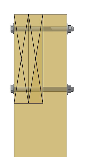

Im building a garage using a post and beam foundation.
I have railway ties for my posts and I plan to laminate three 2 x 8's for the beams. Question is how should I attach them to the posts. Ive seen adjustable post bases that will work like these View attachment 378621 but they are $16 each!
Also regular 6x6 post hardware is too big for the 4.5inch width of the laminated beam.
Any advice here or am I left to pay more for the attachment hardware than the beams will cost?
You could attach these beams to your posts like beams are attached to 6x6 posts on decks. Cut 4.5 inches out of one end of the post creating a "L" and then set the 2x8's on the ledge that's created. Then bolt them to the RR Tie with 5/8" or 3/4" bolts that are long enough to go all the way through the 2x8's and RR Tie.
Something like this.

By way of an update, I did eventually complete the ground work for this project and I'm getting ready for Rafters this week. Decided to take the advice of the folks here and pour concrete tube posts. Around here frost is pretty deep so I dug them in 4 feet. I poured the bottom half directly in the ground for lateral stability and used a sonotube form for the top half to finish the look. Came out real nice and will no doubt be a more sturdy structure.
The thing that surprised me was the ease with which the rr tie posts that I had already put in place and compacted around came out with the tractor. Even though I thought I had spent considerable time and effort in compacting the fill around them they were easily pushed over and lifted out. After seeing that Im happy I went with the poured concrete.
