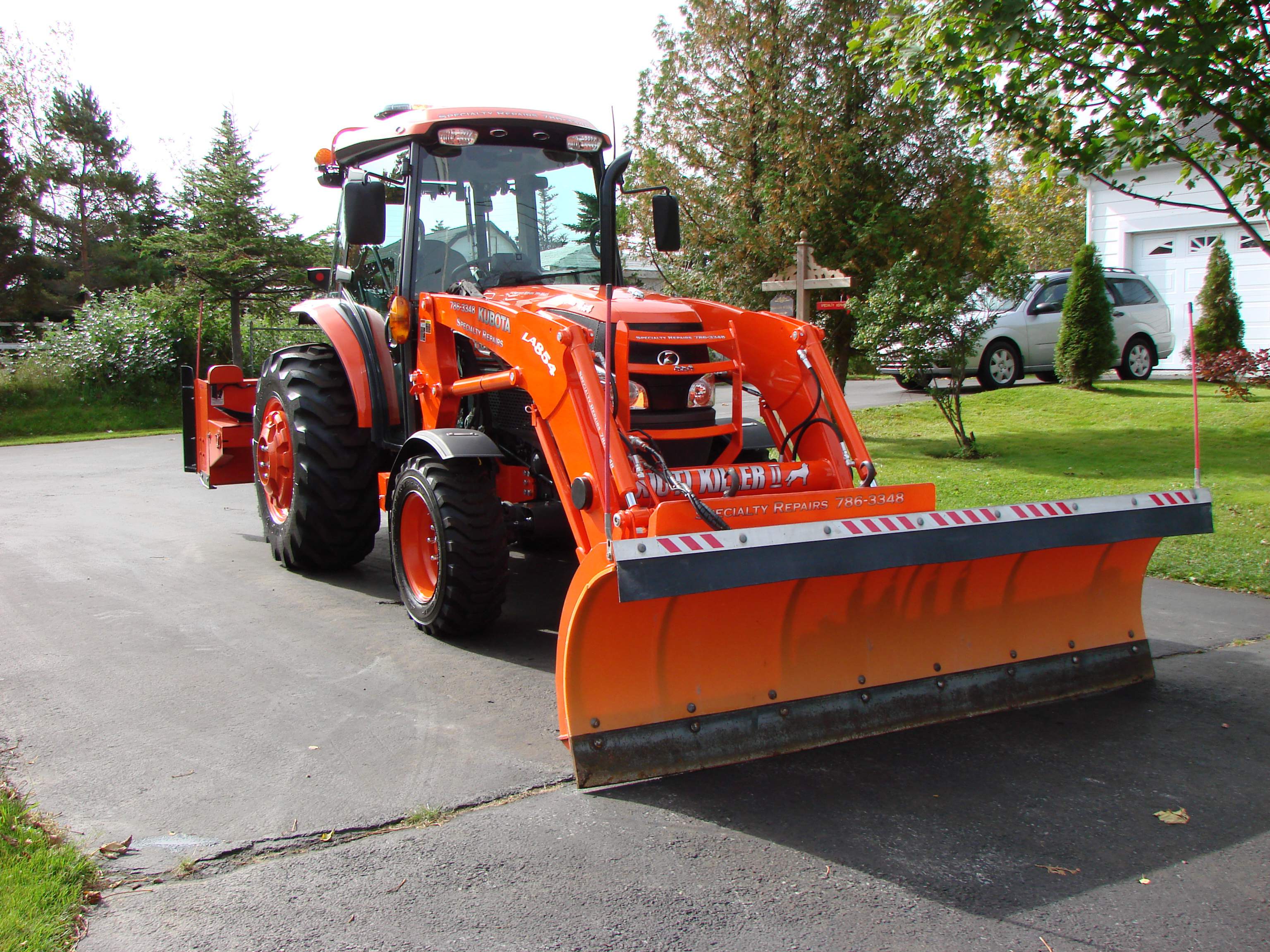

Our TBN member (RFB) asked me to show him the poly skin I have on my blade so rather than post it on someone else s thread I'll post it here.
This is a poly plow I had on my old pick up that I later modified to fit my Kubota 4240 and now my Kubota 5740. The poly skin can be purchased at a Arctic Plow dealer and you'll have to cut the steel skin off your blade and adapt the blade frame to accept the poly skin. The skin's thickness is 3/8th thick and snow will never stick to it so that's why I like it so much. We get a good bit of wet snow over here and this blade takes care of that.
I also added a kick back shock to the blade as well because there were times the blade would recoil and flick snow and ice back towards the windshield. The shock took care of that issue. The blade comes back nice and easy now making it much safer.
I also added rear skids to the "A" frame to prevent the rear of the blade from digging into the pavement. Here's is a link to the original thread.
http://www.tractorbynet.com/forums/customization/131136-snow-plow-adapted-fel.html
Lower rear skids
Front skin
Front shock

I'd say it's an easy install. I can measure mine tomorrow and see if it would fit yours. You'd just need to drill a few 1/2 holes and use carriage bolts to mount it to your steel skin.

Gee I just realize my blade is out rapped up for the summer BUT I did get to measure the thickness of the poly and it's 3/8th thick and it's 24" high. I believe they are pre-formed. When I removed it, it kept it's shape. It's not tucked under the cutting edge but sits just above it and is attached by carriage bolts on the bottom and the top. This skin has plowed snow commercially since 1994. The poly is natural orange and never painted. If you contacted an Arctic Plow dealer they could give you a price on the poly skin.

4shorts, what you have is an actual poly plow. And the poly is 3/8" thick for strength. And no, teflon wont work in that application.
What I posted, and I think RFB was asking about, (and probabally what the guys you mention use the teflon for) is a "liner". They are pretty thin. They are designed to go OVER the steel. Mearly just a "coating" over the steel so the snow dont stick. But dont have to provide any support or have to be strong like your 3/8" blade. Because yours dont have a layer of steel behind it.
And the liners that I am talking about are flexible. With them pinched under the cutting edge, formed to the plow and then bolted at the top, there is no where for them to move. They will hold their shape just fine.
