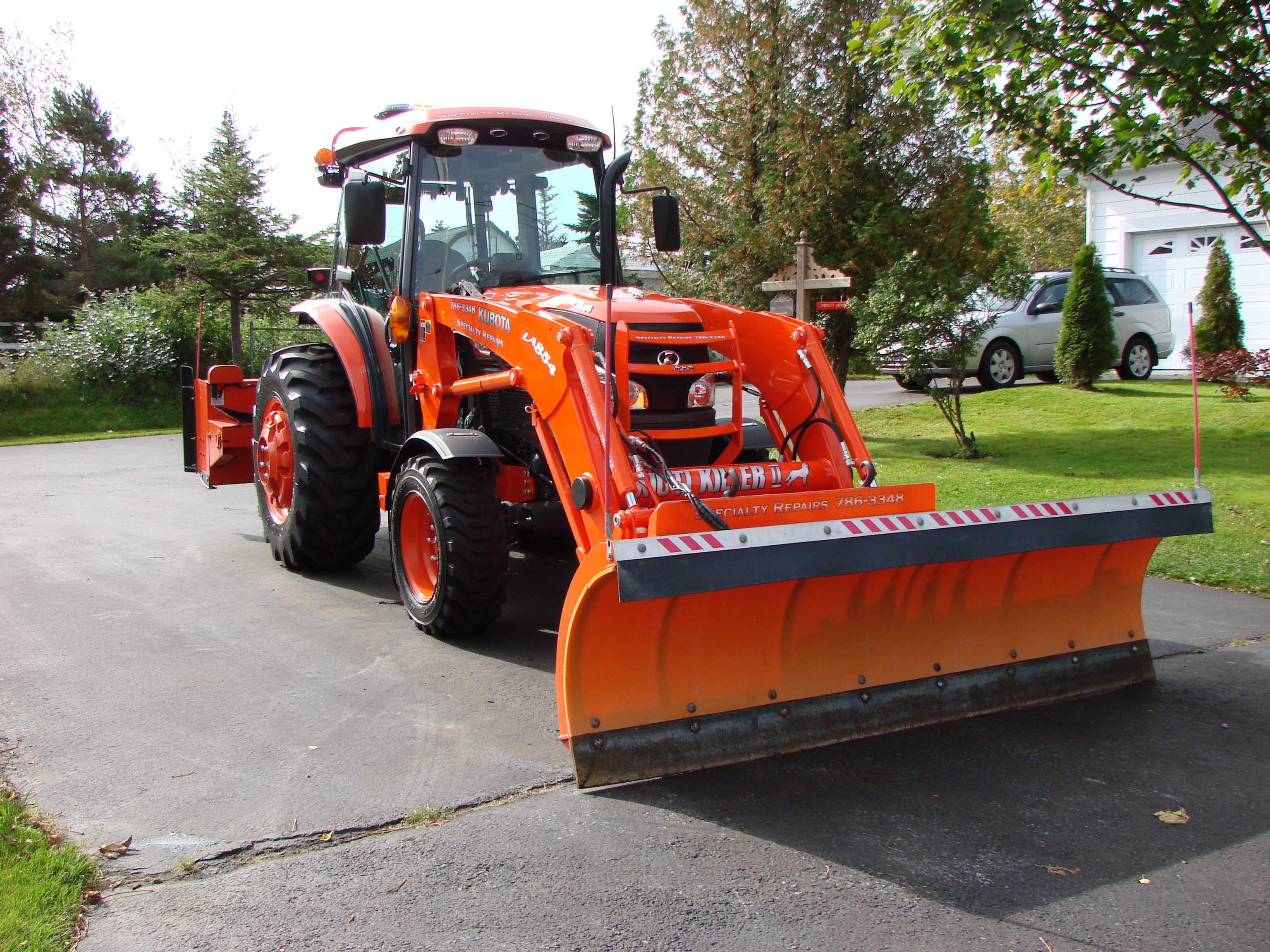

Gee I just realize my blade is out rapped up for the summer BUT I did get to measure the thickness of the poly and it's 3/8th thick and it's 24" high. I believe they are pre-formed. When I removed it, it kept it's shape. It's not tucked under the cutting edge but sits just above it and is attached by carriage bolts on the bottom and the top. This skin has plowed snow commercially since 1994. The poly is natural orange and never painted. If you contacted an Arctic Plow dealer they could give you a price on the poly skin.

Here's a better photo of the blade.

4shorts, what you have is an actual poly plow. And the poly is 3/8" thick for strength. And no, teflon wont work in that application.
What I posted, and I think RFB was asking about, (and probabally what the guys you mention use the teflon for) is a "liner". They are pretty thin. They are designed to go OVER the steel. Mearly just a "coating" over the steel so the snow dont stick. But dont have to provide any support or have to be strong like your 3/8" blade. Because yours dont have a layer of steel behind it.
And the liners that I am talking about are flexible. With them pinched under the cutting edge, formed to the plow and then bolted at the top, there is no where for them to move. They will hold their shape just fine.

I realize my skin is a poly skin. I paid $4500. for the system back in 1994. I've got a sheet of 1/2 Teflon here now that you wont tuck under a cutting edge :laughing: I also have it in 4" diameter so that I can machine it. It's all over the place here LOL but I fully understand what your saying. By the way. These poly Arctic blade weigh more than their steel blades. It's due to the extra ribbing added to them. Built like a battleship.
