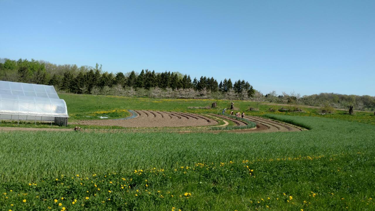

Thanks for your interest. I don't have a picture thread of my operation. I suppose starting one would be a good idea. I have enjoyed the pictures you and other farming members put up. What do you think, should I do a random retrospective now, or do one the 2017 season as it unfolds?
Here's one shot that shows our general production area:
You can see the curve in the field. The block closest to us is in cover crop. We do three years of veggie production and two years of cover crop in a five year rotation.
We grow veggies for the wholesale market on about an acre and a half. We also have a 30x96 and a 14x88 high tunnel, which you can see in the picture. It's a small scale operation on a curved hill side, which is challenging, but we keep our costs low and have a very loyal customer base. My dad started this operation in 1975, so we have a good relationship with several buyers. My wife and I both do a little side work, but the farm is our main income source.
It's a lot of work, but it's fun too. We will do our first seeding in the greenhouse in less than a month. We'll pick our first planting of spinach in mid April, and we sell carrots, leeks, tomatoes and peppers into December. We grow about 25 different crops and do about 100 total plantings.
Looking through my phone, I realize that my wife is the primary farm photographer (my pictures seem to be of tractors, chainsaws, cars, and firewood). I think there's a pretty good selection on our Facebook page, though. We're under Rising Sun Farm (not the one that raises Bengal cats).
