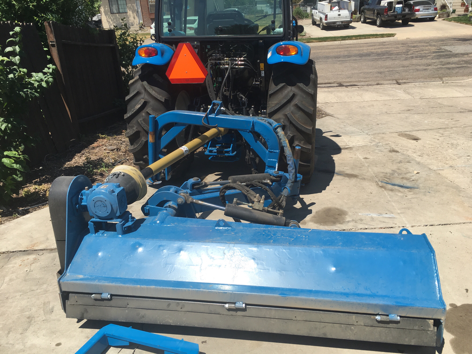

I have the Maschio Giraffetta 160SE Flail Mower. Iowa Farm Equipment was great to work with in choosing the unit I got. Mowers: 3-Point, Pull-Type, Skid Steer, Rotary, Flail & Zero Turn -- Iowa Farm Equipment They offer a good selection of brands and types.
For a swing arm mower like I have one critical dimension is the offset to the pivot point at the head. The pivot point must be outside of your rear tire or mowing ditch banks can become difficult as you would need to have the rear tire close for the mower to pivot down. mowers with the outboard gear box tend to have a better reach. I have no problem running my mower with the 26.5 PTO HP I have. I think it is rated for 35 min HP.
