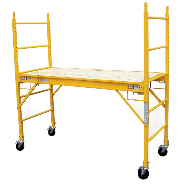

Is the same one I can order from Wal-Mart, just $40 more expensive. Ordering two I can stack them. And since there are 6x6 treated posts set in 3ft concrete, strapping to them it would be extremely sturdy.

Got me thinking about scaffolding. I can order this online, even Wal-Mart, $143. 6ft but easy to add another section so 12ft.
1000# rating. Anyone use that particular one. Northern Tool sells it also. When not in use it could be shelf storage.View attachment 608589
I rented one like that once, it worked pretty well. No complaints from me.

The Menards:
IMS 6' Steel Rolling Utility Scaffold
Sku # 5602002
This works well for changing light bulbs and working on the door lifts and heating units. IMG_4868.JPGIMG_4869.JPGIMG_4871.JPGIMG_4872.JPG

Thanks so much for all the replies. I ordered two sets of scaffolding yesterday. Remove casters from one and it can be stacked on top of other for higher up. When not in use they can be rolling shelves.
I can also strap them to posts and rafters also to be more stable.

I have 2 sets of that yellow scaffolding pictured in post 70. It works great for interior use one set high. It’s pretty wobbly going 2 sets high. I wouldn’t use it 3 or more high. Given the option between a forklift and that I’d pick the forklift any day. I did find that putting a ratchet strap across it helps with the slop and makes it a lot more stable. I also have the optional outriggers for mine. They made me feel better but they didn’t seem to make much difference.

My scaffolding is not the yellow stuff. I've got the 5x5 end panels and aluminum 7' walkboards, the heavy duty construction stuff. I can go 10' before it gets wobbly. When I have to go over 10' I put a brace on it which is a 20' pipe that I've welded a flat bar with a bolt hole in it at each end and I bolt it to the scaffold at the 10' point and the other end anchored to the ground. Then I can go up another 10' to 13'. Any more than that and I hire someone to do it.
I got the NT one. I attached some rectangular tube to the walkboard runners and lift with tractor. Mine came with the safety rails. Works but takes 2 people.
