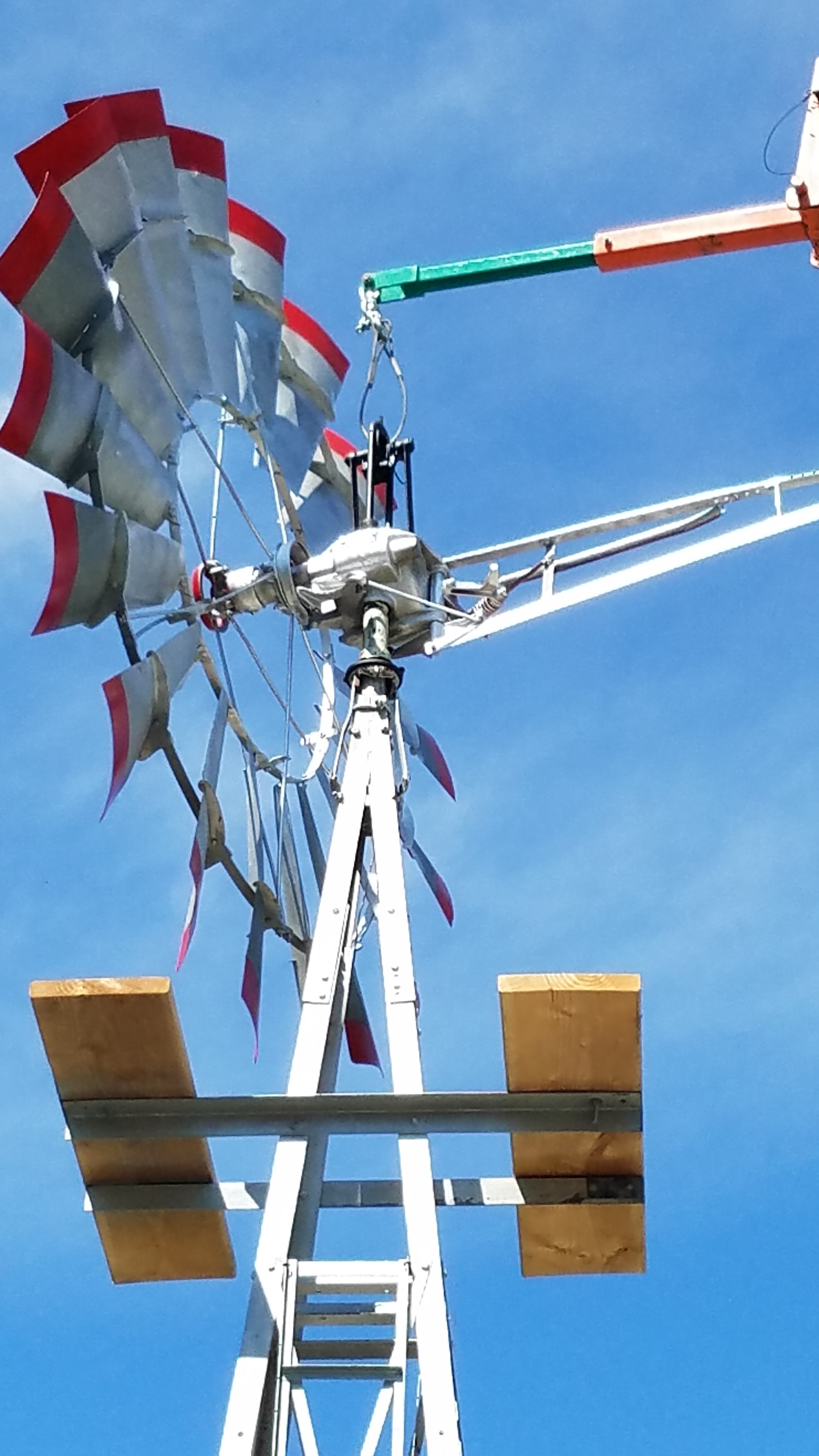

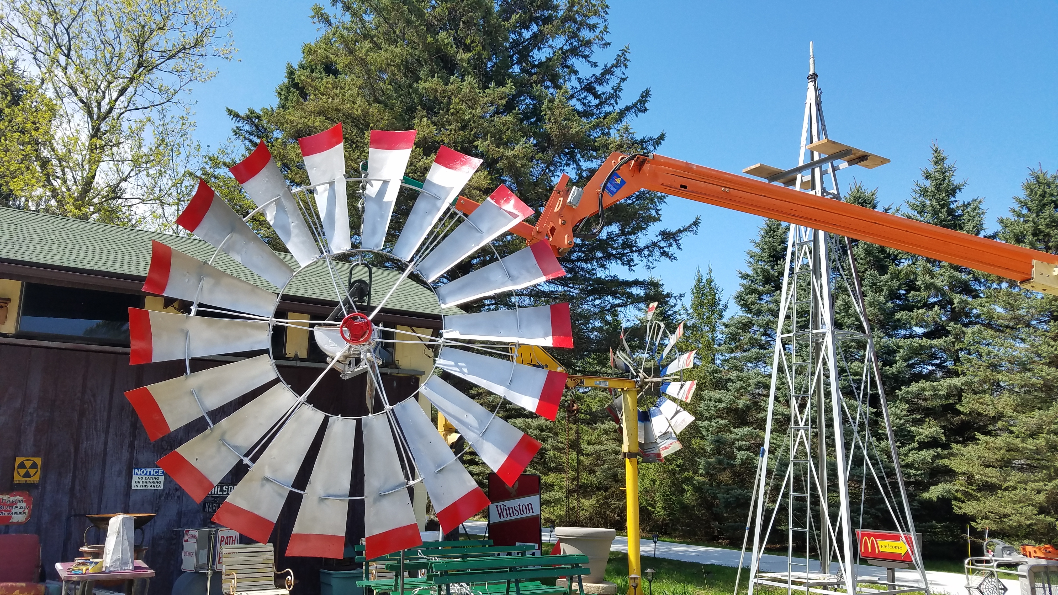

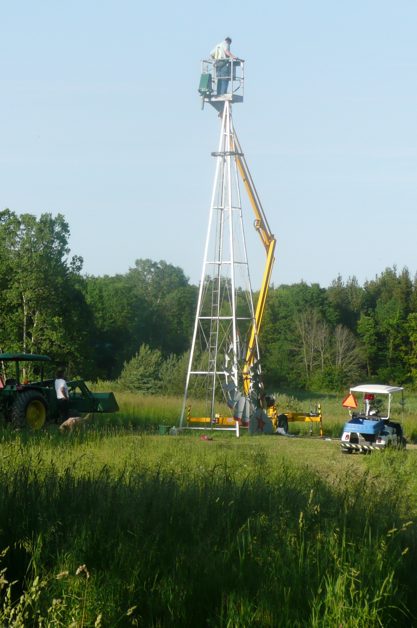

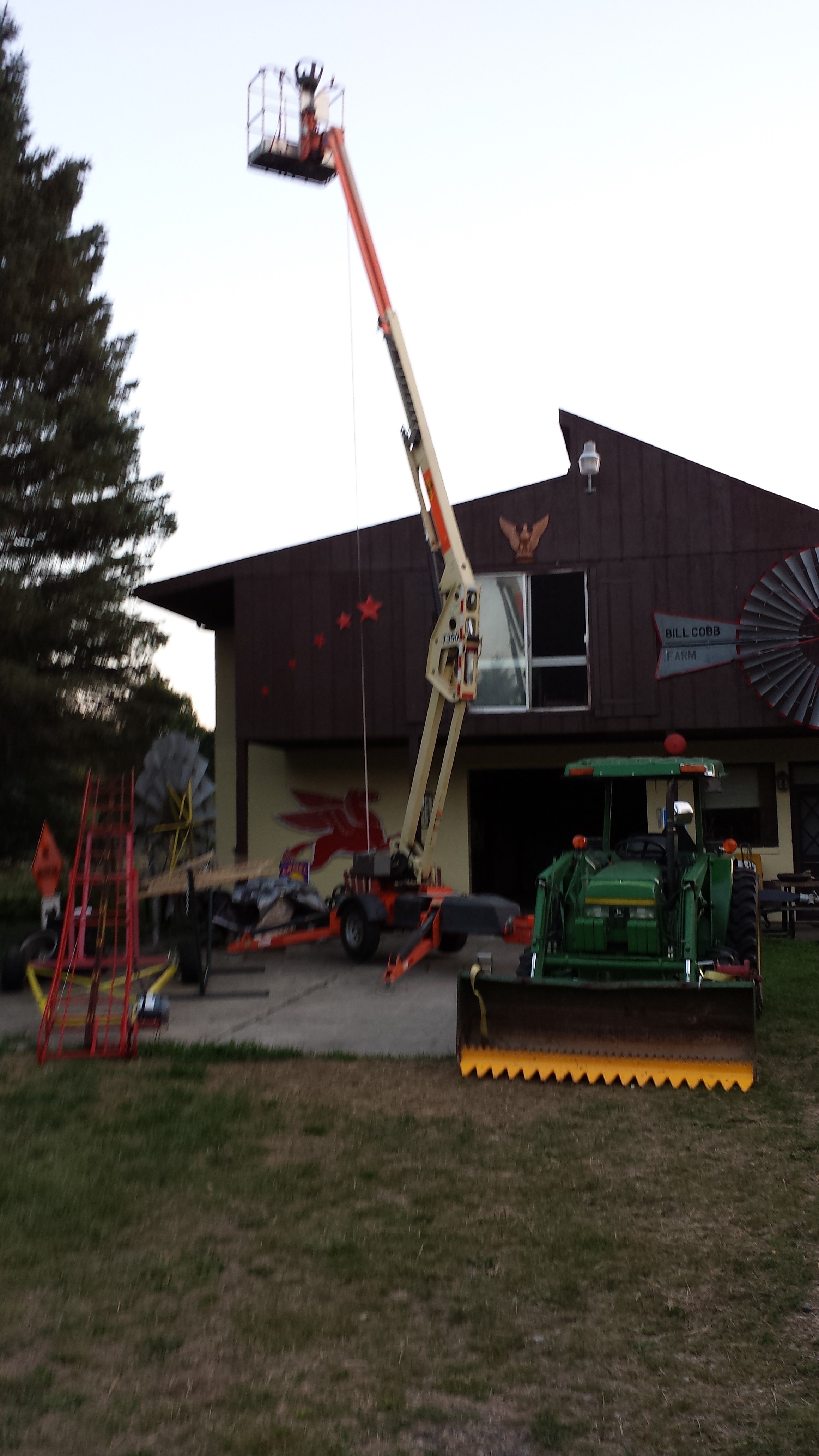

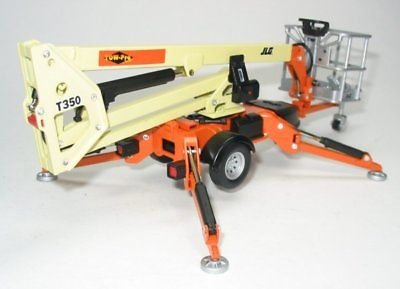

I bought a used JLG T-350 man-lift after renting 3 different brands, models & types. Settled on a battery powered 35' reach. Actually needed it for installing and servicing my farm windmill collection. Battery because no motor noise allows easy communication with ground helpers.
So renting one for occasional use would be my first recommendation. They make/rent 50' reach models, too.
But, it might surprise you that there turned out to be be a lot more uses than I imagined: trimming trees, painting the barns, fixing the roofing, Christmas tree lights, changing light bulbs on my tall outside light towers, fixing the flag on my flag pole, and helping neighbors wth the same issues. I made a jib crane attachment for it (the man-cage can be removed and there is a ground control feature for doing this really smooth).
Features to consider if buying one: Mine has air lines, electrical, & 12V outlets available on the mast. It has auto-leveling: you push a button and the outriggers are adjusted automatically to level the turret. It also has some safety features related to overloading the rig: It will stop you from getting close to unloading an outrigger.
