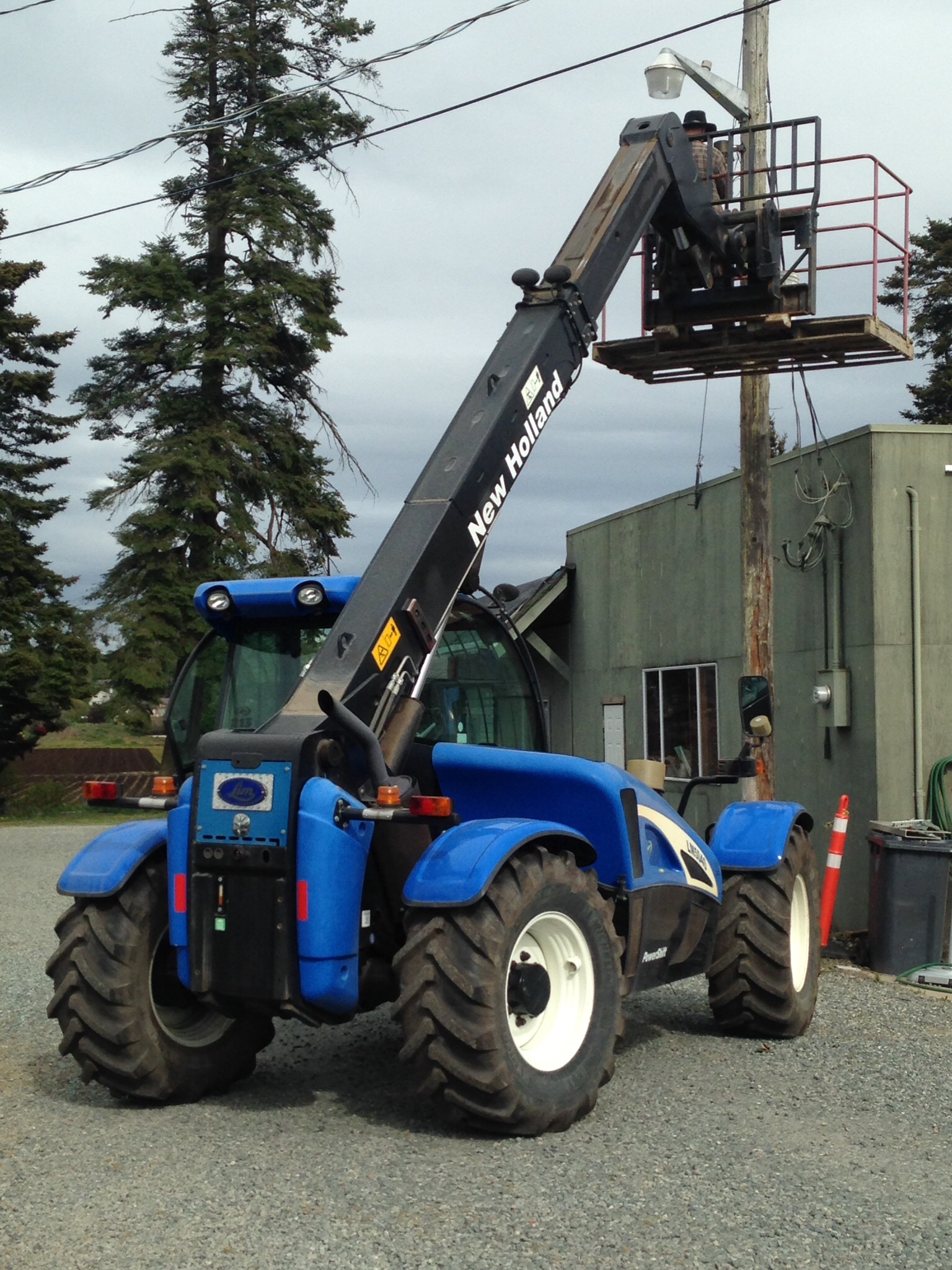

In a few weeks I need to install a large fan in a cupola.
My tractor FEL works great me getting in bucket cutting high limbs or extension ladder in it.
I raise it where I want, easy to climb up and in. This cupola project is 15 ft. up. Floor is concrete (level). With backhoe on that gives lots of rear weight plus I can use stabilizers.
Has anyone fabricated a working lift for bucket? I could simply strap a 4x8 sheet of plywood to it. Any ideas appreciated.
I'll have quite a bit of measuring, cutting, bolting things, wiring to do.

Sorry to be contrary but I would rent some construction scaffolding...

I would use an IBC tote cage at minimum. I would also chain the bucket or forks (so it can't dump you out) and clamp a piece of angle to the loader lift cylinder (so that it can't drop).

You can rent a trailer mounted boom-lift pretty cheap. I like them so much that I bought one. 15' is not that high. Can you mount a standard 3pt boom pole to the loader bucket to get the fan up there and then configure the fan from a ladder ?
