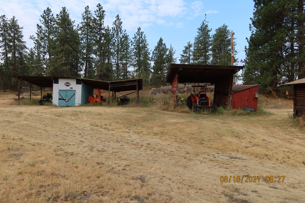

I don’t like leaving implements outside if I can help it. My too small tractor shed is full of tractor. I am envisioning a low slant roof on the outside that I can just drive up to. Any suggestions would be welcome!

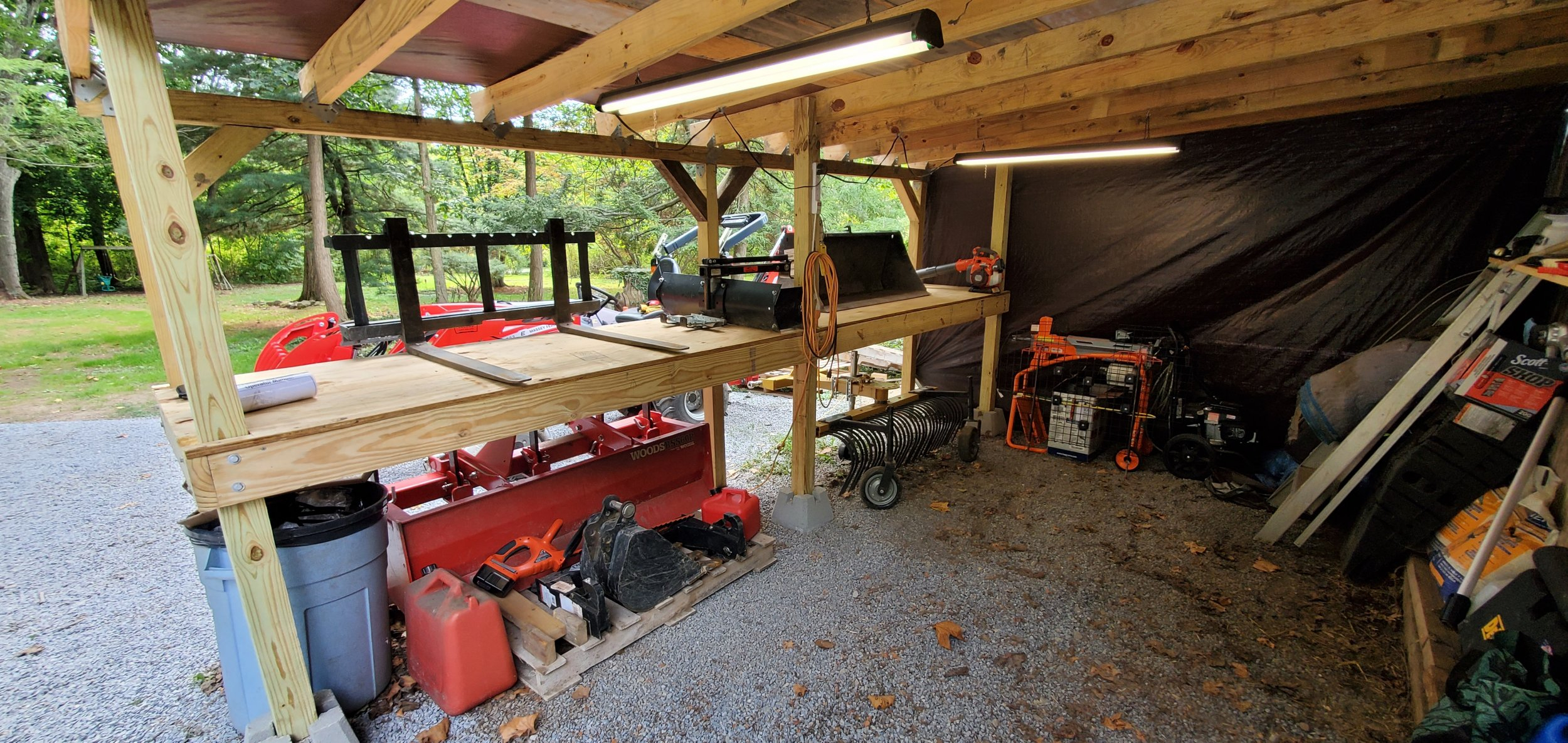

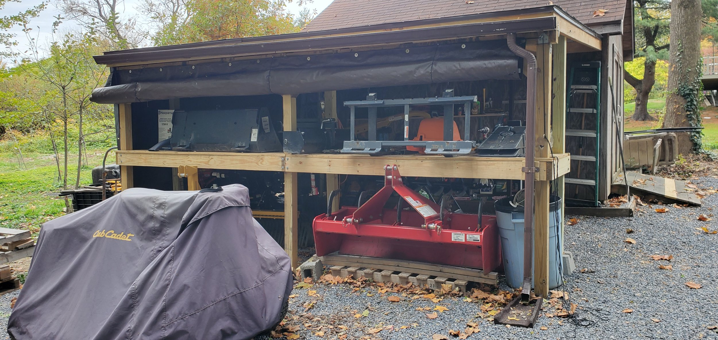

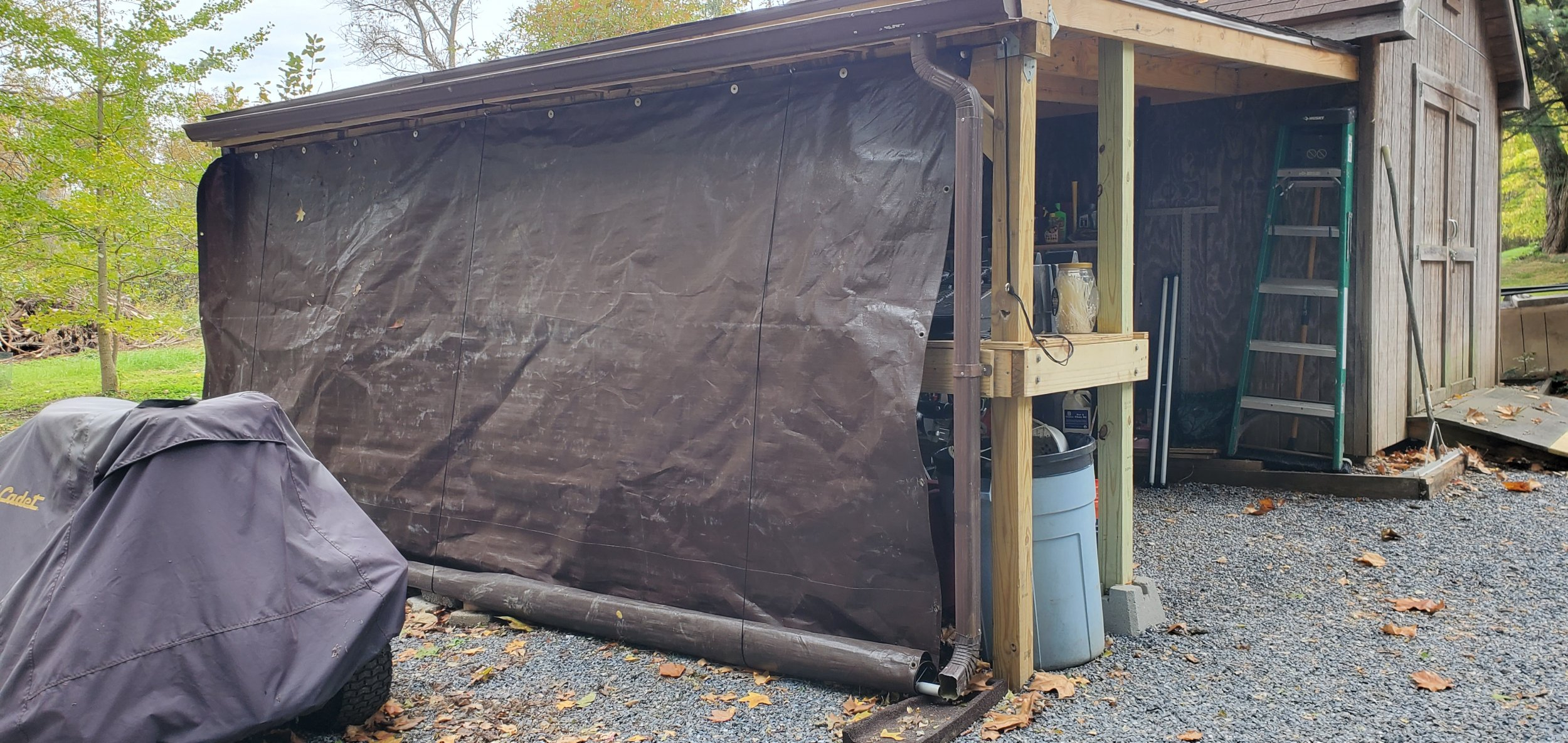

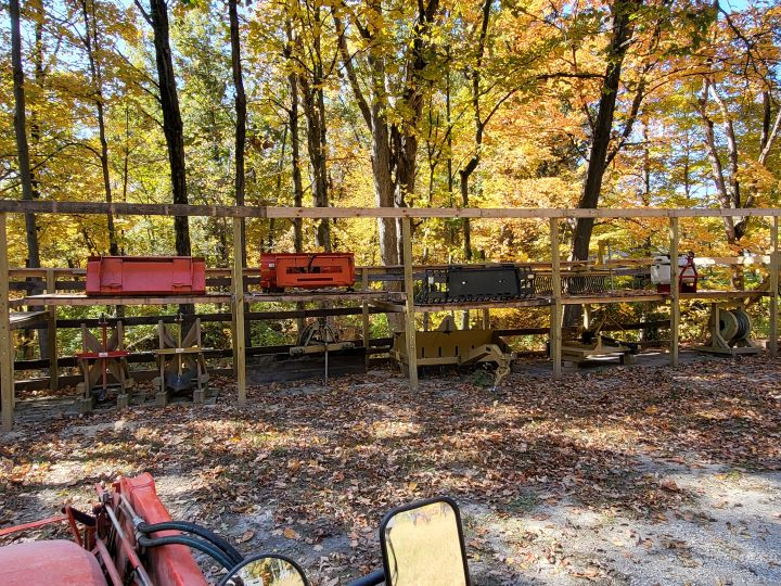

I added a 12 x 16 lean to attached to one of my sheds and then added some shelves to hold attachments. I also added a roll up tarp to keep the weather off the implements.
/ Anyone built a 3 point implement shed? #6
I added a 12 x 16 lean to attached to one of my sheds and then added some shelves to hold attachments. I also added a roll up tarp to keep the weather off the implements. View attachment 767990View attachment 767991View attachment 767992

PJRAM, That is perfect. Never occurred to me to put my quick attach forks etc on the second level. The roll up tarp curtain is a nice touch too. I knew this was the right place to ask. Thank you!
/ Anyone built a 3 point implement shed? #8

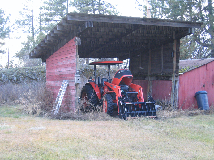

Plan to add roof and sides to "Kubota Toybox" next year

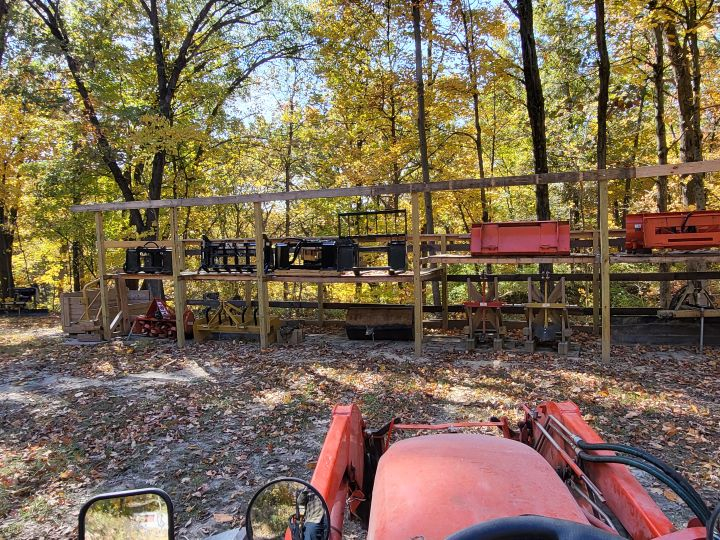

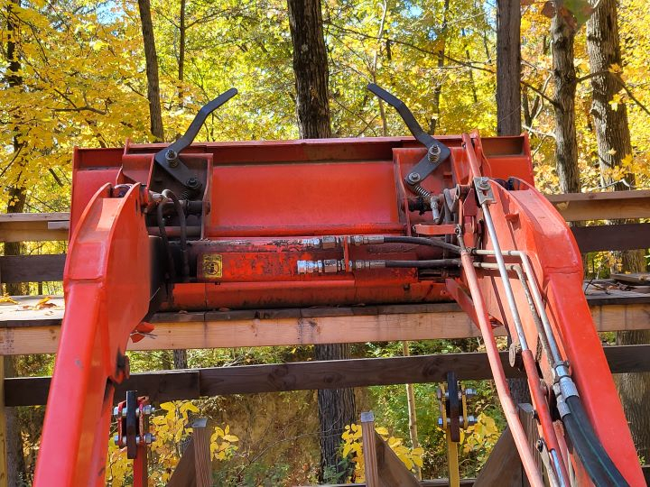

Elevated shelves for SSQA attachments are awesome
