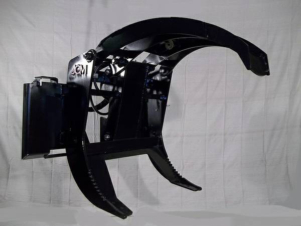

Anybody use t his grapple?

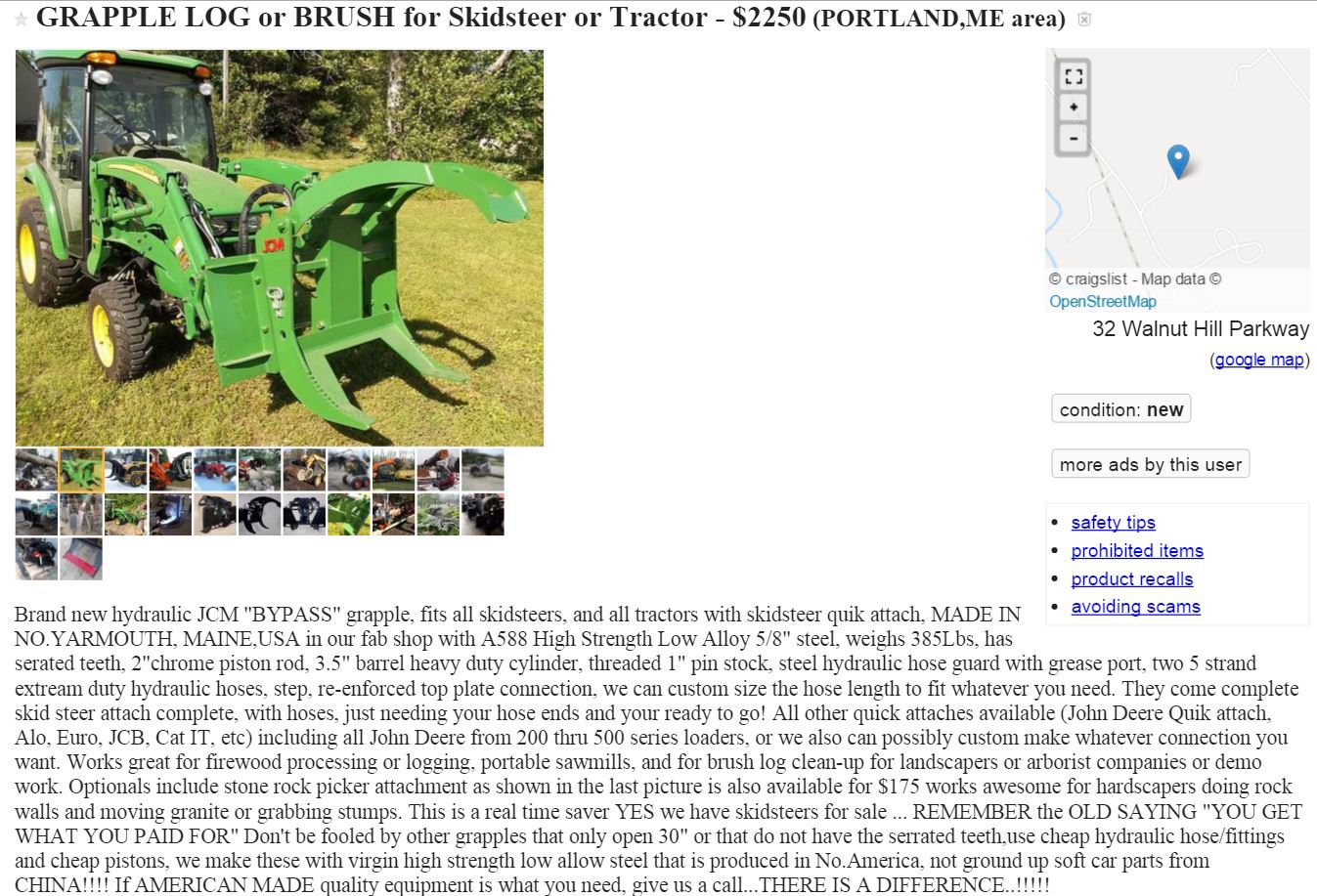

That is really a specialty grapple for moving logs. It seems ideal for that purpose but it wouldn't be very effective with brush or digging roots/stumps etc. If all you do is move logs, it seems like a fine choice. Other grapples will also move logs however and are more versatile.

"Any grapple is better than no grapple" :)
Neither of my grapples will clamp down as small as this one, but I haven't needed that function.
For the future after the ad is gone, this it what it is:
