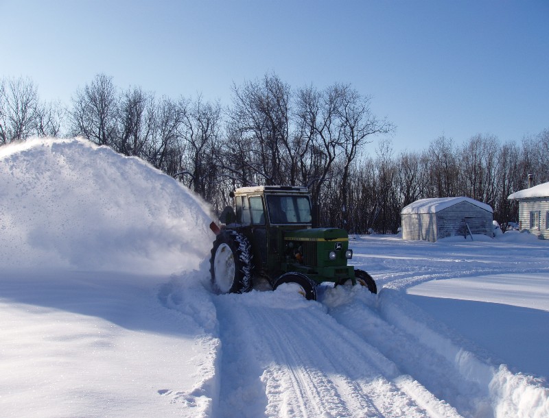

My dad still uses one and claims it's no different to our newer ones really . Just if it'ds deep a 2wd is useless .

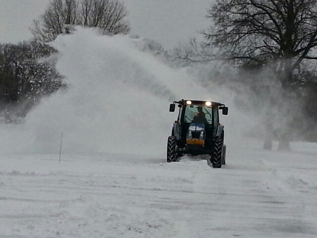

Yup..... TL100A New Holland with a Normand 92-280 Inverted blower.

Check out this video.... normally this driveway takes less than 1 minute. But, because no one lives there, I let it sit through a 3 day storm. The snow was about 36" deep at the deepest point. But it was also packed and drifted from 4 days of 25+ mph winds. I'll see if I have another video of me going through more drifts. I get TONS of drifting out by my biggest account, which is why I went to an inverted blower.

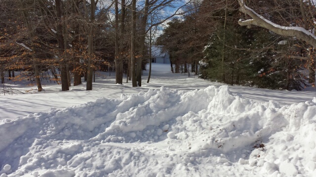

This was another driveway that was not cleared for over a month. 2 companies with pick up trucks tried and gave up. Entrance to the drive was 40" of packed snow from the county plow trucks. 225 feet long, 12 feet wide with a side load garage took 12 minutes.

Very cool. Does yours have the poly/urethane/plastic rear blade edge, or steel?

I burned up the standard steel edge in the first 12 or so events, then had a Hardox steel edge made. I have used up almost half of the Hardox edge now. We have been out close to 35 times so far this year. I don't run any shoes at all. I want it to scrape as well as possible because I maintain a few miles of roads in a subdivision, so vehicle traffic is always packing the snow.
I looked into using the Tivar 88 edge, but they don't scrape very well.

The first pass did you need to keep the blower up part way? And how much weight do you have on the front end?

Wow, that's some serious wear!

No weight on the machine at all. And no, I didn't keep the blower off the ground. Just pick the right gear, maybe lock the differential, and let her eat!
I am pretty happy with how the Hardox edge is wearing. The steel edge did what I expected..... wear out quickly.
I think I put on about 8-10 miles per day of blowing roads open. Then I pick up about 40 driveways and finish up helping my partner a my church, where I blow the roads and driveways open.
