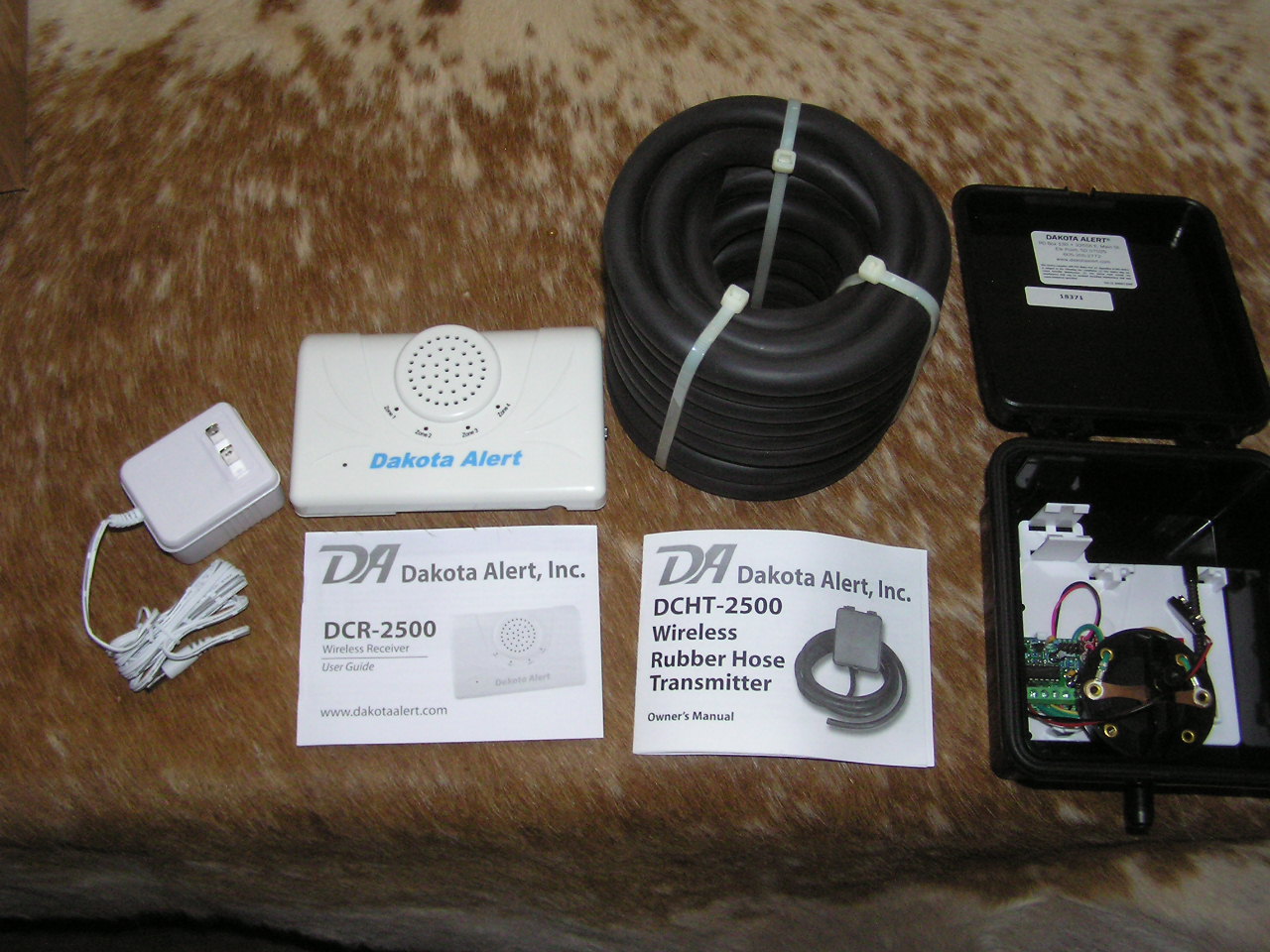

I just ordered one, so hope it will transmit the 1/2 mile rated distance :thumbsup:
If it doesn't it will be easy to move it closer until it works

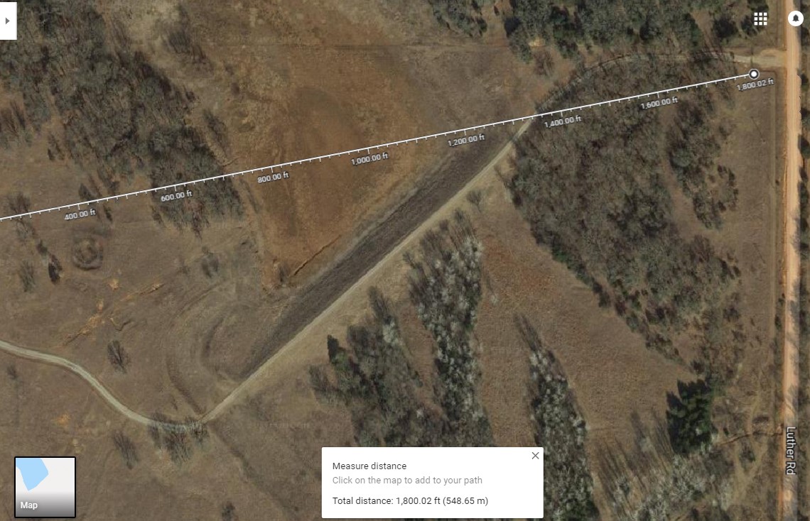

Well it quit raining, so I set the receiver in a upstairs window, put a short hose on the transmitter and took it to the gate. Held the transmitter above my head, it worked from the gate posts on either side, but there were a lot of dead spots also. Move it two inches and it would work, just like any UHF radio system.
Google maps shows it to be 1800 feet, the first 200 feet is through the trees, so it might not work when the leaves turn green.
Of course it worked fine on the downhill side of the trees, it is line of sight to the window.

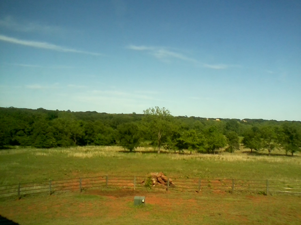

Update:
The Dakota Alert hose model has been installed on the south post for 5 months now and the trees are completely leafed out. It transmits fine though the trees. It has always alerted when someone drove in.
And no false alerts :thumbsup:.
The view toward the gate, from the window where the receiver is:
