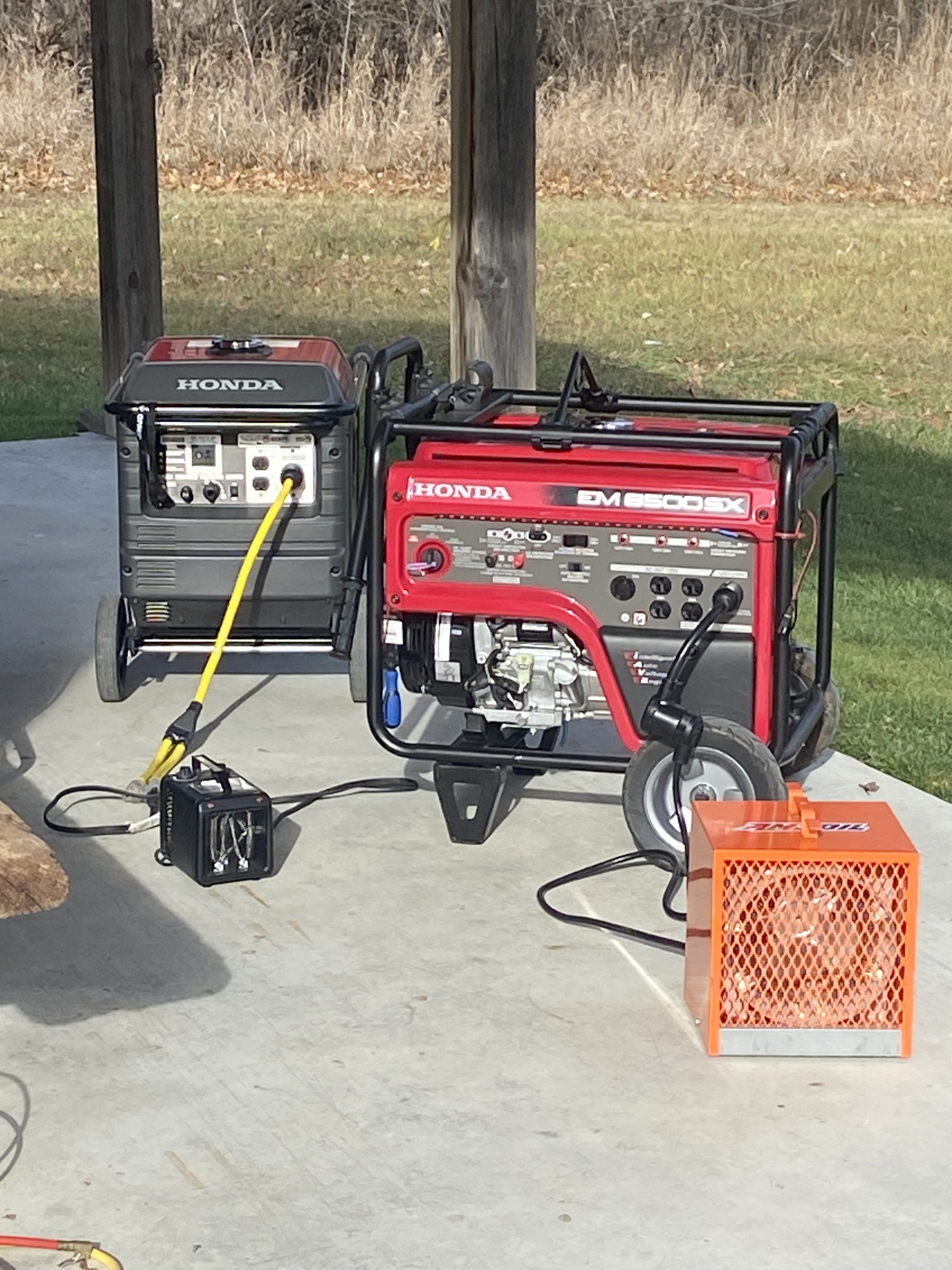

I called Predator phone # 888-866-5797 & gentleman stated to always attach electrical load when exercising my invertor generator.
/ Generator Dummy Load #63
I agree….🥴
