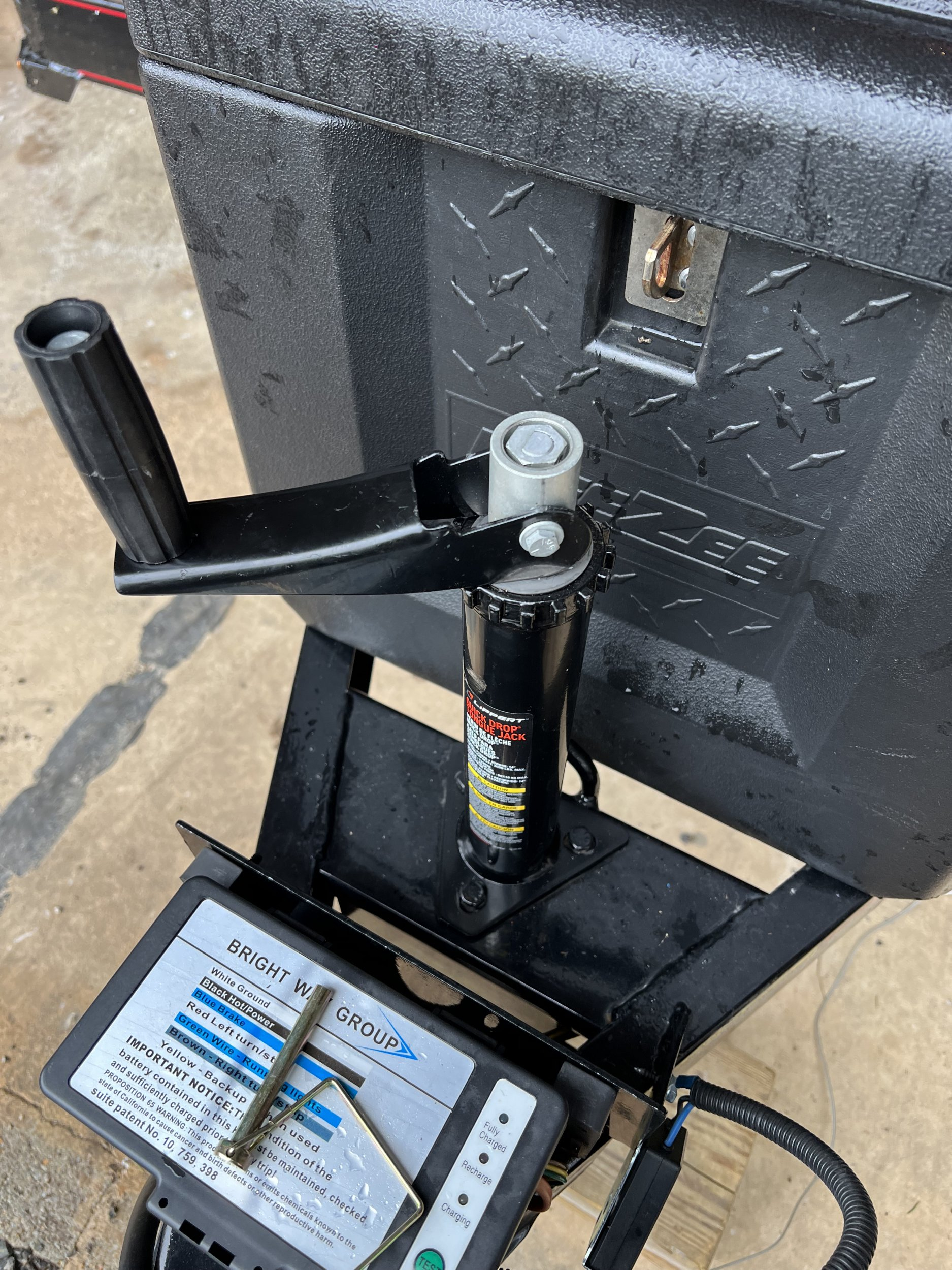

Getting my 7K Retco trailer ready for use for the mowing season.

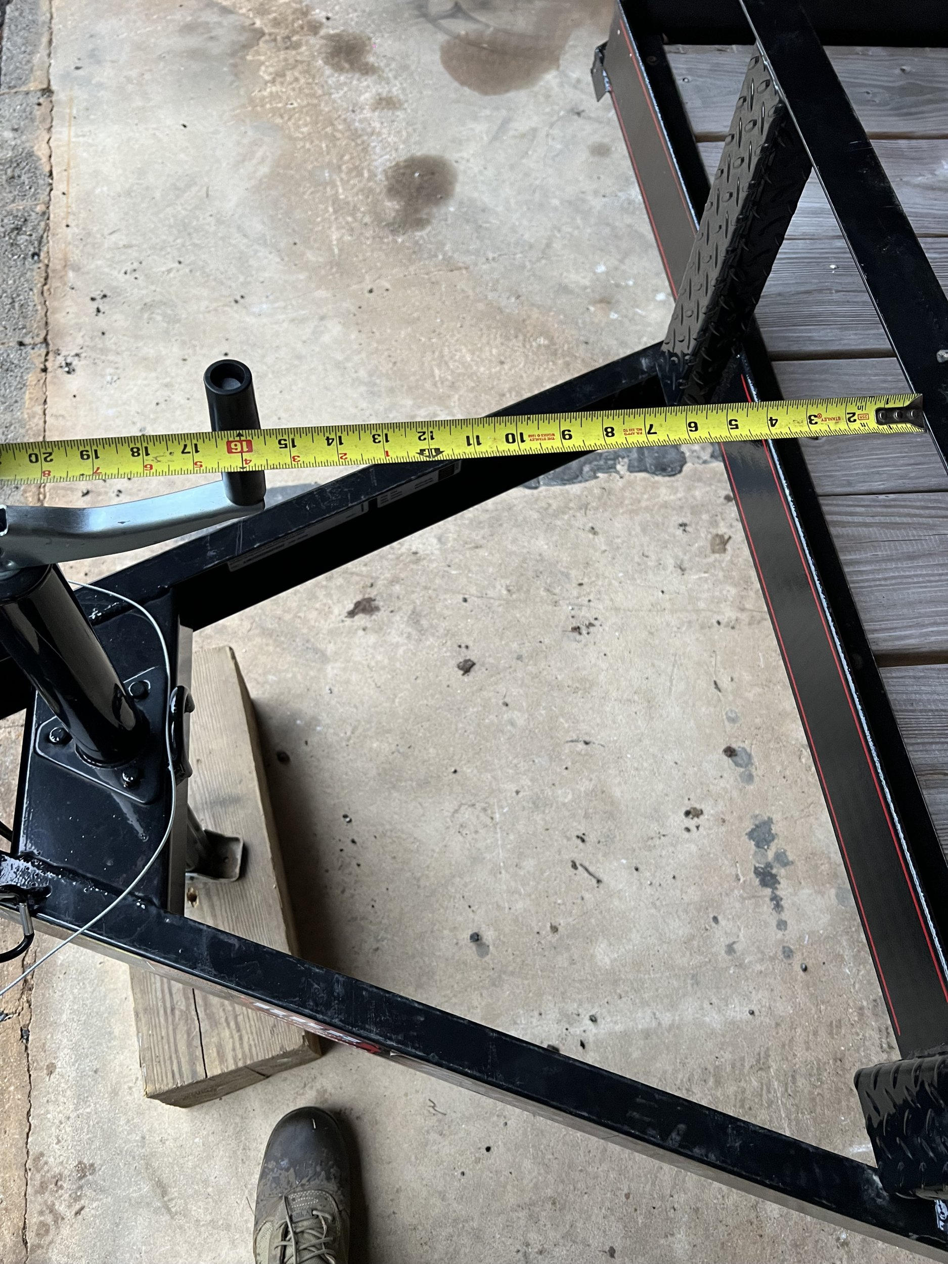

It has a typical top crank jack handle, but it leaves only 15” of space between top handle swing arc and the front trailer guard rail.
This leaves me no room for most trailer toolboxes which are at least 18” front to back. My hands hit the front of any would-be trailer toolboxes as most are 18-20”.
Has anyone found a taller/deeper toolbox?

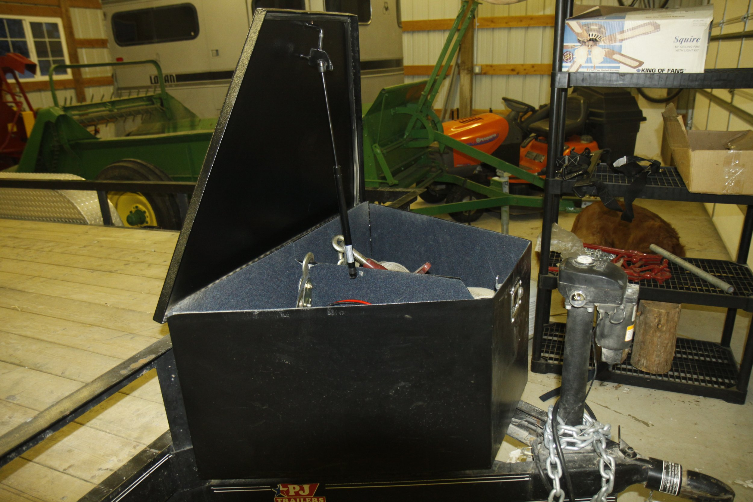

The Buyers “triangular” plastic toolbox on my little single axle is perfect…my single axle has more clearance between front of trailer & it’s’ jack.
I am running out of options on tool boxes and have started to think “outside the box” (no pun intended).
Should I replace top-wind jack with another jack instead? There are limitations to clearance for them, too.
Any other ideas? Placing tool box on the front of the trailer deck is NOT an option.
Inevitably, it will get smashed by mowers and I don’t want to sacrifice the space, either.

How much higher would you have to raise your present jack to clear your tool box?
Probably at least 6”
Current handle is about 12” above trailer frame. Tool box I have is 18” tall.

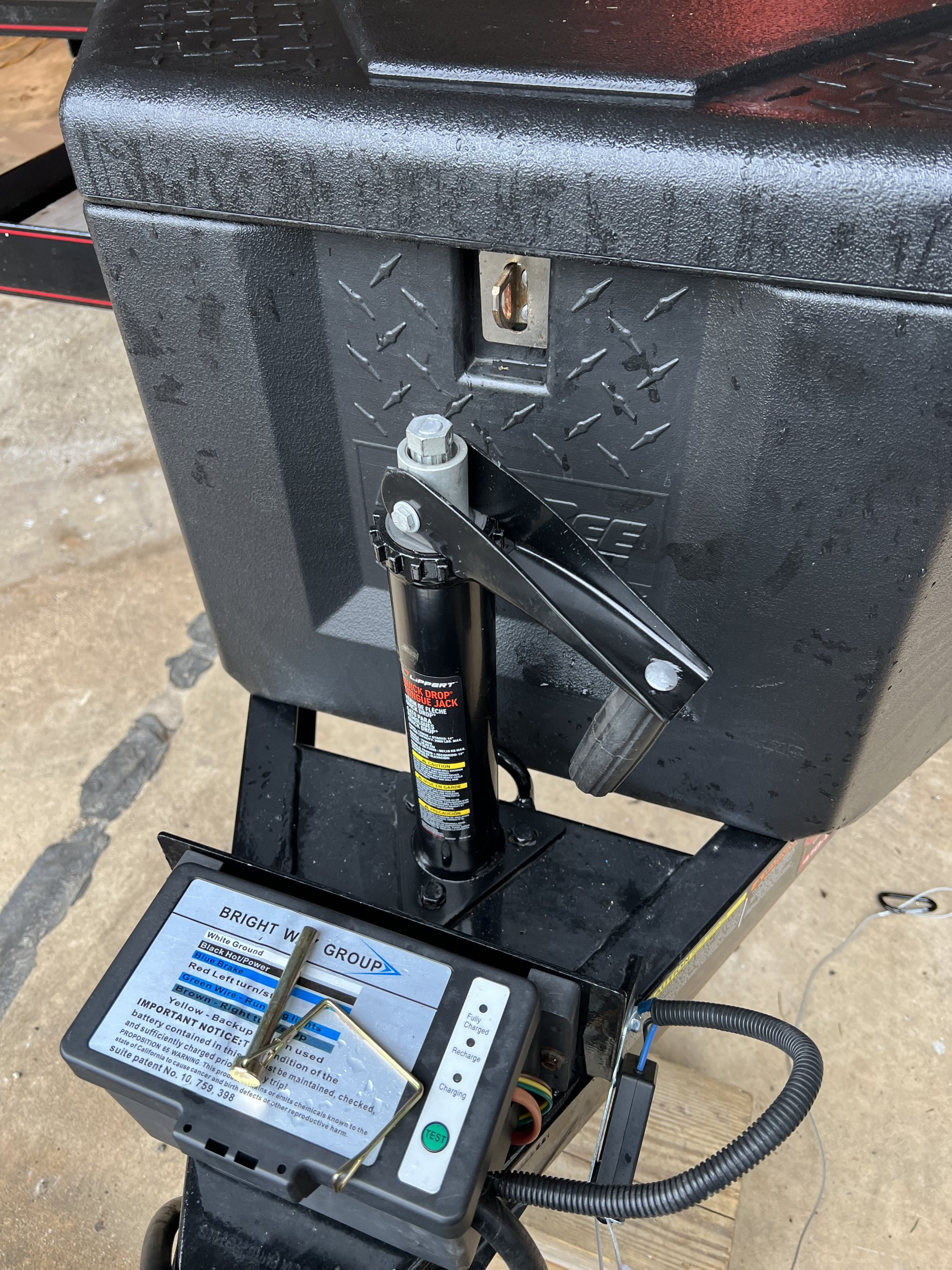

Mounted the Lippert Jack and then mounted toolbox. Manual crank is obstructed, but I can use 3/4” socket and cordless drill to attach/detach trailer.
Tried it a few times and it seems to work well.
I would prefer full use of the manual crank in case no drill, but the need for the toolbox was greater.
In a desperate situation I could do 1/2 cranks by flipping the handle, or remove the toolbox to allow full swing.
