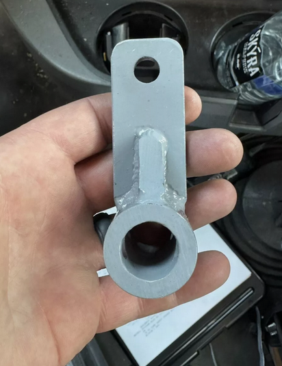

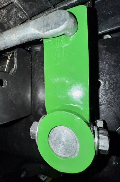

Yep, brakes should work, but I don't see many people complaining about this on TBN. The lawyers seem to be more interested in this than the owners. This is a real simple part and a super easy to replace.
In any case, the tractor will stop if
You take your foot off the hydro pedal
You put the hydro in reverse
You mash the RIGHT brake pedal
You drop the loader
