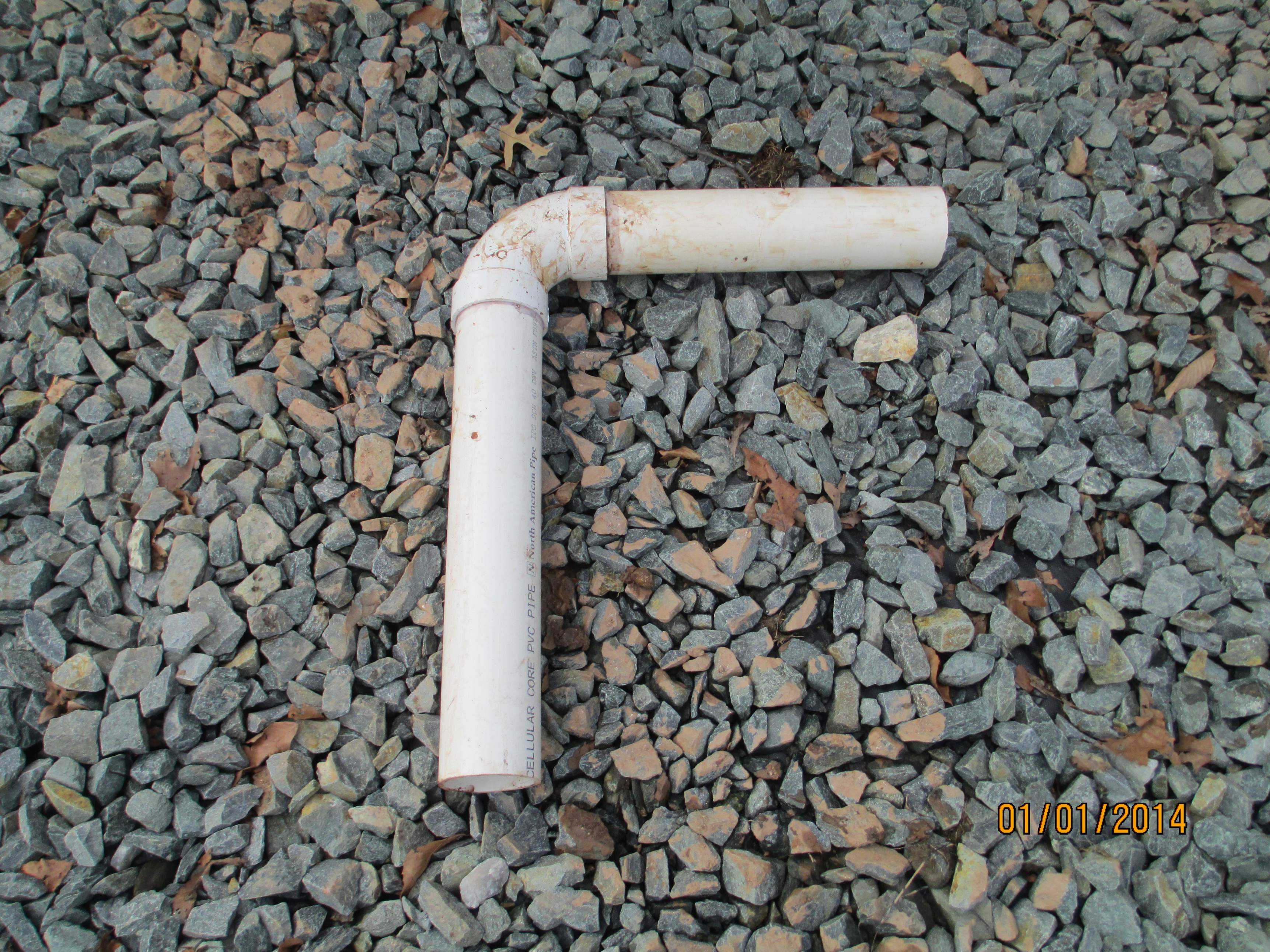

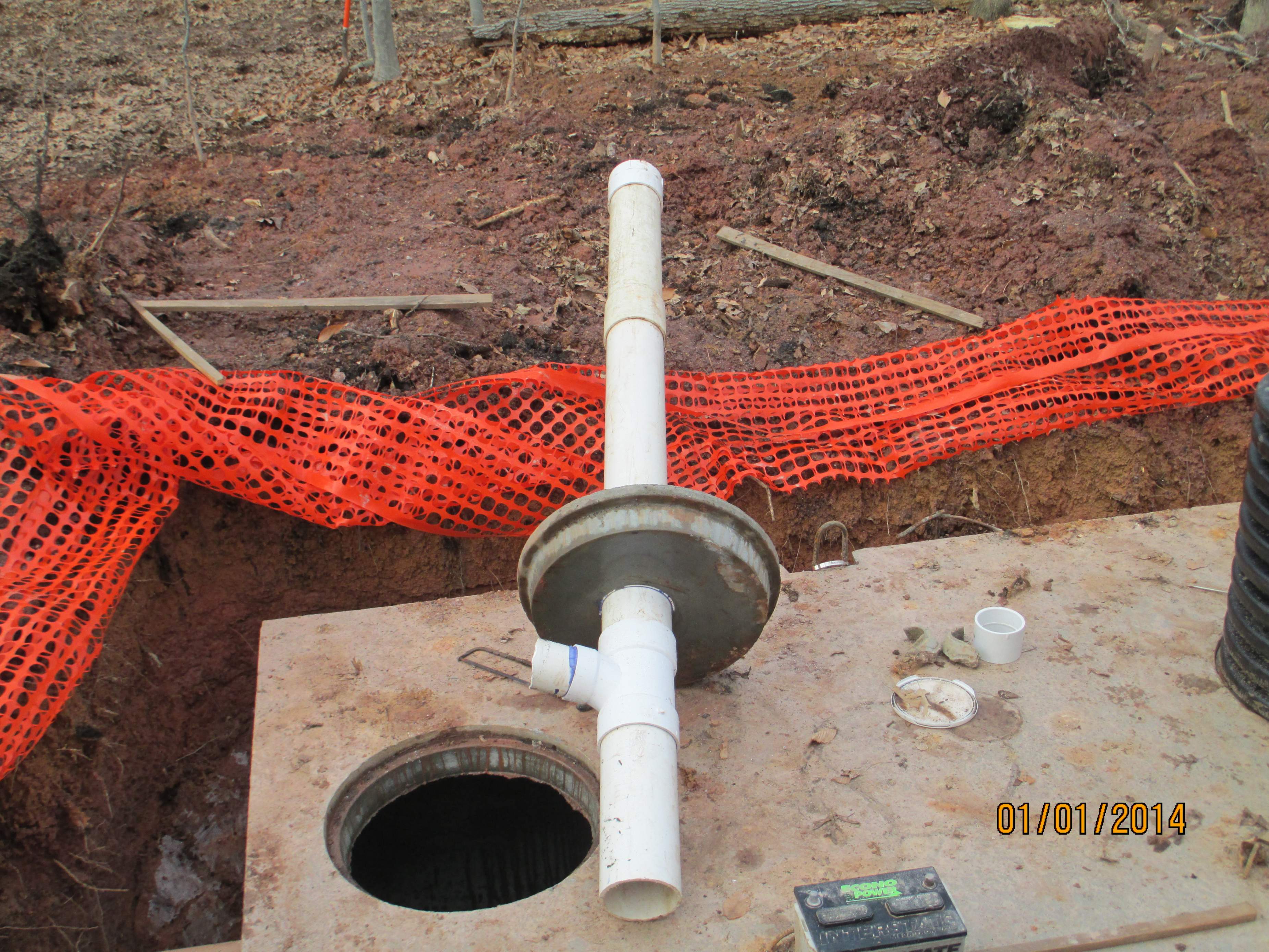

clayton i do not understand the reason for the outlet pipe being tied into the
concrete manhole cover. the cover is just that, a manhole cover used for
future inspection/pumping. it looks like an attempt to use the upper portion as
a vent?
wouldn't there be an outlet on the side of the tank that then heads to the d box?
and i have not seen vents at that side of a tank. i have seen "t"s on the inlet pipe
between the house and tank that vented up above ground, but never past the tank.
i think i'd get a new manhole cover, or a riser with elevated cover and outlet the tank
out of it's normal outlet hole with a straight piece of pipe and be done with it.

As you can see I removed all the previous pipe from the tank. I made up 2 pipes with tees for the inlet and outlet, acquired 2 risers, covers, sealer etc. I was planing to install this weekend but it is snowing now and the high for the weekend is 18 degrees. Burr.
I have no idea why it was installed this was to start, the correct way is easier, cheaper, and I am sure will last longer.
I did find the septic codes for our county online and I have no idea how any of it passed inspection. I intend to redo the install per the code with lots of pictures.
