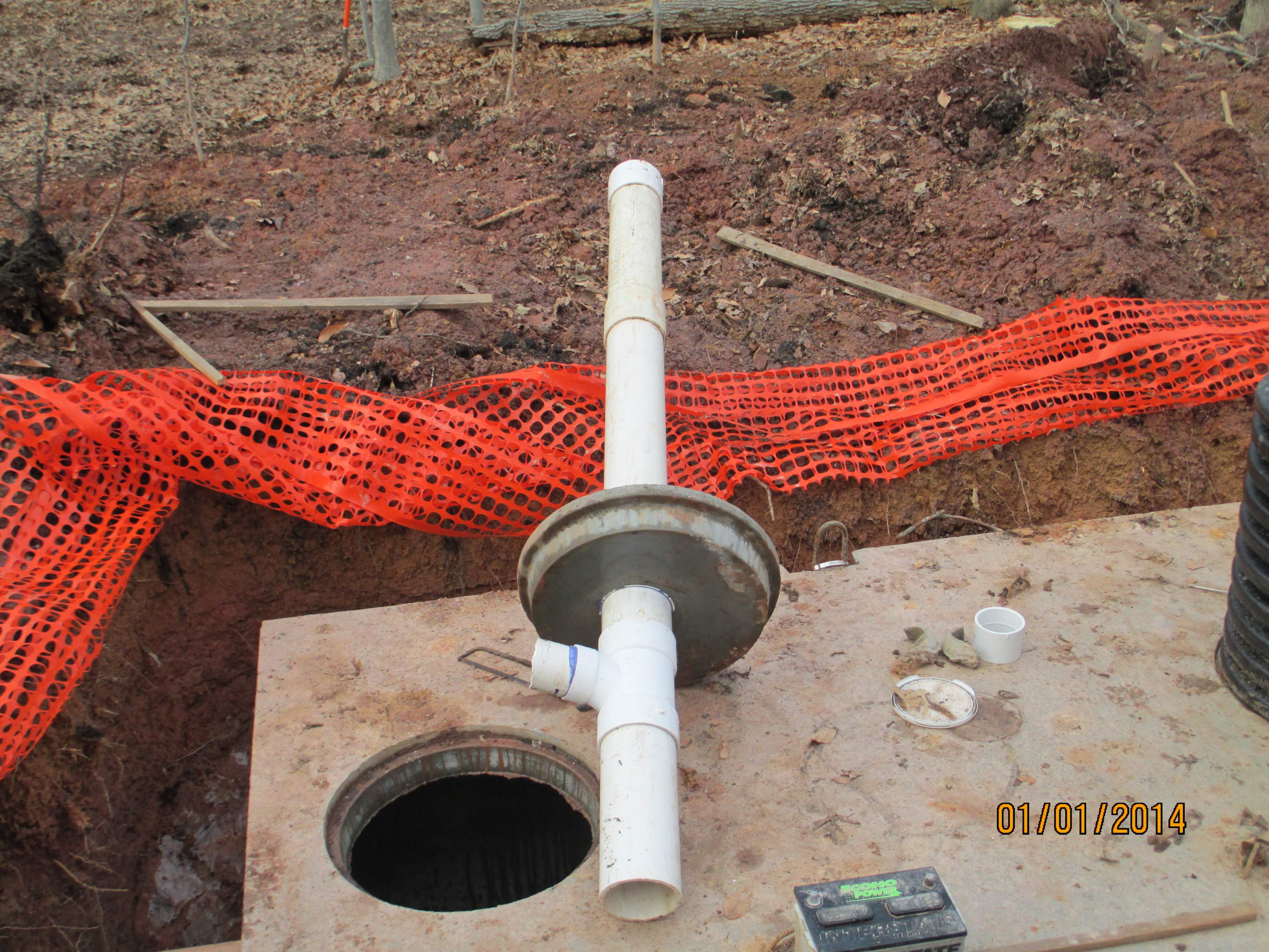

I am having a new septic system installed, some of the things the installer is doing do not make sense to me so I have a couple of questions.
By the way our county would not let me install the system, I had to have a licensed installer do the work but I do not think he knows what he is doing.
First the inlet and outlet on the tank, the tank came with rubber boots and clamps for the pipes the boots were pushed into the tank when it was delivered. He did not use these. He left the boots on the inside and filled the outside with some type of cement, no clamps on the boots. After 3 days, the cement has cracked and is falling out.
Next the tank has 2 manhole covers. On the outlet end he did not put a riser on the manhole, he cut a hole in the manhole cover and put a 6" diameter extension pipe to above grade. The extension pipe is glued to the outlet tee so neither the pipe or the manhole cover can be removed but it is loose since the cement is falling out. By the way neither of the manhole covers are sealed to the tank. It is a 2 chamber tank with no other access to the outlet chamber except the 6" diameter pipe and the tank is 2' below grade. The inlet has no riser currently.
Last but not least we have clay soil where the tank is. We have had rain for 2 days since the tank was installed and partially backfilled.When I went there today there are streams of water coming thru the side walls 3 feet below grade and 1 foot below the tank, the water is filling the hole almost a foot deep. The backfill is so saturated I can push a 2x4 5' into the fill by hand. I did pump the water from around the tank into the tank so hopefully it will not float.
The county was there 3 days ago and said everything looked good and they passed the system.
So my questions are: Should I be concerned about the connections at the tank? Am I going to run into problems with the current outlet tee / manhole setup? Will the runoff water be a problem after the tank is completely backfilled and covered? I plan to live there for the next 10 - 15 years and I do not want any problems that could be fixed or prevented now.

I have no risers on the manholes - must dig each time. I intend to correct that.
You really only need access to the front of the tank (or front tank) for pumping. Thats where the solids will collect.
As far as I know, the inlet pipe is not sealed to the tank well.. Mine has gaps. This usually is not a problem as the water level should never reach that high. The baffle to the other tank and the outlet pipe are lower. Ground water will tend to push into the tank rather than sewage come out if the water table gets that high.
The 6" pipe in the other manhole cover is quit possibly a vent, though now a days the main house stack is used as a vent instead, maybe yours is different.
I prolly wouldn't call it 'getting screwed', but it very well could be sloppy work. I would take pics and call in another guy to have a quick look.

Yes the outlet side does have very limited access. The entire outlet pipe, tee, manhole cover and inspection pipe etc are one glued together mass. I see no way to install a filter as the inspection pipe is 7 feet to the outlet tee. I will not cover the tank until this is fixed.
I am fairly certain that ground water will run into the tank since the outlet manhole cover does not fit correctly. The outlet side has been filling as it has been raining.
I was looking for some tips to make sure it is fixed correctly and that it will last.

You prolly dont need nor want a filter.. The 'tee' is the outlet baffle and the bottom will be below the surface of the water with the top a vent for releasing gases.
The only problem I really see is not having a manhole for that side of the tank to use for later repairs. Though, to be honest, IF you need to repair that side, the pipe on that side will also have to be dug up so its kinda moot.

If it hasn't filled itself already, fill that tank with water!! The last thing you need is an installed tank rising up. As soon as the installers pulled out of my drive, I had a water hose running into the tank.
I don't understand a two compartment tank with no access to the outlet side. Here, ALL compartments have manhole covers and the tank pumpers pump all compartments (no, all solids do not come to rest in the first one).

Apparently you have a signed final inspection report. Most jurisdictions use all or most of one of the model codes. I have an older version of the ICC code for private sewage systems and will post excerpts at the end of this dialog. Your installer should have gotten a professional design approved by the "justification having authority". He is required to provide you a copy for your records. You may want to hold payment till you get it and the inspection certificate. Pay him before you start anything else or he may sic his inspector buddy on you again.
Now the fix: Sounds like it is pretty minor and you could do yourself. Who is the manufacturer? Their local supplier should be able to link you up with them to get a copy of their installation guidelines and the various parts like the risers. Worth a try, tell them you need it for your record package. Once you know the brand name search it on the web. You can probably find another, non-local supplier that will sell you the parts you need. Your contractor is surely buddies with their local supplier and already knows your name. Then fix it yourself. Should be easy to reconnect the inlet and outlet lines using "FERNCO" neoprene connector available at even the big box stores. Measure the OD of both ends. If they do not have that one they can order it as they are made in sizes to match all types of material. Document everything in detail so you have a record.
Excerpts:
802.4 Manholes. Each compartment of a tank shall be provided with at least one manhole opening located over the inlet or outlet opening, and such opening shall be not less than 24 inches (610 mm) square or 24 inches (610 mm) in diameter.
Manholes shall terminate a maximum of 6 inches (152 mm) below the ground surface and be of the same material as the tank. The manhole extension on fiberglass tanks shall be of the same material as the tank and an integral part of the tank.
Methods of attaching fiberglass risers shall be water tight and approved.

I thought I would post some pictures, it explains the install much better. The pipe with the 90 on it was the inlet. No tee in sight. The inlet side in the tank was 21" long.
The pipe with the tee / manhole cover etc. was the outlet. The short pipe is 4", it went to the dist box. The other pipes are 6". The upper part of the 6" with the coupler and cap are not glued together but everything else is. The lower part is 21" from the bottom of the tee. As you can see the hole in the manhole cover is not centered so the cover does not fit, the rear of the tank is filling with rain water.
My tank is 5' tall inside and the outlet is 4' from the bottom of the tank to the bottom of the outlet hole.
Any ideas how long the inlet and outlet pipes should be inside the tank?
I have 2 tees, 20' of pipe, 2 ferncos, risers, lids, sealer, hopefully everything needed to have this fixed and covered in the next couple of days if the rain stays away.
