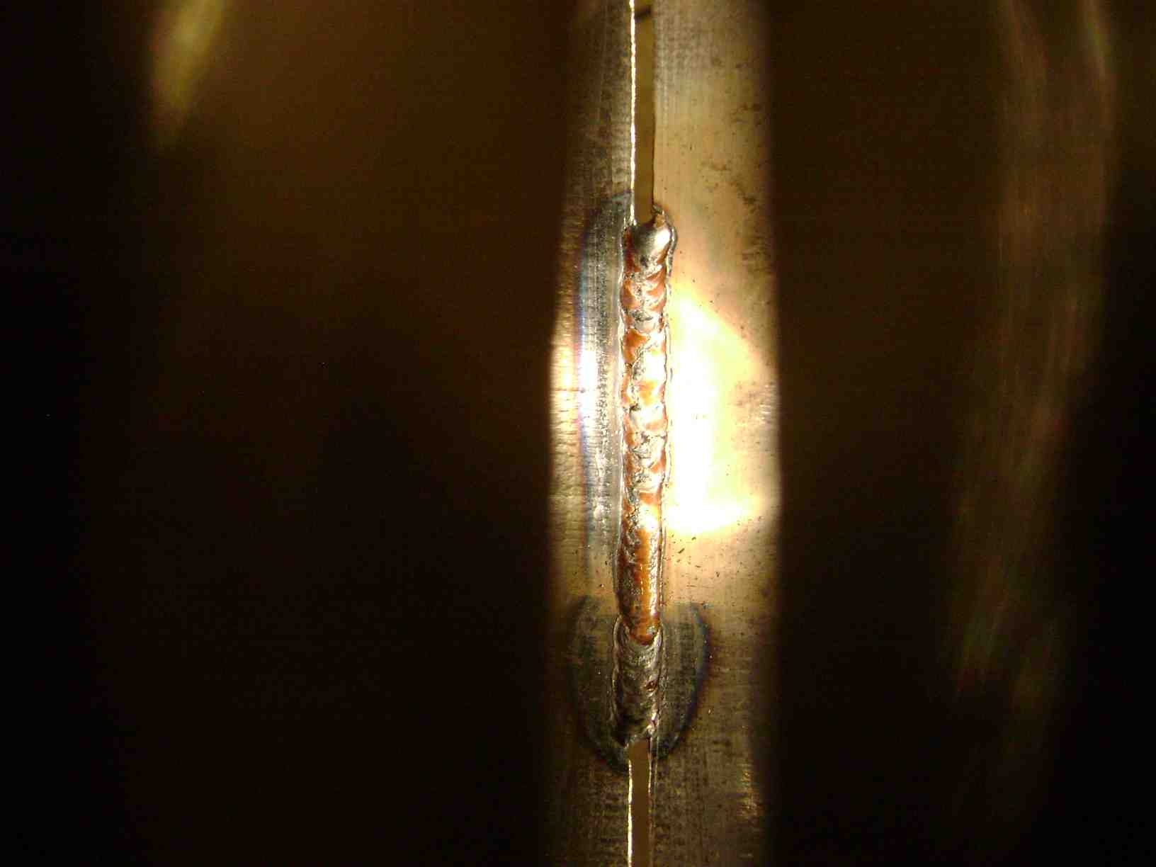

I don't see any reason not to Tig weld all the way.

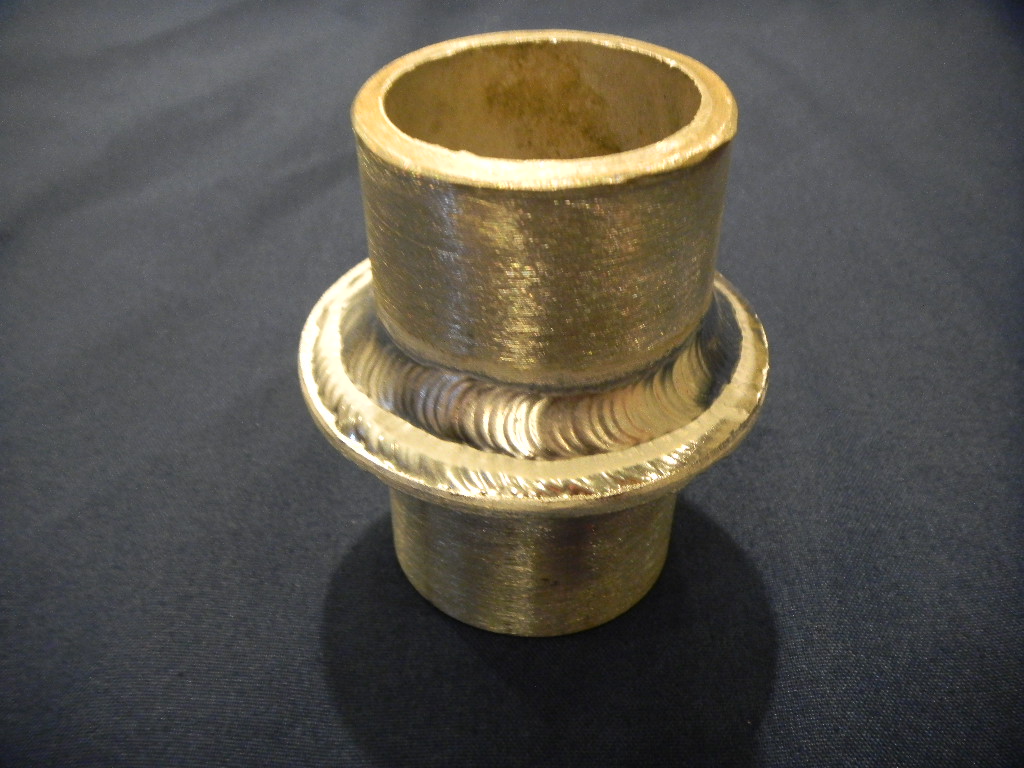

/ any pipe fitter/welders #8
Back then Tig on mild steel was unheard of.
Ron talking to different welders who work in the local Navy ship yards. All pipe welding is done with Tig. The welders who work on the submarines amaze me when they have to stick the filler rod through the pipe to weld on the opposite side of the pipe. :cool:

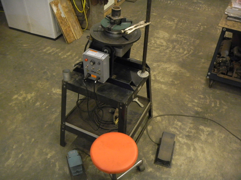

If you roll the welds, get some wheels to roll the pipe. Trying to roll it on a piece of angle iron isn't going to roll smooth enough.
Or get one of these. This thing makes my welds look good! :cool2:
