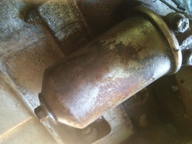

photo (3).JPG ok oil filter canister?

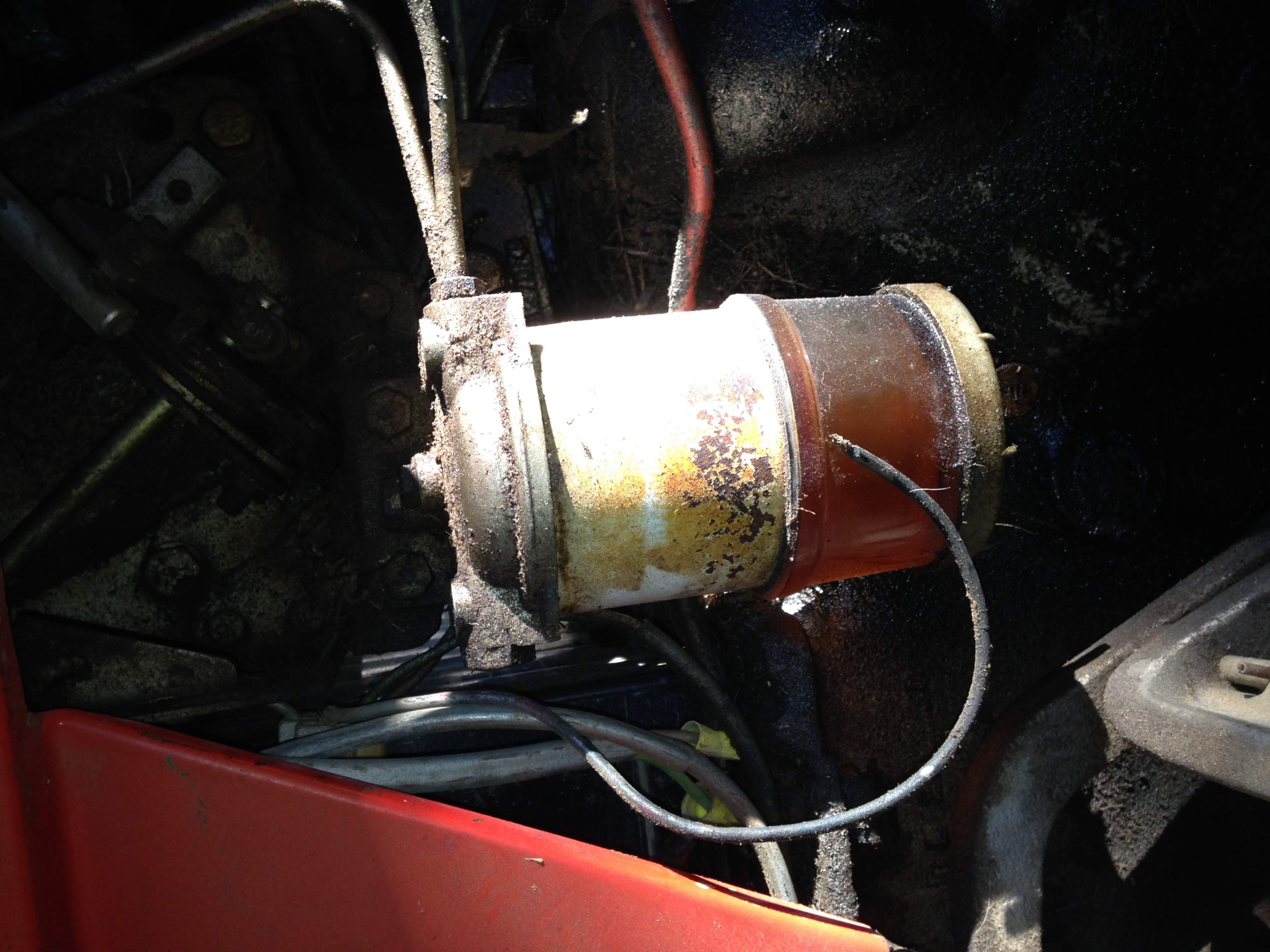

thanks aaron , so they are both fuel filters are should both be replaced

View attachment 357200 ok oil filter canister?
I think so... Its been 5+ years since he sold that tractor and more since I wrenched on it, but I am fairly certain that the fuel filters were both the same shape and the filters might have even been interchangable.
I believe that they were on his tractor (which had a 50ish HP Perkins Diesel), but as I said, its been a while.

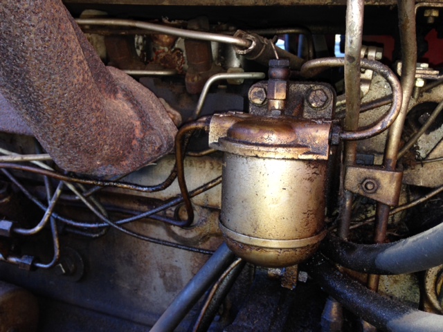

so Aaron when I replace the filter with the bowl, I take it apart and do I pour out liquid out of bowl. or leave it full ?.. is it diesel in the bowl?

Its diesel in the bowl and I would pour it out. I don't remember if the bottom comes off of the bowl or not (ie: is the "bowl" just a "ring" that the bottom seals against. If it doesn't come off, I would refill it. If it does, I would let the fuel system refill it after you button things back up.

Thanks Masseywrench and aaron for all your help....Masseywrench I put some photos up,,,it took me some time to figure it out, but with yalls help I think im getting it, and yes I did order a manuel ,,,, thanks again u really help,,, I cant get anyone to work on it due to the location of the tractor...I will just have to learn and do it myself.
