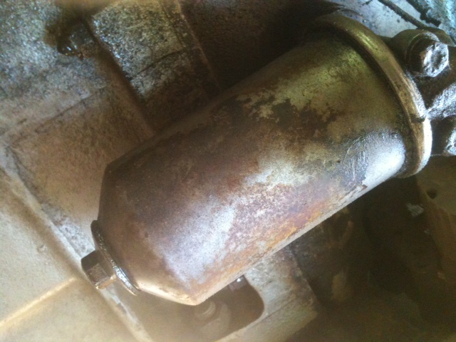

The filter that you are seeing on the other side (canister) is probably going to be your oil filter. It will be low on the block just above your oil pan. It should mount directly into the side of you block. Does it have any lines coming off of it going anywhere or is it mounted there by itself?

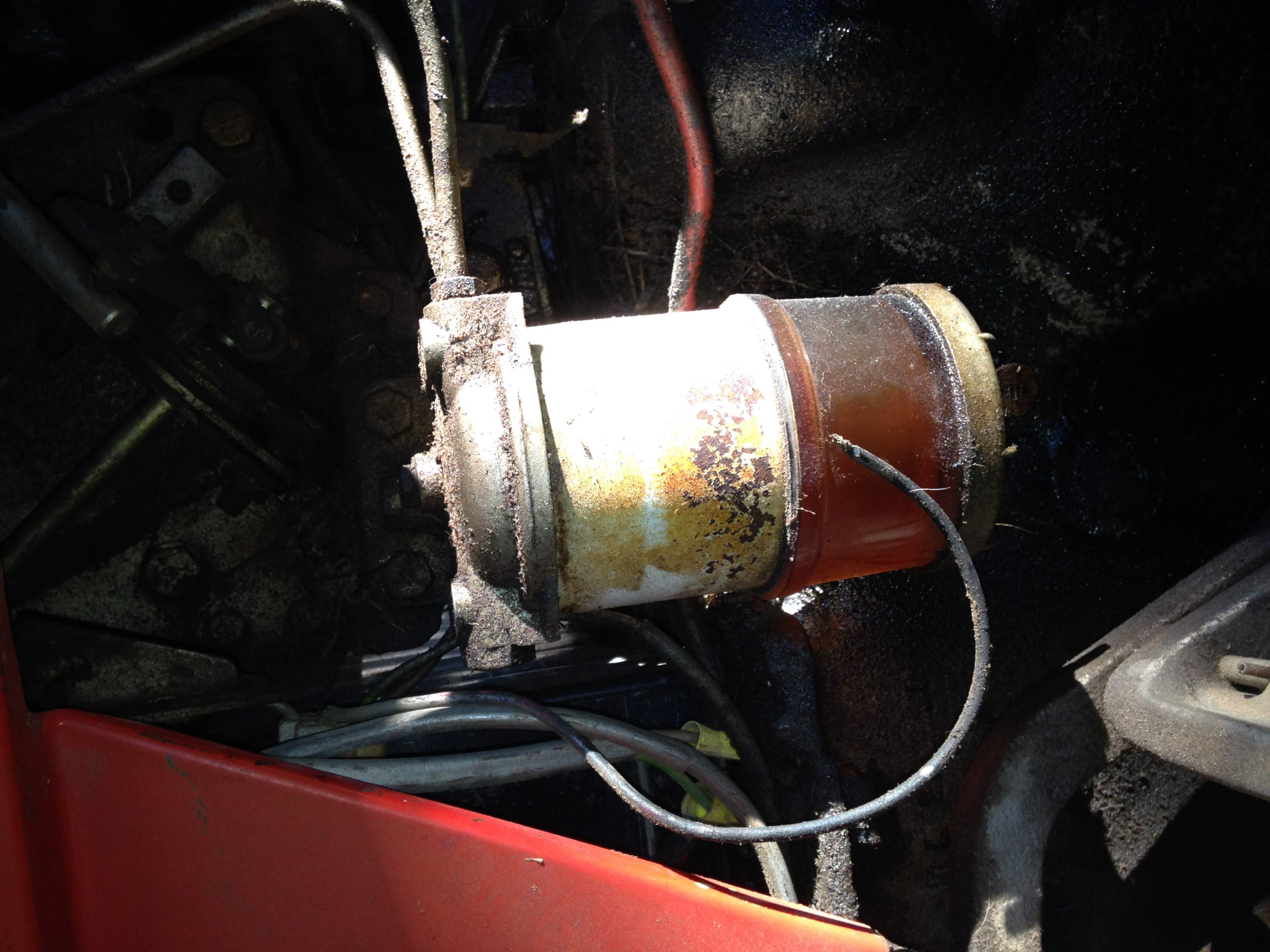

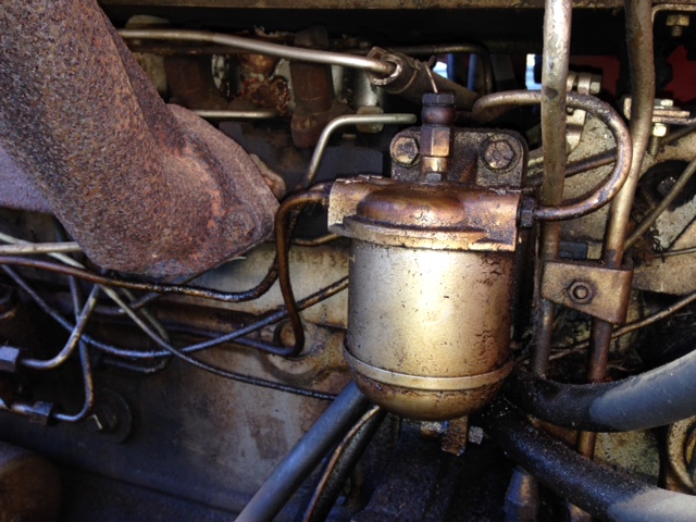

photo (1).jpg try again

thanks aaron , so they are both fuel filters are should both be replaced
/ Any MF 165 owners....need some help #15
View attachment 357200 ok oil filter canister?
I think so... Its been 5+ years since he sold that tractor and more since I wrenched on it, but I am fairly certain that the fuel filters were both the same shape and the filters might have even been interchangable.

so Aaron when I replace the filter with the bowl, I take it apart and do I pour out liquid out of bowl. or leave it full ?.. is it diesel in the bowl?
/ Any MF 165 owners....need some help #18
Its diesel in the bowl and I would pour it out. I don't remember if the bottom comes off of the bowl or not (ie: is the "bowl" just a "ring" that the bottom seals against. If it doesn't come off, I would refill it. If it does, I would let the fuel system refill it after you button things back up.
