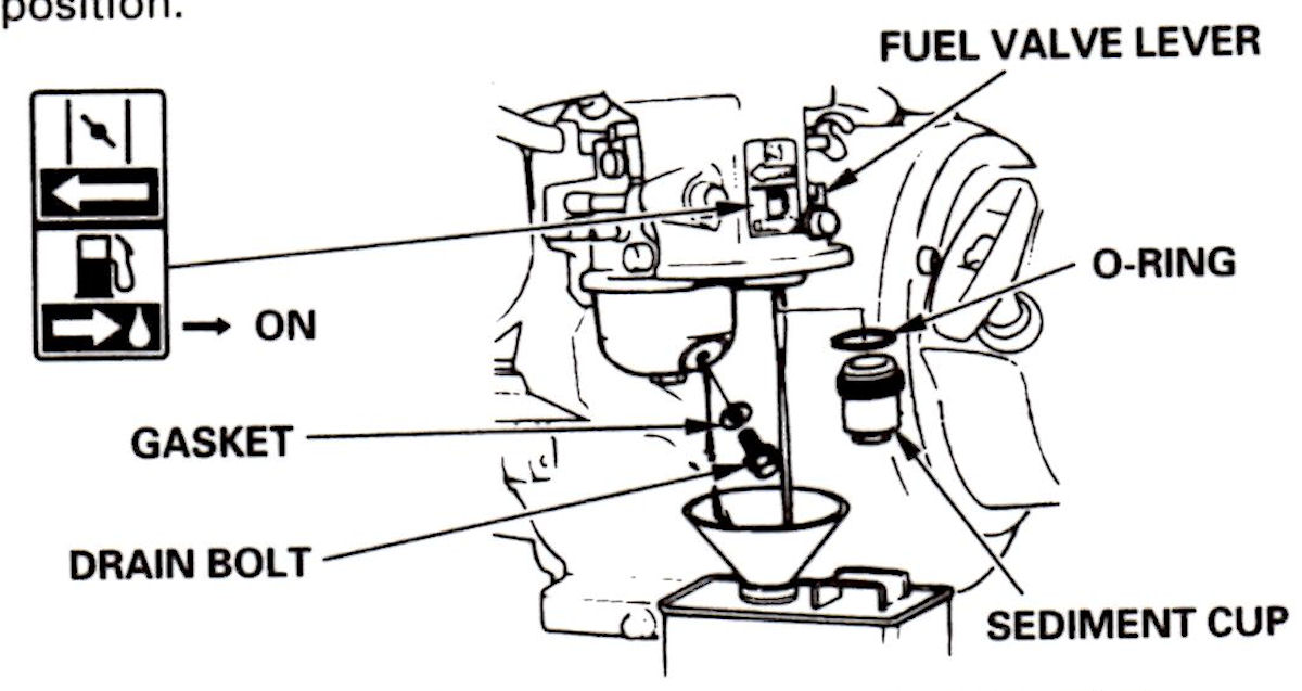

Hi! Before start. Drain carburator (six month) and tank (year) for remove water and dirt. With time condensation make water this one go down in tank and carb. You can use gas stabilizer. I add a pict for help to drain img003.jpg. I make this with my garden tiller for 20-30 years with succes. Good Luck Oldmech
