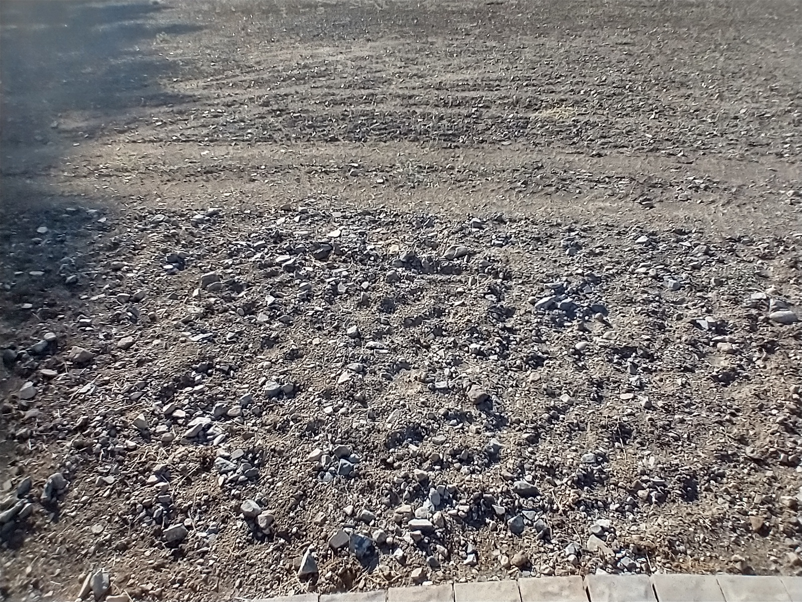

My lot has a lot of small 2-4" rocks that I would like to clear. I was going to try to collect them by hand with a garden rake but it's just to much. I can buy a 48" landscape rake for my BX for $600 but was wondering if it would be the right tool. My rototiller sorted out all the bigger ones. Thank goodness for it's slip clutch.

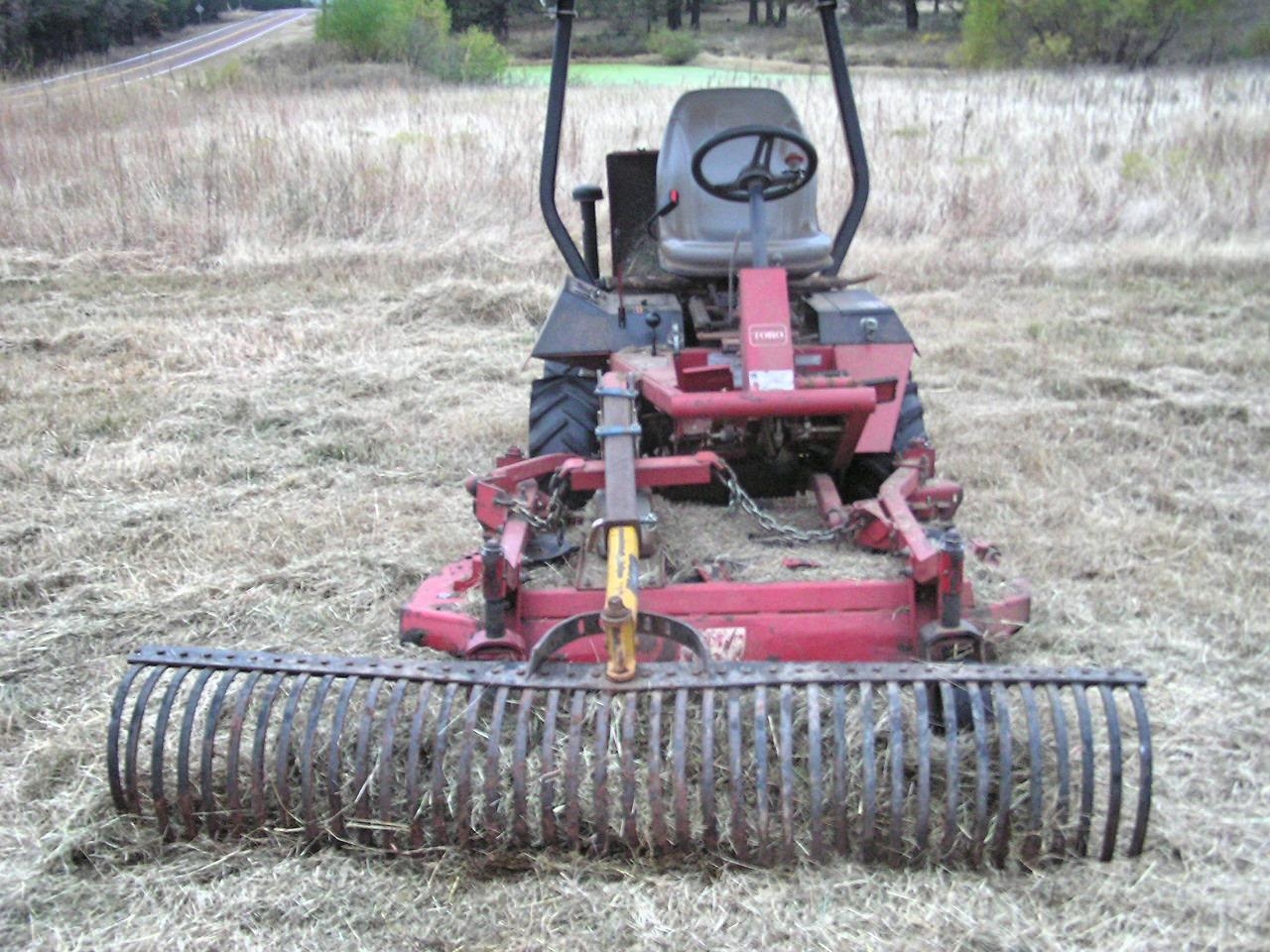

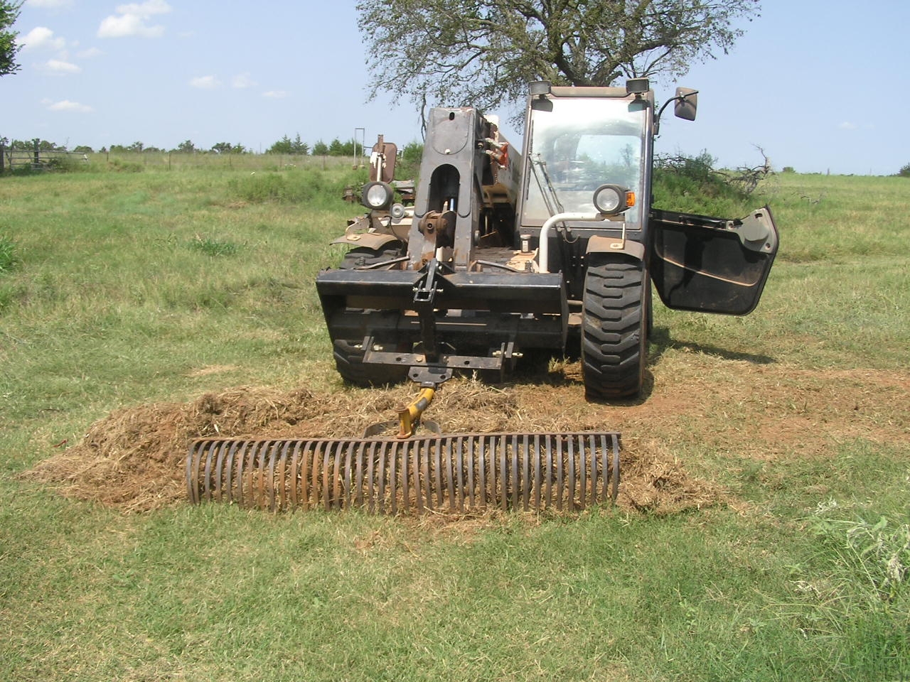

Here is my experience with a 6' landscape rake, it is a little different:

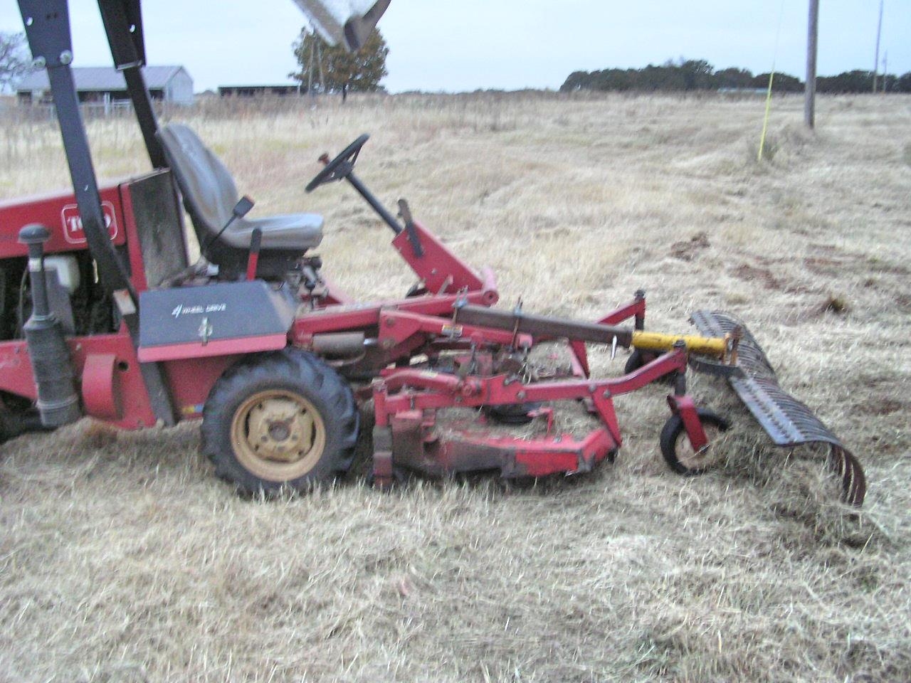

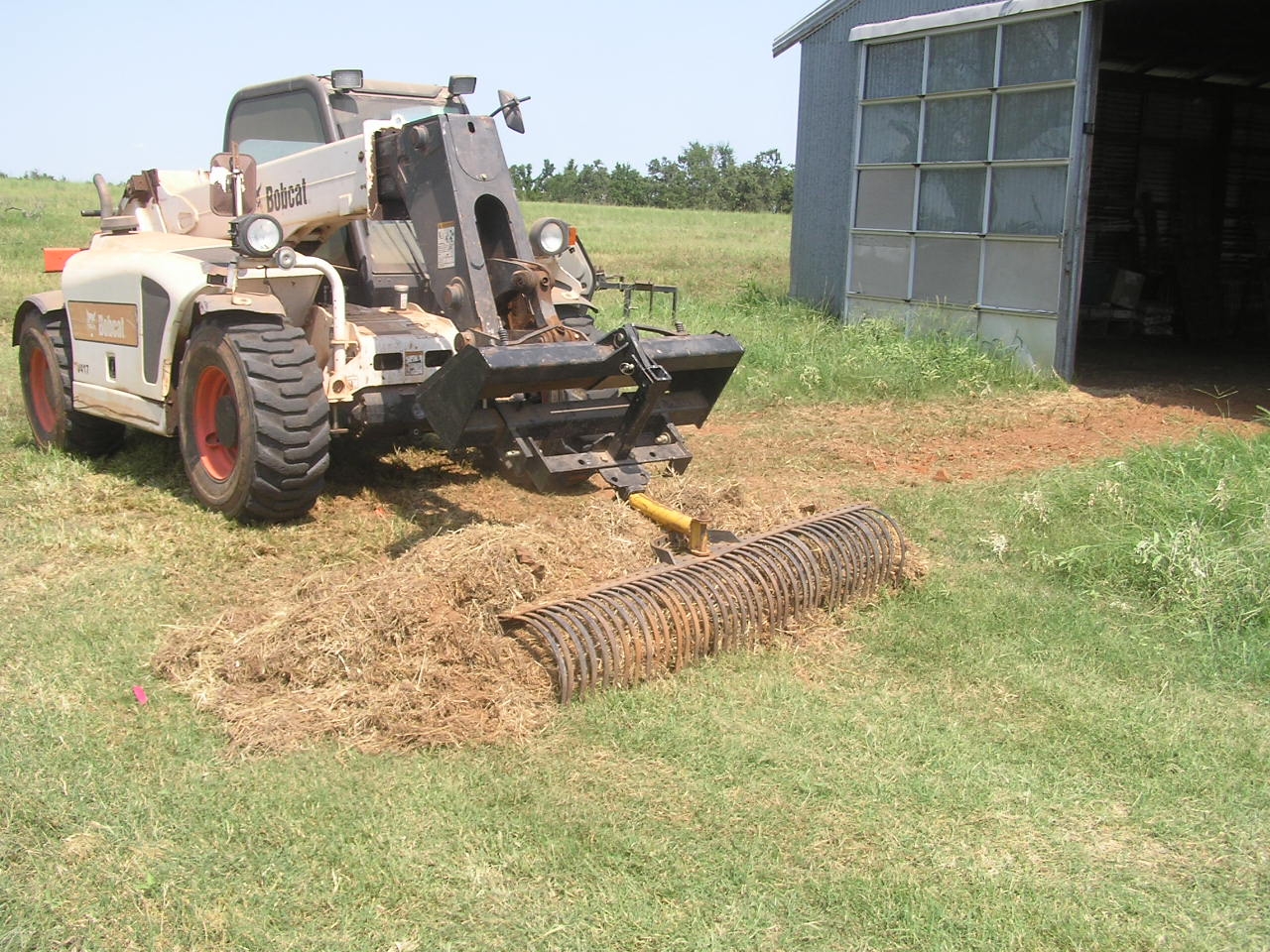

Here is another of my experiences with the 6' landscape rake, it is also front mount:

I use a 7' landscape rake to maintain my ½ mile gravel drive. It works very well for that application, but in your case, with "small rocks" the issue, even at an angle it will likely leave 20%-30% of them on the surface.
A previous poster had a great idea, IMO, by welding a bunch of hand held rake "blades" together and mounting on the landscape rake super structure, so those could be angled. That would do a superior job in getting almost all of the rocks accumulated.

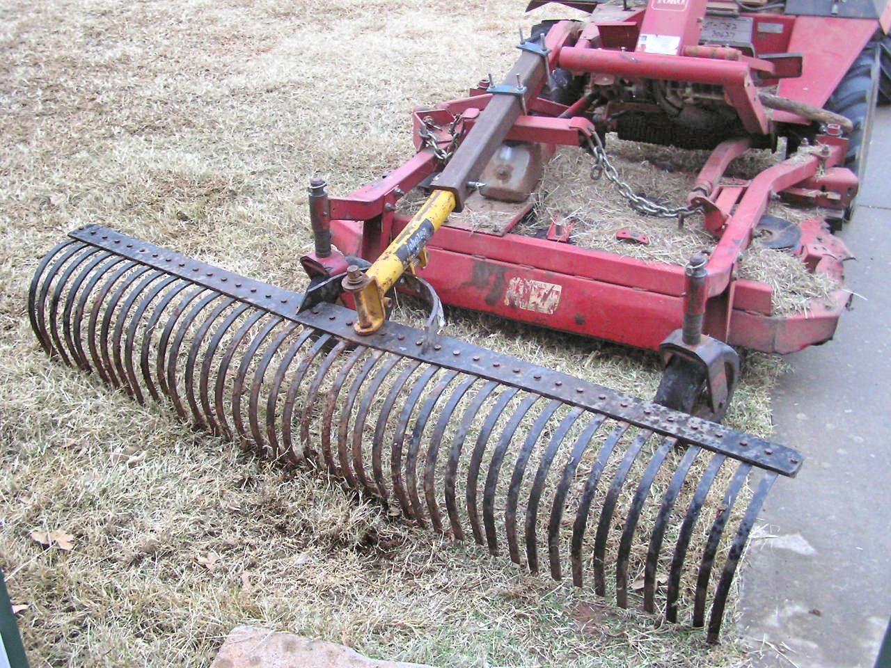

Here is my experience with the 6' landscape rake in the normal 3 point configuration:
