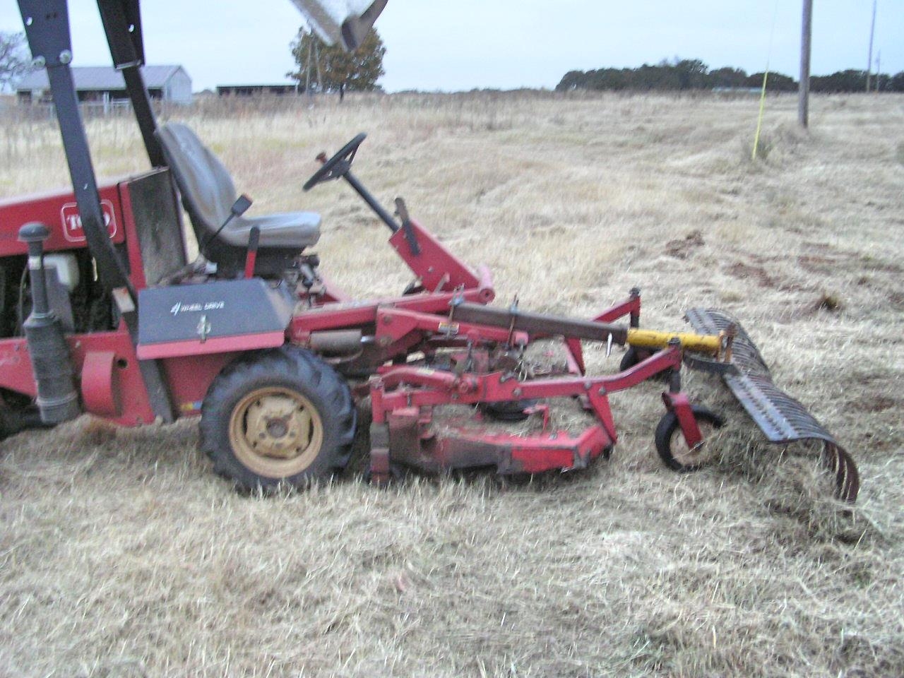

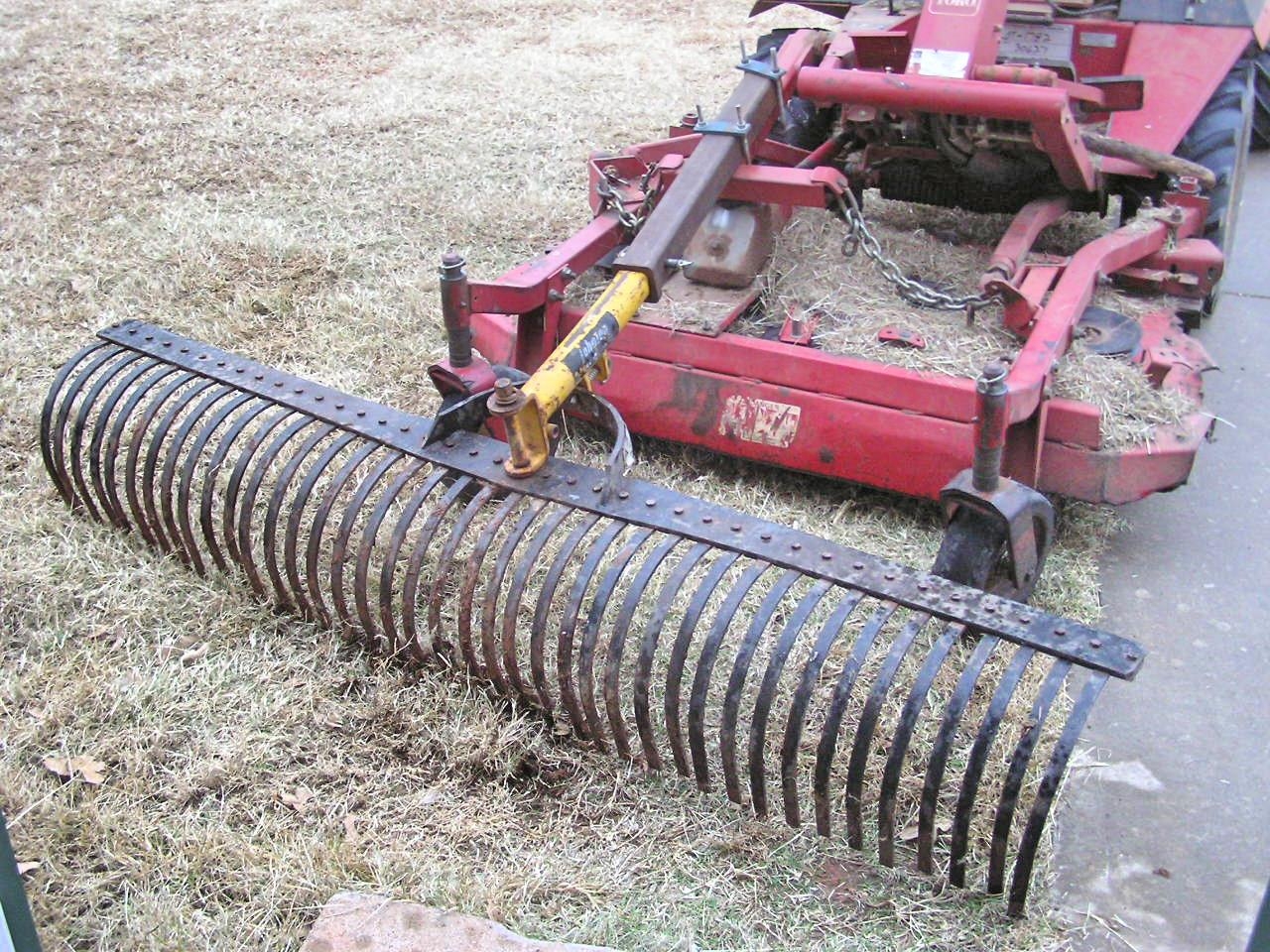

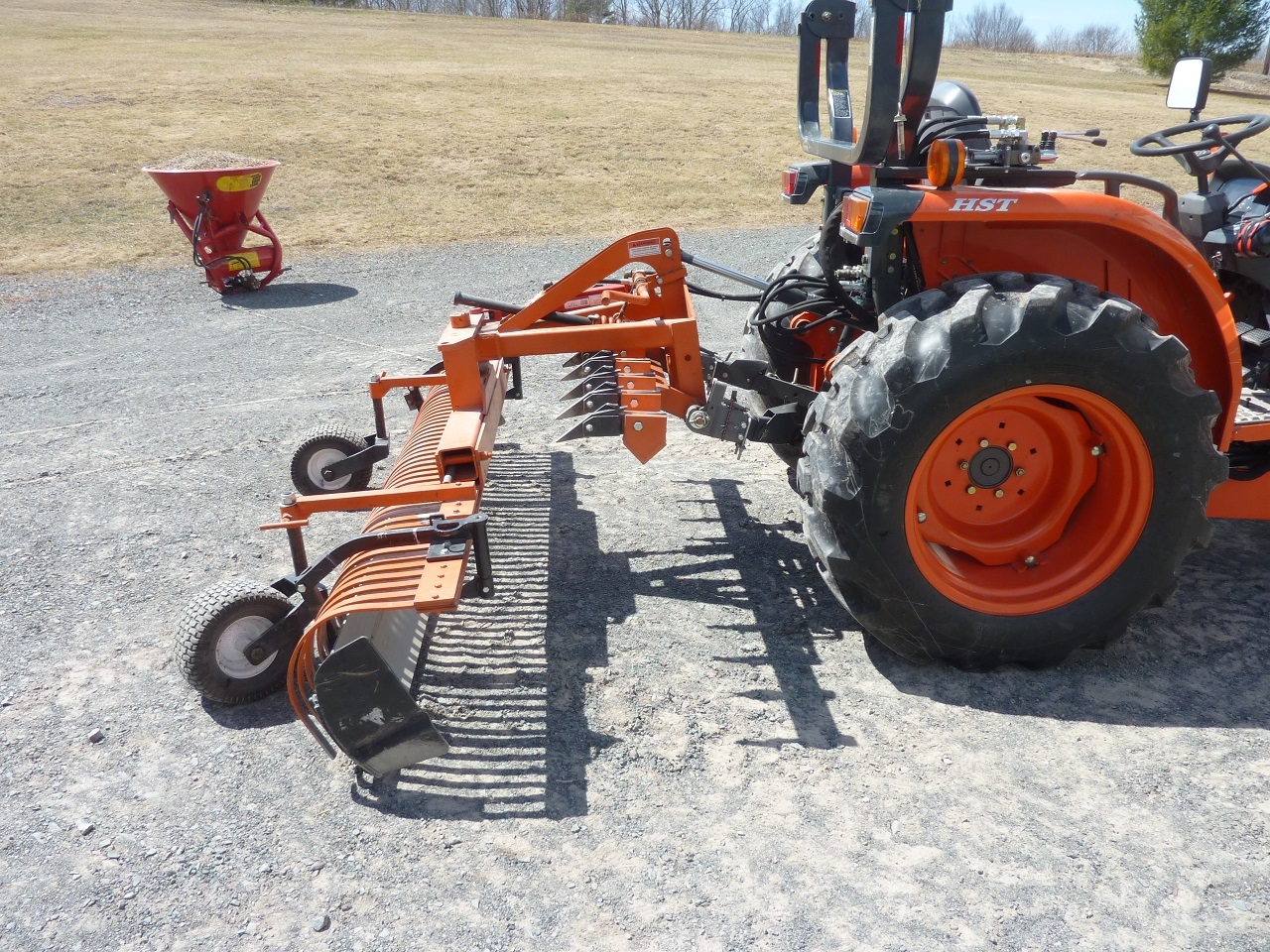

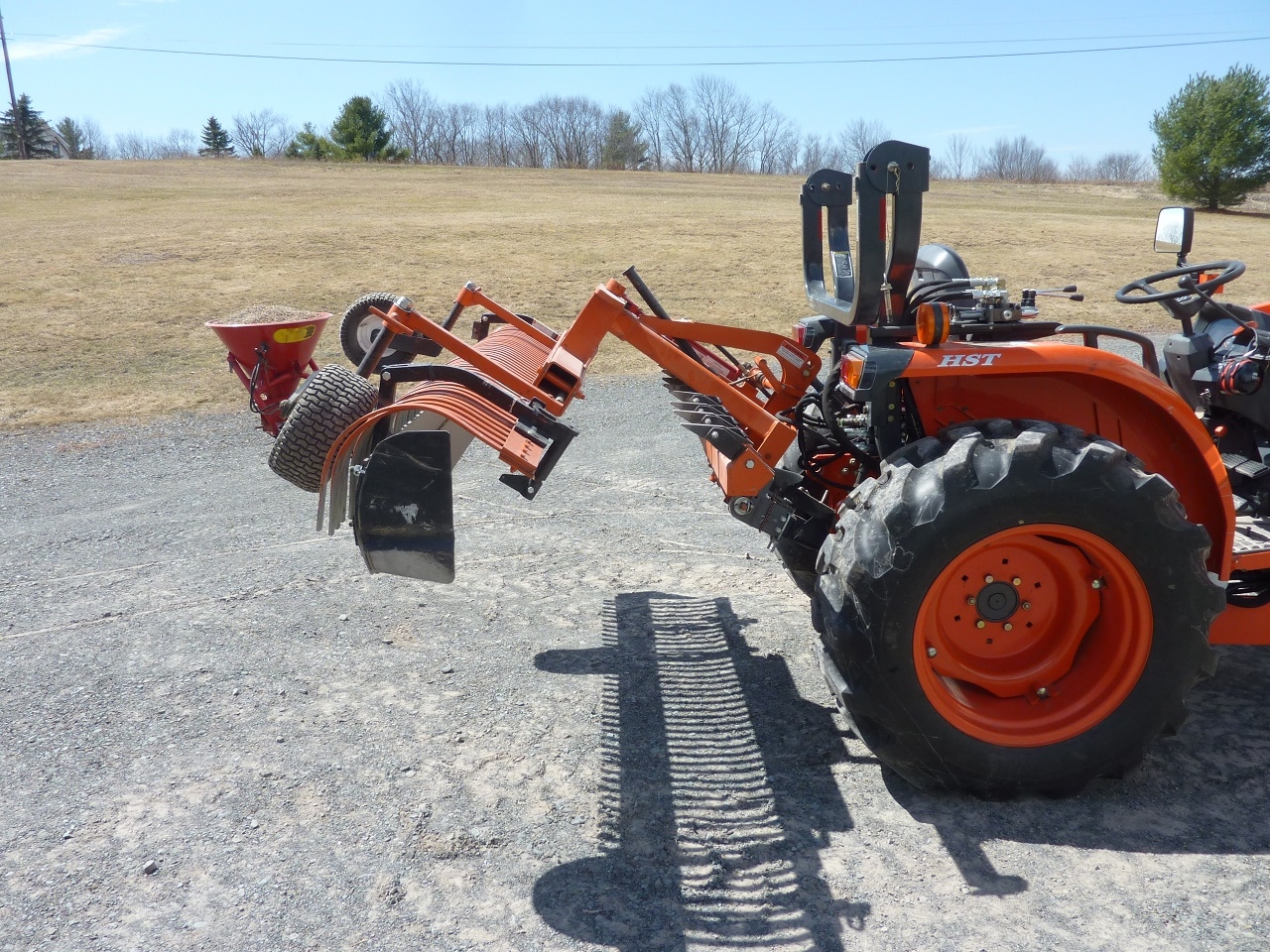

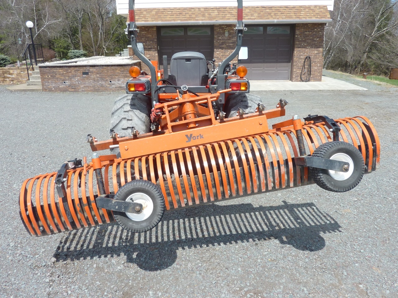

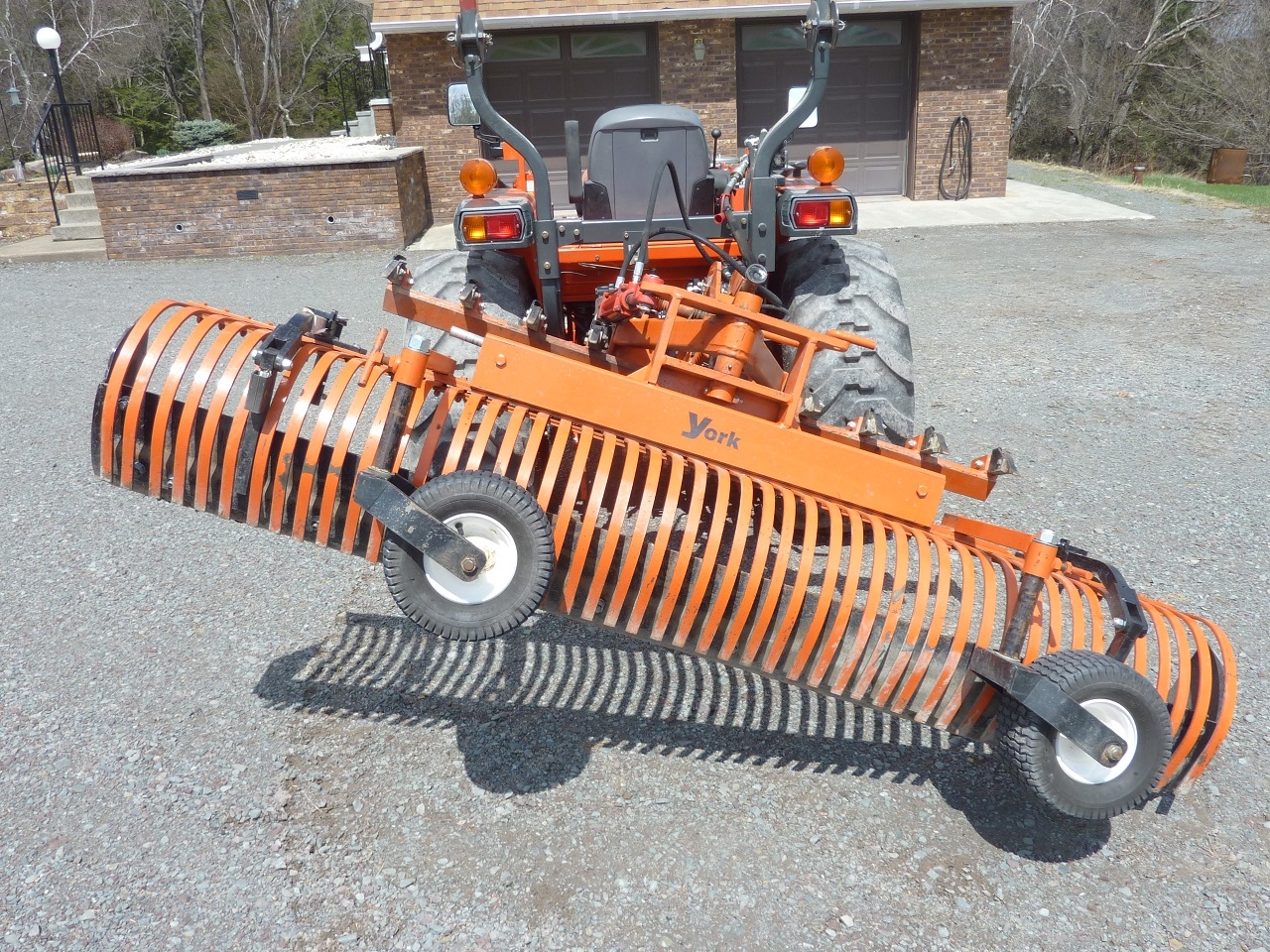

View attachment 826825 View attachment 826824
View attachment 826826 View attachment 826827
Nice York rake. They are definitely a cut above most of them. If I was buying a rake with your money I would get one just like that :LOL:
/ Any experience with a landscape rake? #26
I wish I had spent the extra $$ and bought the York in the first place before busting up two cheapo models. I've been using it hard for 18 years now and it's been bullet proof.

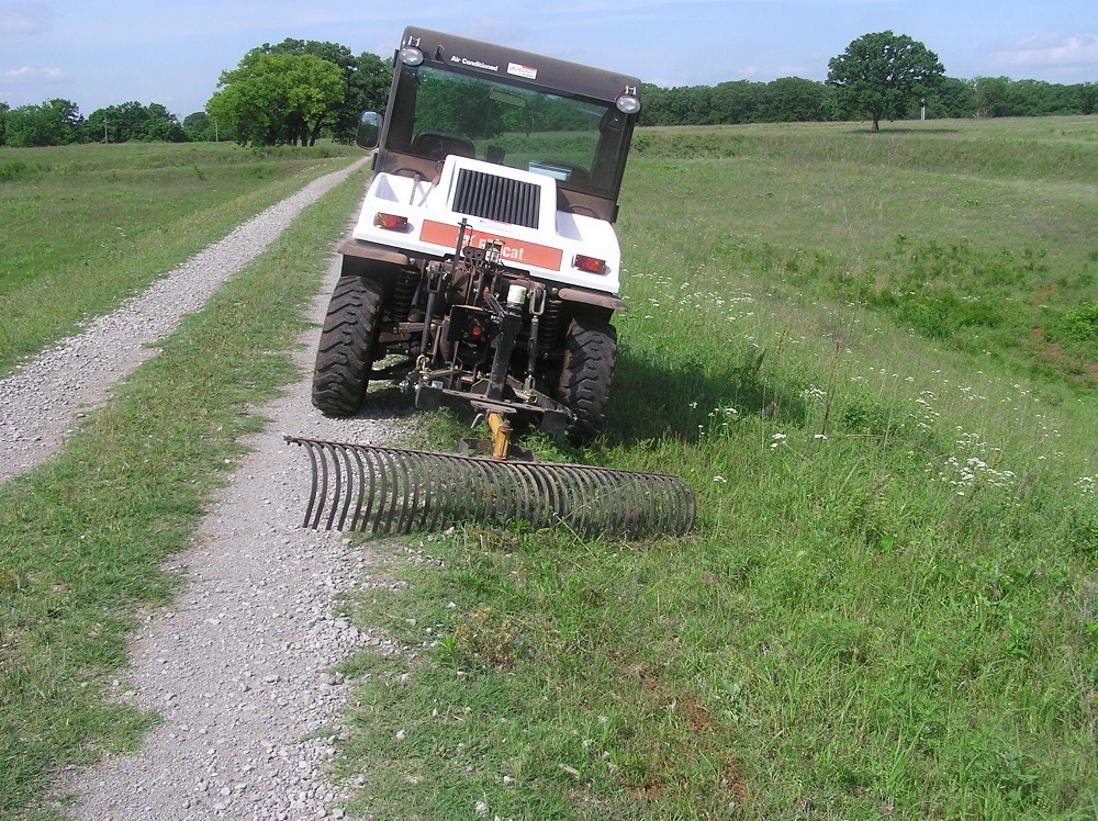

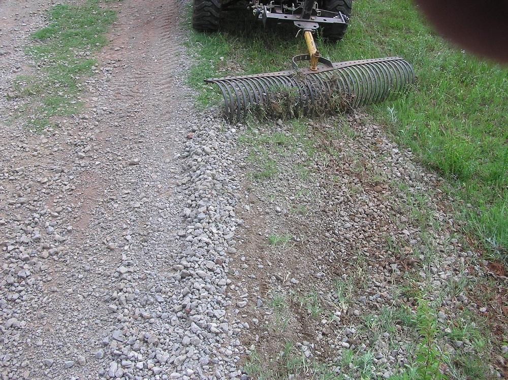

/ Any experience with a landscape rake? #34
Landscape rake works great. However once you get rocks built up it will start pulling dirt also. So make a pass to pull rocks into a pile, then you should remove the row of rocks from the field by hand most likely, then repeat. You will be done in no time. Then regrade the dirt that you pulled with the rocks.
I like to angle the rake and keep pulling the windrow over until it is 'too big'. Leave it and start a new. Or if a small area just pull everything to the center using the angled rake. Then if you are serious about rock and dirt separation scoop up the rows with your rock bucket.
I do this annually for myself as we grow rocks in our fire break areas. Done if a few neighbors who have barren horse pastures or turnouts.
Works well too if the gravel on your gravel road is all kicked off to the edges. The angled rake can pull and spread it all back into place.
