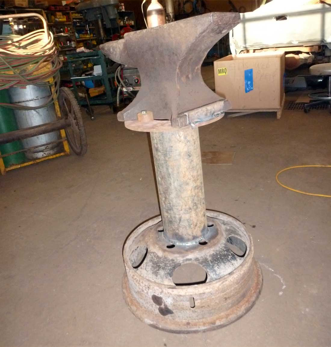

On Friday at work, I build this anvil stand. The anvil is quite heavy and I used a fork lift to get it on top. The rim is 40's truck vintage. The only cutting I did was via hand-help band saw to cut those angles and all parts seen were found in the lengths seen. I work at a metal recycling yard. :LOL: I should have put a hammer holding loop on it. I like to use rims so one person can roll it around by yourself. I've not used .045 wire before and getting to really like that size. What do you think of it?
/ anvil stand #2
Very nice. Looks a little tall though but I know photos can be deceiving.
How heavy is the anvil?
/ anvil stand
I believe its less than 200lbs. Its quiet old but in great shape. Suppose I should have put something in the photo to show its size, like a dollar bill. :unsure:

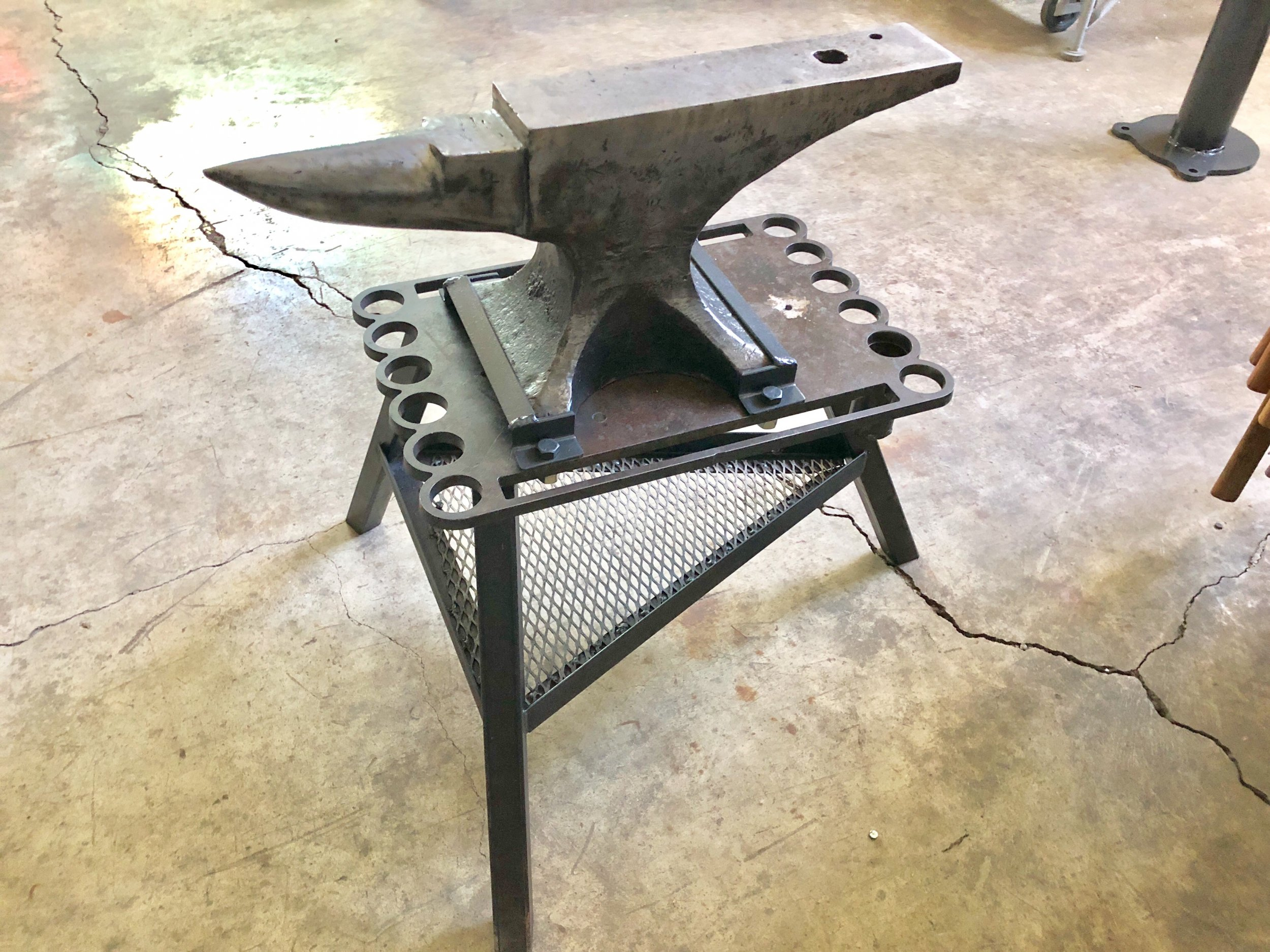

Looks good! Any plans to add some tool holders? I looked and looked for a nice anvil like yours, all that I could find were very expensive!

Typically the preferred height for a blacksmithing anvil is you standing next to anvil with arm extended and your knuckles just touch on face of anvil....
Other wise it looks good, glad you did not weld anvil to stand and only used clamping brackets....

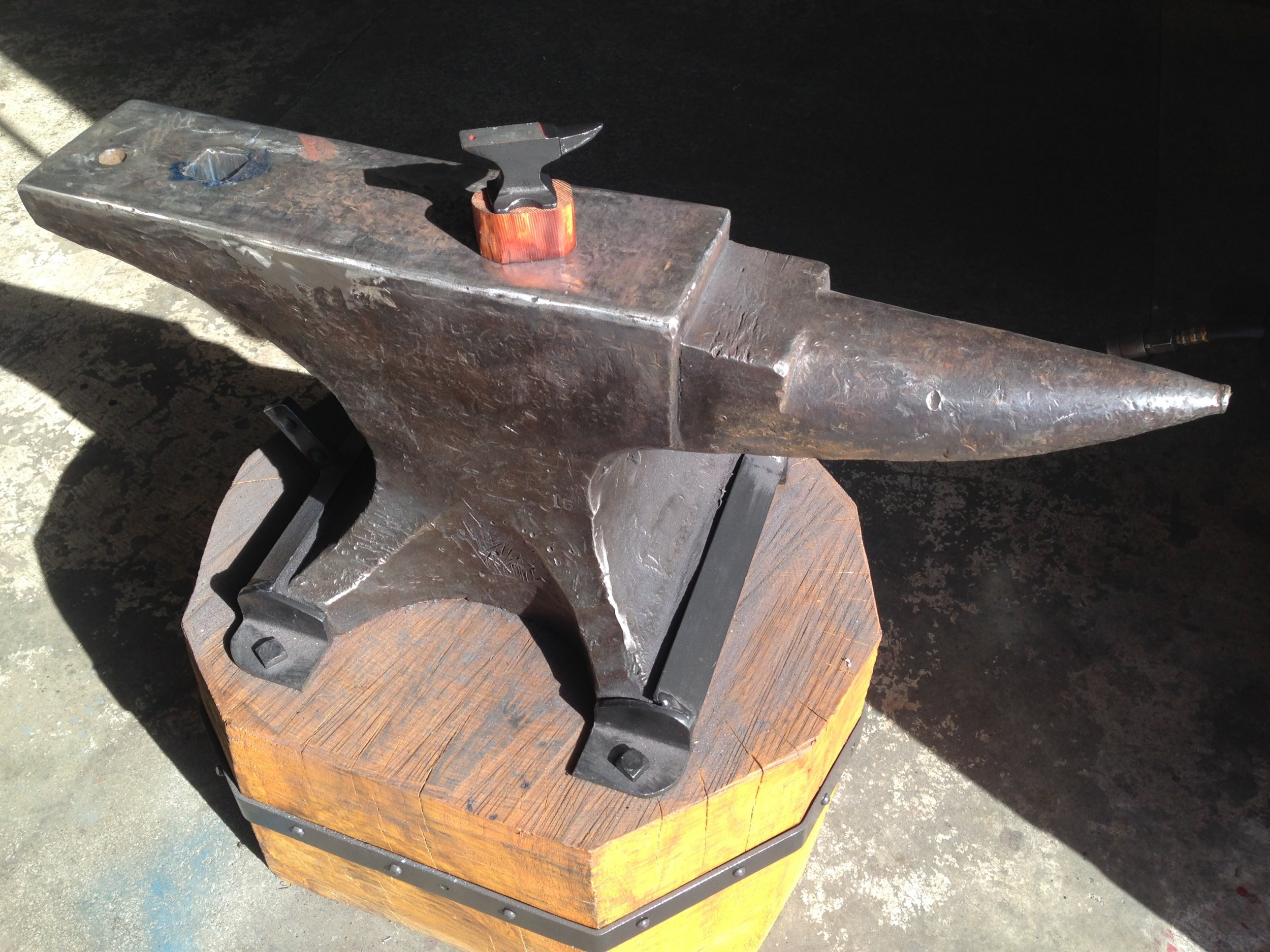

I always appreciate the work of people that go the extra mile to make an item look better. I would have probably just mounted it on a round section of tree and forego the Octagon shape and the flatbar retaining strip. Yours will sell at auction for a lot more than mine when it is my time to go, while both would have served us well during our lifetimes! David from jax

Ray, you do know its to heacey to lift, right? To move it you tip it a bit and rolls it on the rim lid.
The handle comment was of course a joke.
