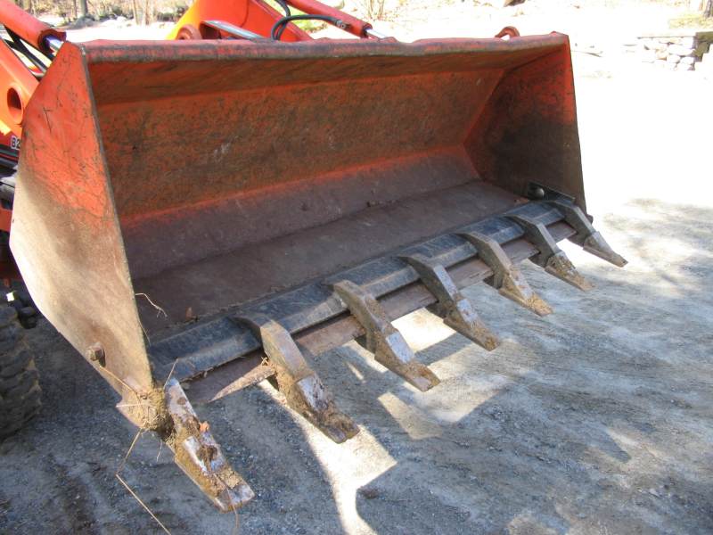

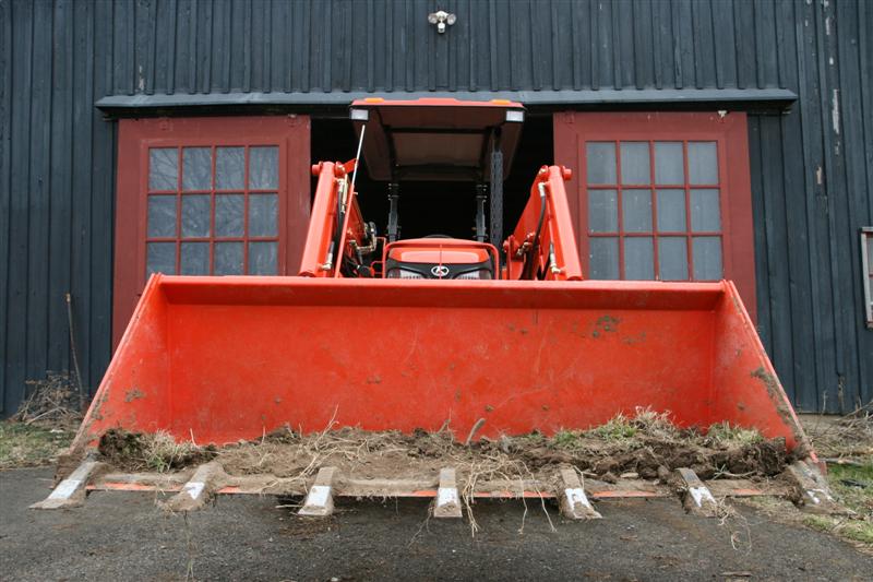

Sorry, but I didn't want to hijack someone's thread. I'm going to order a Markham for my 2800 463 loader. The inside dimension is 58 3/8". Will I be alright with the standard amount of teeth or should I have him add 1 or 2 more? I will be doing minor digging and popping out some briars. Thanks again guys.

I never even considered adding some teeth. I'm sure you could have it custom built if you wanted to but I don't think it would be necessary. Plus it would probably cost more. They would have to be more closely spaced. It may not be possible logistically. I don't know exactly how Markham constructs their toothbars but they MAY have stock sections of bar with standard spacing of teeth and just cut off the right amount. But I kinda doubt that. If that's the case you would have to pay a LOT extra for extra teeth. I just wouldn't do it. Mine measured 70.5" inside diameter and I have 7 teeth. You would likely have six and that would be plenty I would think. Besides, if you add extra the spacing would make it look kinda funny I think.

You will have either 6 or 7 teeth. Call them ask see what they consider standard, then tell them what you want when you order it and they will build it for you, at an extra cost of course. In my opinion, one extra tooth is not going to make any kind of difference.
My 60" bucket has 7 teeth and it is not a Markham.
