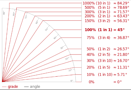

Don't get hung up on the % grade. Stick with degrees of angle. Many people over the years here on TBN have talked about 45 degree slopes and after interrogation and discussion, realize it's a 45% grade, which is only a 23ish degree angle. There's just been so much confusion regarding % grade VS degree angle. Grade really only matters to truckers and trains and up and down hills.
When you're traveling across a hill, you aren't moving up or down, so you arent' climbing or decending a grade. You're traversing a slope and leaning at an angle. Anyhow, call it what you want, just be sure to remember the difference.
13 degrees is not very much at all. Traveling up and down it should not be a problem. Across it shouldn't either, but if you put a load in an FEL and raise it too much, or a backhoe angled down the hill, or hit a hidden dip or groundhog hole, then your center of gravity or tilt angle can change rapidly and over you go.
Stand 8' back from an 8' wall. From your feet to the ceiling is 45 degree angle.
4' up the wall is about 22.5 degree angle.
2' up the wall is about 11.25 degree angle.
So if you think about it, you should be able to drive up 2' high in 8' forward pretty easily.

That might be the best example I've seen on here, making very easy for anyone to picture. Like you said earlier there's been a lot of confusion over grade/slope/degrees.

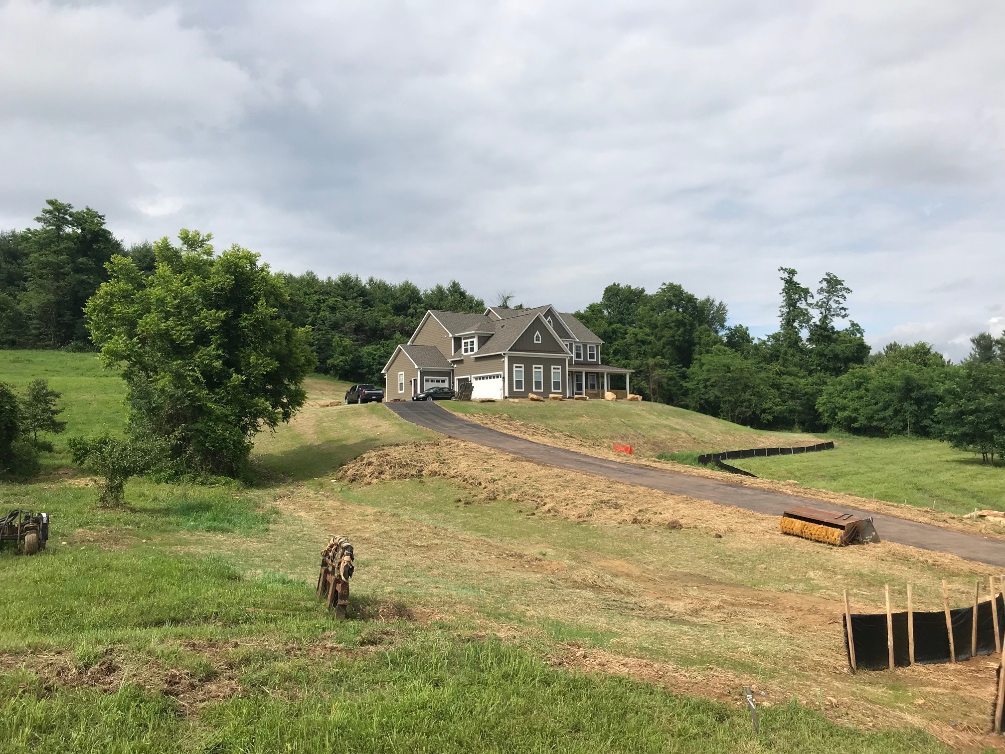

According to the angle app on my phone by holding it on the roll bar this hill is 17 degrees. It’s child’s play for my grasshopper. That’s the equivalent of bragging that your loader lifted 3 bags of cement. IMG_4349.JPG

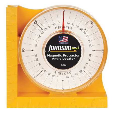

The iPhones have a level built into the compass app that can be used as an inclinometer. Swipe your compass to the left to see the level.

Well, you can see that I have a nice variety of slope.
That hill in the front looks steeper than my claimed 17 degree slope with near mandatory sideways mowing. Maybe being a good bit longer makes it look steeper than my hill. I think you dealer is blowing smoke that a BX equivalent would be better than a B equivalent. Sorry I’m not familiar with JD terms. Believe I’d look for orange with that dealer anyway.

Nice looking house and property layout. It would have been good to know early on that you're actually a contractor and not just having a home built - as typically a contractor has familiarity with equipment in general - and may have other uses for the tractor too.
Looks from the outside like you do nice work.
However, only from the single picture you showed - the only steep slopes I could see that reminded me of ours are on the very far left side of the picture just before the woods - but those look to be up and down possibly instead of sidehill (I can't see behind your house).
Other than that one area I mentioned I could see - I don't believe you'd have any problems at all with a BX or my Massey GC 1715 or a B2601. Even a front mount Grasshopper would be fine on it I would virtually all of it I would think.

Thanks for the kind words Axlehub. I work for a national builder and years ago, I was the guy in the field building houses. These days I'm a corporate puke but I'm also cheap so I wasn't going to pay someone to do something I could do. I've built a couple for myself over the years but this one was a crusher with the weather over the Winter and the rock I ran in to during excavation. I can run a skid steer and back hoe but I'm dangerous so I leave that to the professionals LOL. There is going to be a lot of work to get this property to resemble some sort of yard. Since it was an old apple orchard, I intended to plant a bunch of fruit trees, put in a large garden, maybe some grape vines (this part of VA is "wine country").
I'm going to put my down payment down on a B2601 TLB tomorrow. With how uneven the property is at this point, I'm going for a RFM instead of the MMM. Of all the tractors I drove, this one seems to fit me the best. I'll post pics when I get it.

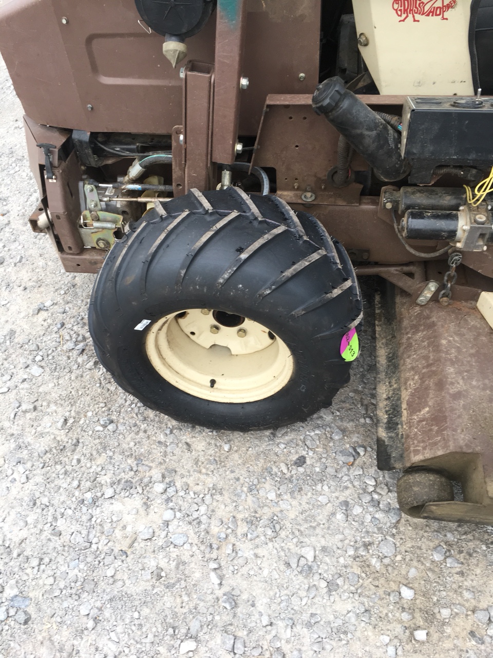

Turf tires on wet grass are a recipe for failure. Add in a smaller less capable zero turn with an inexperienced operator and it’s no wonder they have s bad rap. I put get something done tires on my grasshopper and being one of the widest models with plenty of ballast over the drive tires I stick with my original statement that a compact tractor will be on its side before my grasshopper gives up.IMG_4309.JPG
