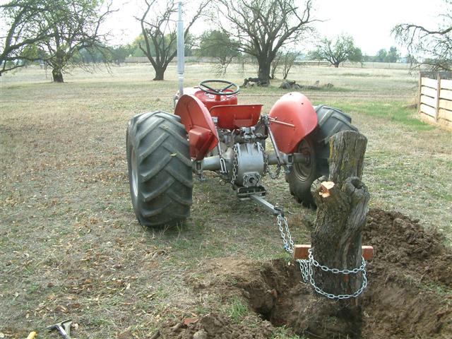

Or when eyeballing tractors for purchase, use the height of the rear axle centerline divided by width measured to the outside of the rear tires to get comparative data. That ratio should be 0.25 or less for stability.
For example, my 1964 MF135 diesel has a 0.24 ratio with those 18.4 x 16 inch rears on 16 inch diameter rims.
It helps that the 135 is a straddle tractor with an inherently low COG. When seated your legs straddle the transmission like riding a horse. Most modern tractors are platform designs where you sit higher with the soles of your shoes above the top of the transmission. That raises the COG. Case/IH has its JX series that it calls "straddle" tractors. Unfortunately, these tractors are a lot larger (60-95 hp engine) than CUT size.

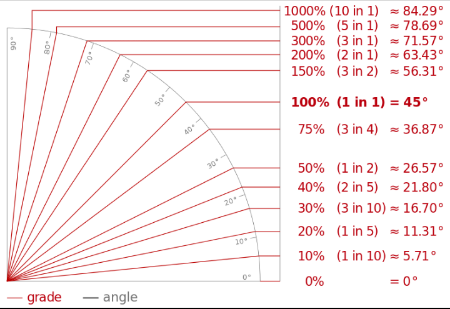

Have you actually measured your slopes?
Take an 4' 2x4 and lay it on the hill and put one of these $9.00 angle meters from Walmart (they sell them at a lot of other stores, too) on the board and get your actual angles in many places around your property.
Also, you can get a topographical map of your place on-line for free that should show 5' changes in elevation. That'll help you locate the most likely steep places, and you can physically check them with your board and angle meter. ;)
Here's a link to free topo maps from the gubermint.
TNM Download
/ Another slope application question #17
Can also take a 2x4 of known length ("run"), a level and a tape measure. Hold board level with one end on ground and measure distance to ground on other end ("rise).
/ Another slope application question #18

That's one of the reasons I like to use a 4' board instead of an 8' board. There might be holes and dips the 8' would span. Heck, a 1 foot board might even be better. It's the unseen hole or dip on the side of the hill that'll surprise you. Like a groundhog hole, for example.
