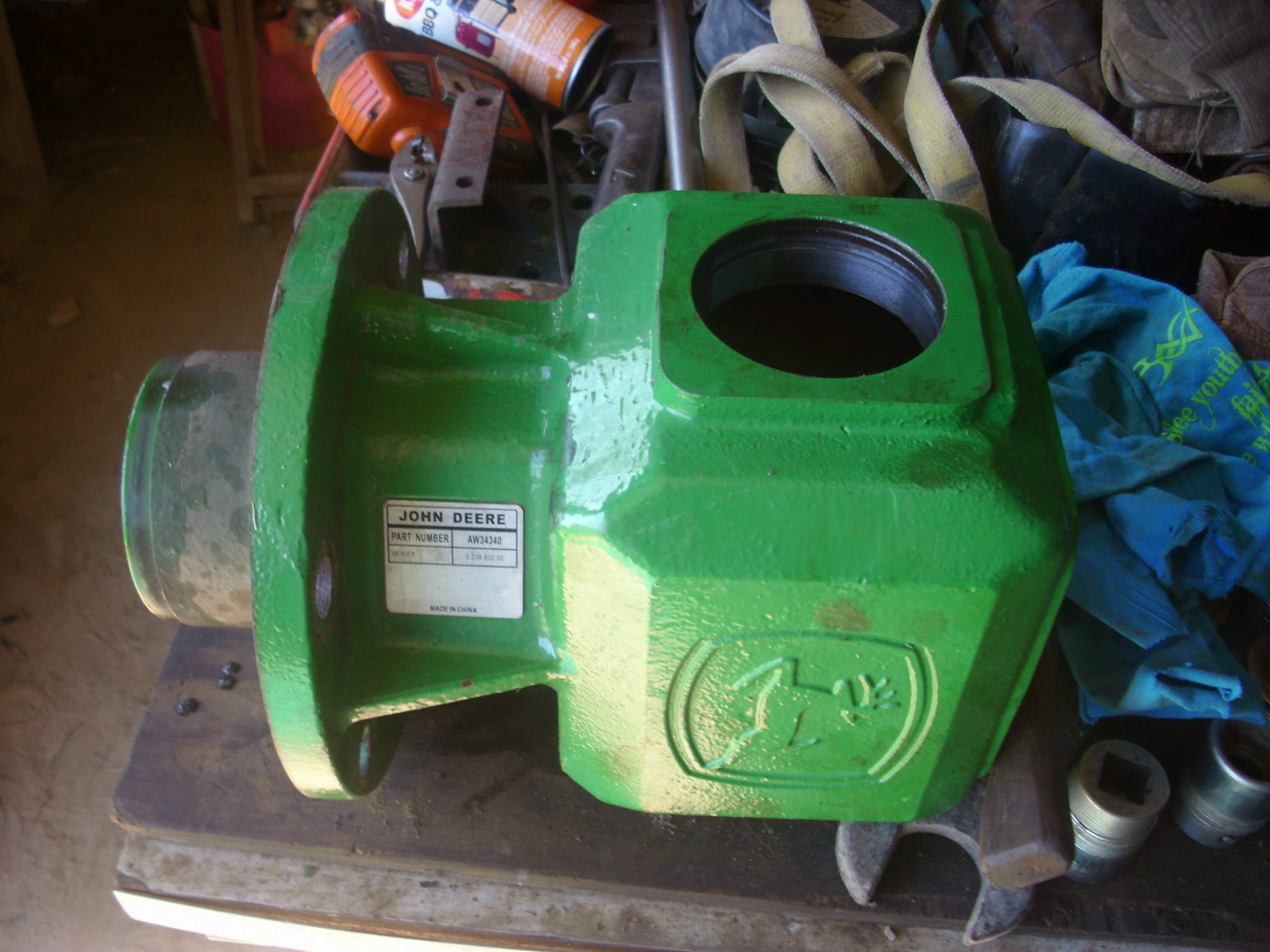

Guys- anyone have an idea if in fact the MX-5 box is same one?
JDparts shows them as the same for MX5 & MX6, there are three different ones, but all are for both MX5 &MX6, likely each is a change from previous one. Different serial number ranges.
/ Another MX6 Brush Hog Failure #42
Thx Z-5. Spent 10 minutes on JD Parts this AM and could not get "MX-5" to come up!

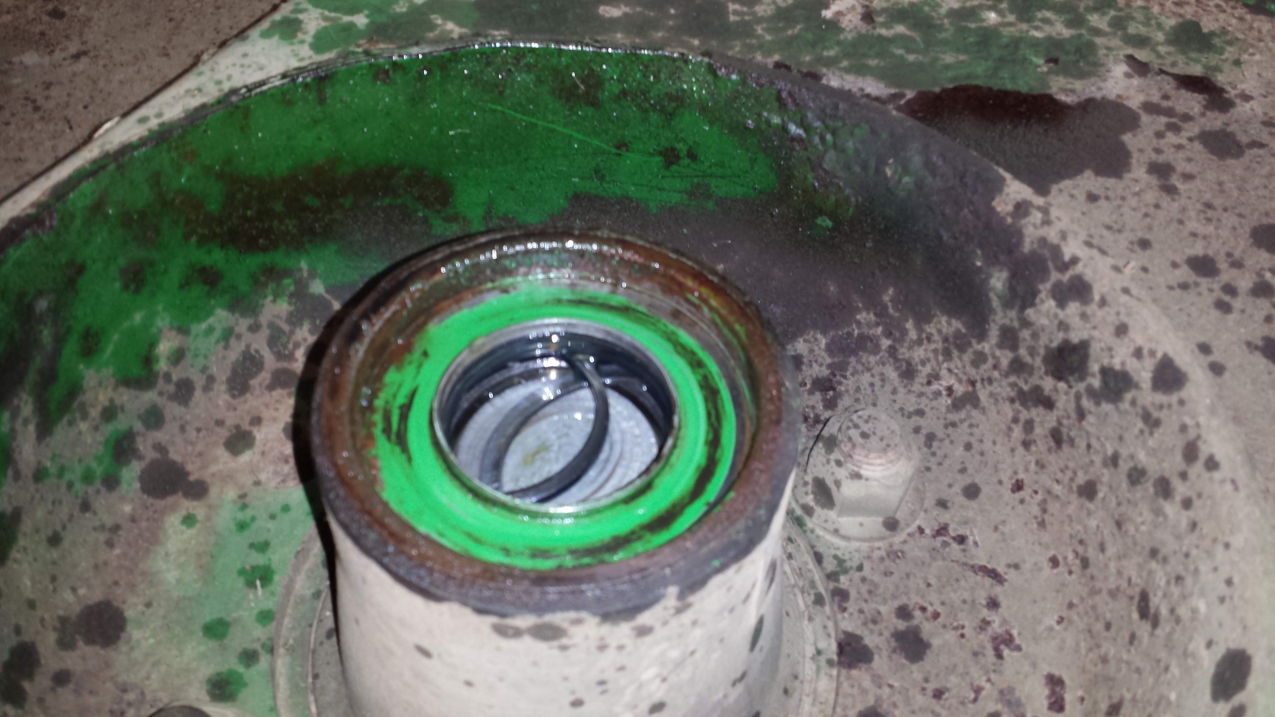

Clearly I'm late to this party but I am in the same boat with my MX-6. Mowing on a flat field and the shaft just sheared in two. My gearbox was made in Spain, at least thats what is on the outside of the box. Don't know where the internal parts came from. My local dealer where it was purchased was nice enough to talk to but would not help out with any of the replacement or fixing. I got the same quote....$1600 for the new gearbox but was told I also needed a new blade mounting adaptor. Total $2000. To fix a "John Deere quality" mower that probably didn't even have 100 hours of use. Very poor customer support, but clearly Deere is big enough to simply not care.

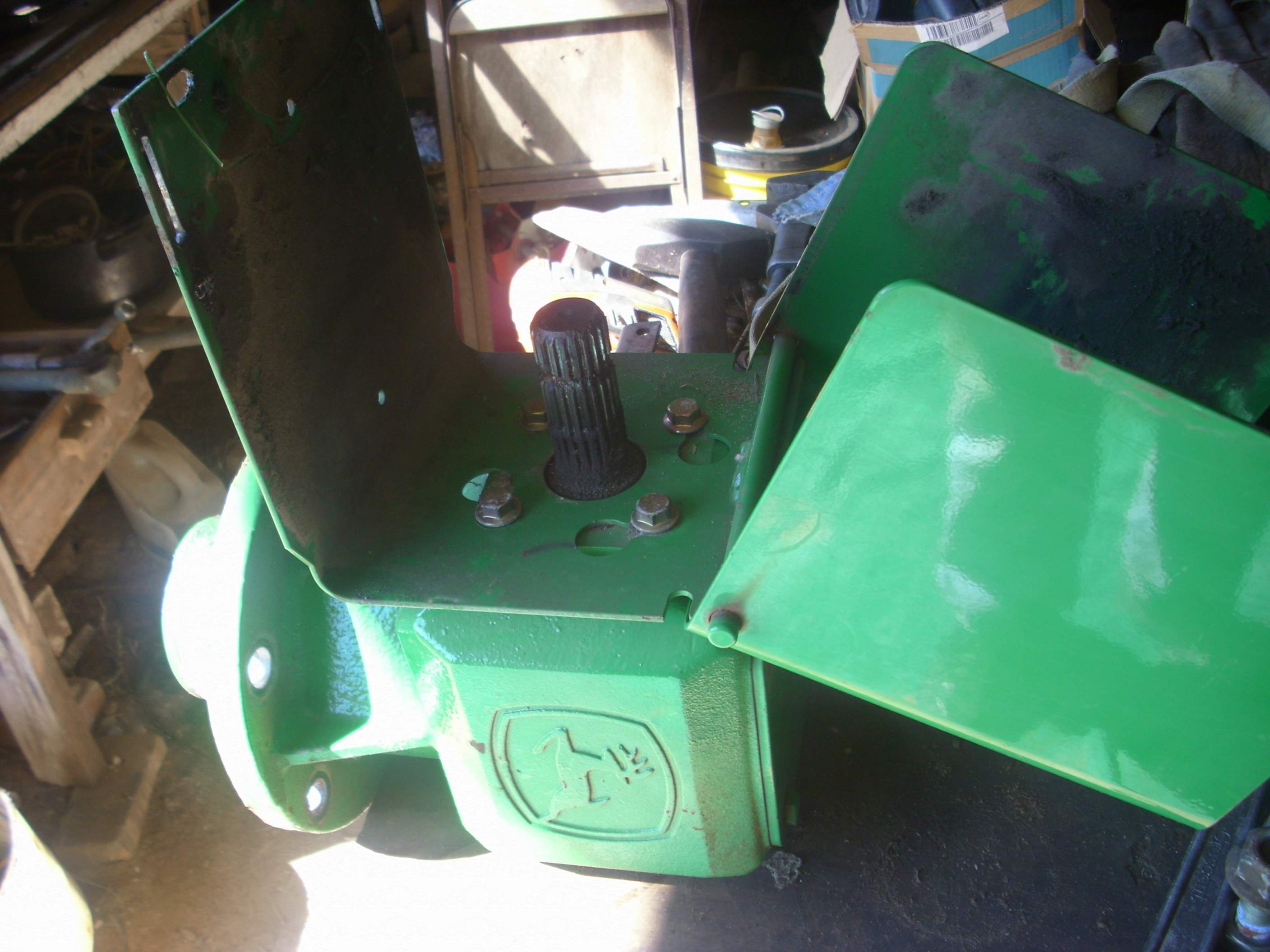

I found this old post that says the MX6 box has a longer shaft, my MX6 is still working but I am worried now that I see all the failures.
07-01-2009, 09:50 PM #1
8960_Miskin 8960_Miskin is offline
New Member
Join DateJul 2008Posts5
Default John Deere Rotary Cutter Gearbox
The output shaft broke on my MX6. Does anyone know if there is place anywhere that salvages mower parts or gearboxes? My research has revealed that any other brand of mower would accept a generic gearbox for around $350-$400, but being a John Deere with a double hull I cannot use the generic gearbox because the output shaft is too short. The shaft alone is $450 from John Deere. The gearbox looks to the the same as those used on the batwing mowers as well. I have been mowing brush with a 6300 so I think I am overworking the mower a little. If I could get a heavier gearbox off a bigger mower I would do it. Thanks in advance for any help.

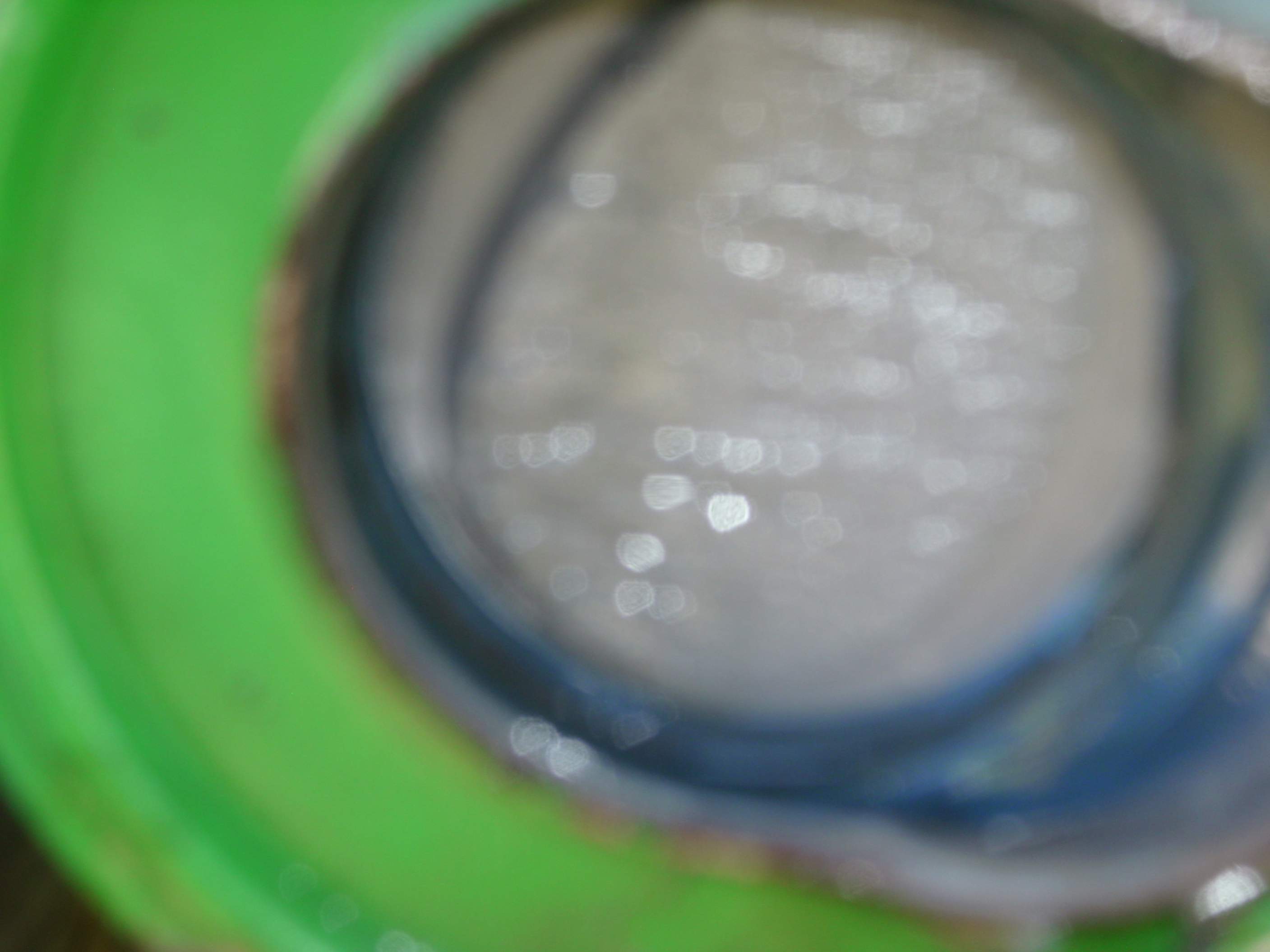

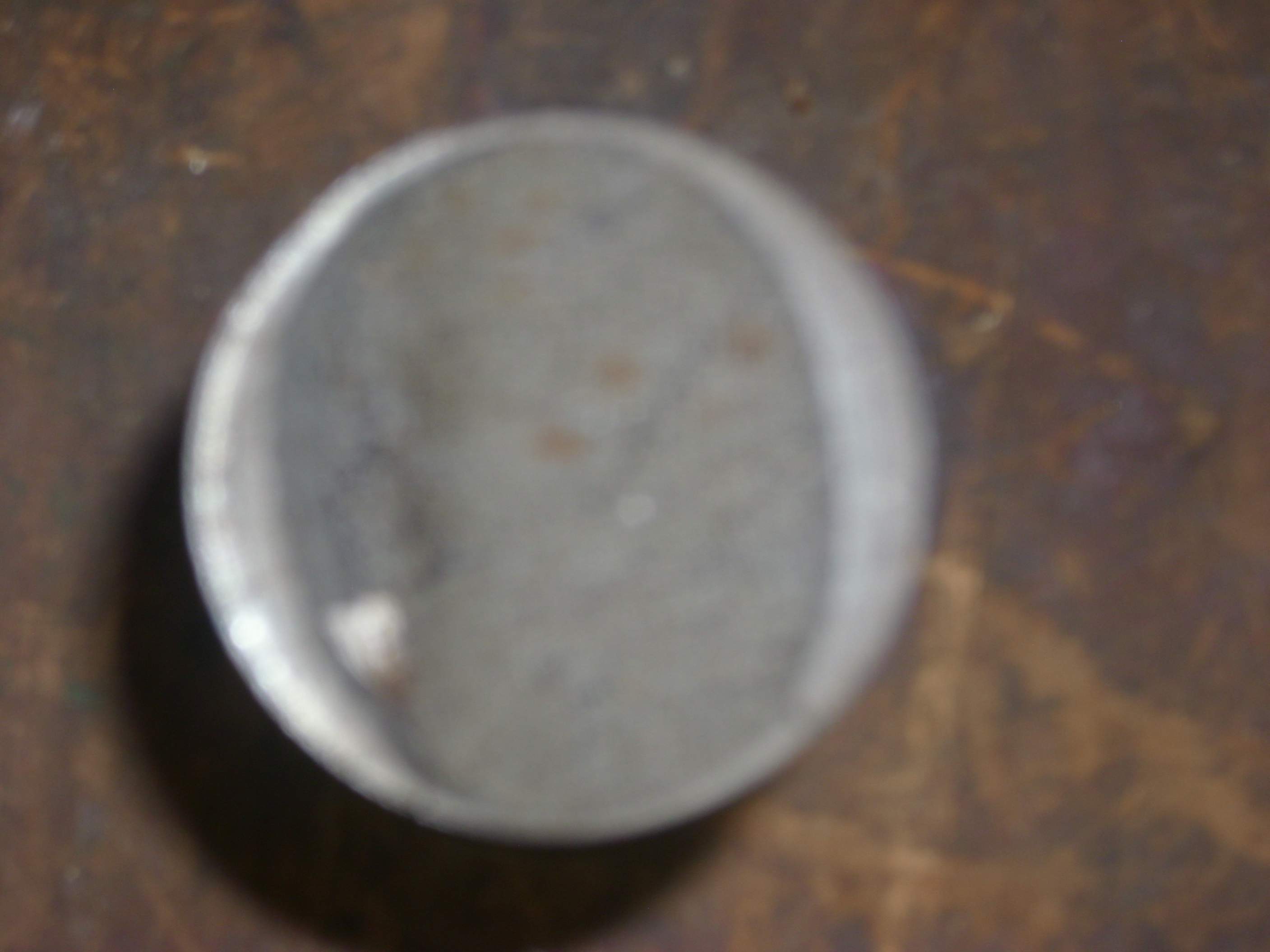

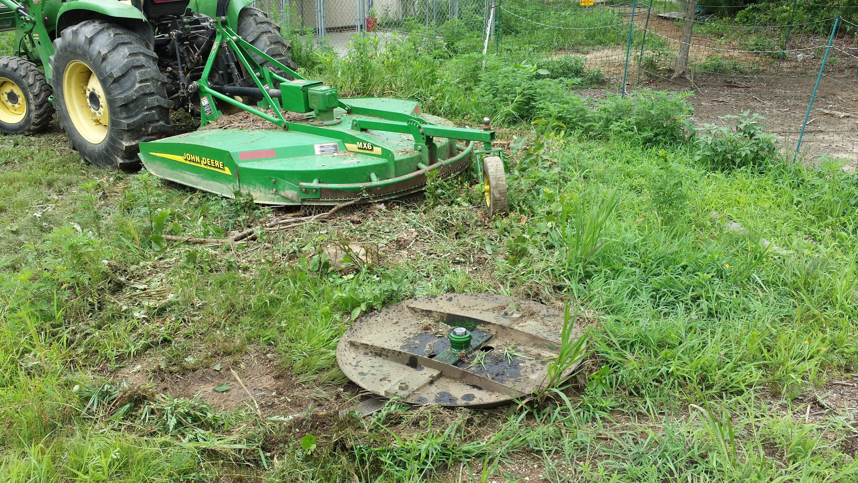

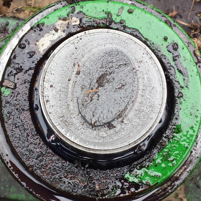

Mine just failed yesterday, The output shaft broke right in two. It's an '05, but it has +/- 100 hrs on it. I hit a low cut stump in tall grass and done. 2014-07-16 14.16.19.jpg20140716_141333.jpg20140716_151430.jpg
/ Another MX6 Brush Hog Failure #54
Curious, but was the slip clutch adjusted before this seasons' cutting began?
Reminds me that I should do just that on my 513 rotary cutter. Something will break if the slip clutch is rusted tight and won't slip when hitting a stump... and I hit several yesterday along with a 15" diam boulder that I coughed up and couldn't get off of fast enough.
/ Another MX6 Brush Hog Failure #55
Mine just failed yesterday, The output shaft broke right in two. It's an '05, but it has +/- 100 hrs on it. I hit a low cut stump in tall grass and done.View attachment 383134View attachment 383135View attachment 383136

I don't see JD "greed" here. I do see trying to mow down a stump. And doubt the IH med. duty mower would handle it either. :)
/ Another MX6 Brush Hog Failure #57

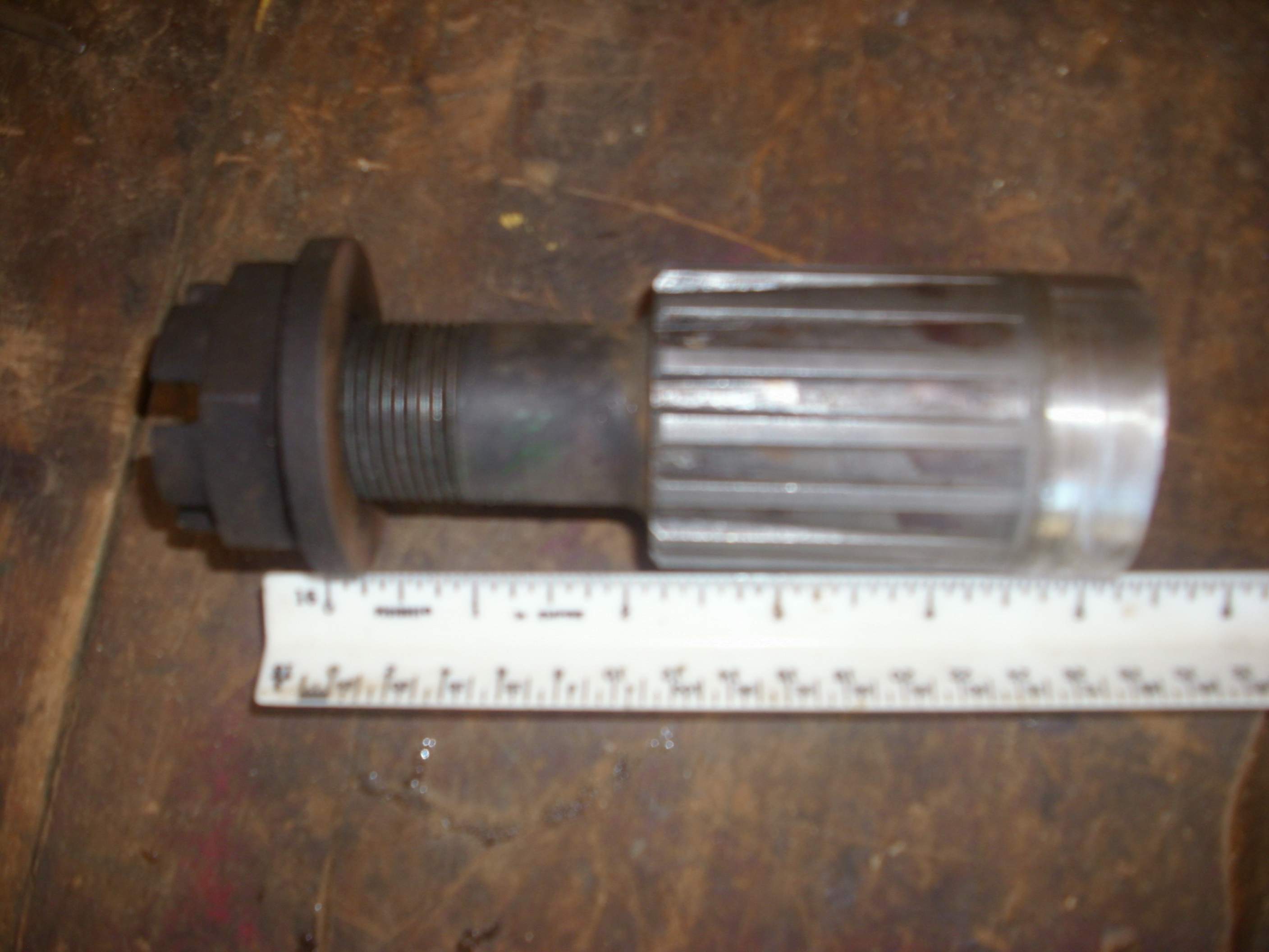

beenthere. Look at the shaft where the cut for a lock ring is ground into the shaft. Some said the Spain gear box were at fault
a box from China was used. same design fault.

I wasn't trying mow the stump and it is cut pretty close to the ground. I believe the slip clutch is ok, adjusted properly. Looking at the shaft, I feel like what ever I hit then would have been the demise. I had a 4300 with an MX5 previously, and that thing was pretty much bullet proof. I have no idea where that gearbox was made.
JD told me the new gearbox would be $2600, and I'd have to change the stump pan as well @ $200-250...
