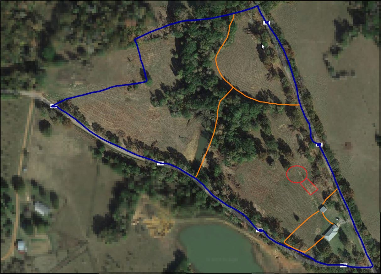

Here is the scenario:
Recently bought a 21 acre Hobby Farm/Ranch in East Texas (Elkhart, Grapeland area) and need to look for a tractor to do the following:
Mow
  • Front Lawn has some Elevation, about 1 acre
  • Back Lawn has about 3/4 acre
  • Back Pasture has about 10 acres of mixed vegetation and some brush to wack down
  • Side Pasture is about 3 acres but is rolling
  • Far back pasture is another 5 acres
Farm Duties
  • Move Round Bales
  • Turn manure piles
  • Food plots for deer
  • Help move logs and clear out timber
  • Light grading work (neighbor has large tractors and can help
  • Drag Horse arena
The options are a bit overwhelming as to what to prioritize first. In all of my research it seems that mowing with a brush hog isn't a big deal if you do it often, my "lawn" isn't exactly a golf course and I can eventually get a zero turn once it is restored.
I have some elevation changes on the property, about 60' overall. In the middle I have a creek going across it. Thus I'll need to put in a small bridge across the creek to get to the back of my property or drive down and around the road (will do that to start). As my primary use is mowing, horse property maintenance (no more than 10 horse and maybe a few head of cattle), and hunting support I think I am fine in the Compact tractor size with a competent loader.
In looking at the conditions I think a Cab would be nice, but that tends to push me into much more expensive category.
Budget is as everyone else, not unlimited.
I have experience operating most anything Class 1-6, race cars, bikes, ATV's, UTV's, and skidsteers. Never driven a tractor actually.
Planning to pull the trigger and reporting on findings throughout this process, I think I'll need something by the end of February/beginning of March.
I seem to have every possible dealer within a reasonable drive, some are closer (20 miles) than others (70 miles), but I am willing to drive if it saves me substantially as I am very handy/ I've just never owned a tractor (or a property this big).
I've attached an aerial shot to really show what I am working with. Fence is all around most of the property (blue), and the orange represents the pasture splits. The "side pasture" has the mouse arrow on it, Orange and "up" on the picture is all fenced in.
Red square and circle are future barn and riding area's, probably not to scale as I put this together quick.

Calculate how much time you want to spend mowing and we will tell you how much PTO horsepower is required. Twenty acres is a lot of mowing.
LINK: Mowing Calcuator | How many acres can I mow in an hour
Are you retired so you can peck at your tasks as weather and energy permits, or will you have to do everything during weekends and work breaks?

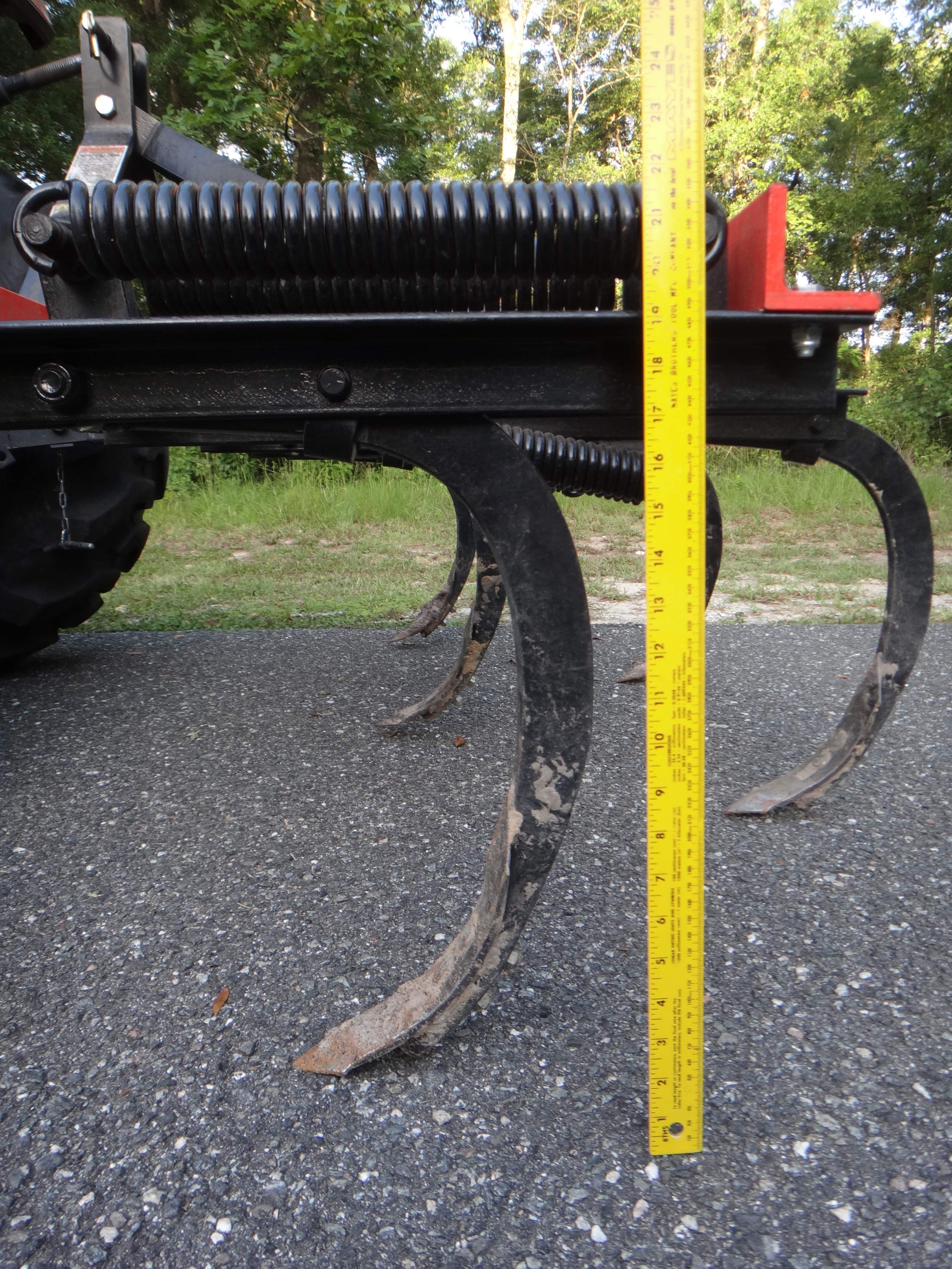

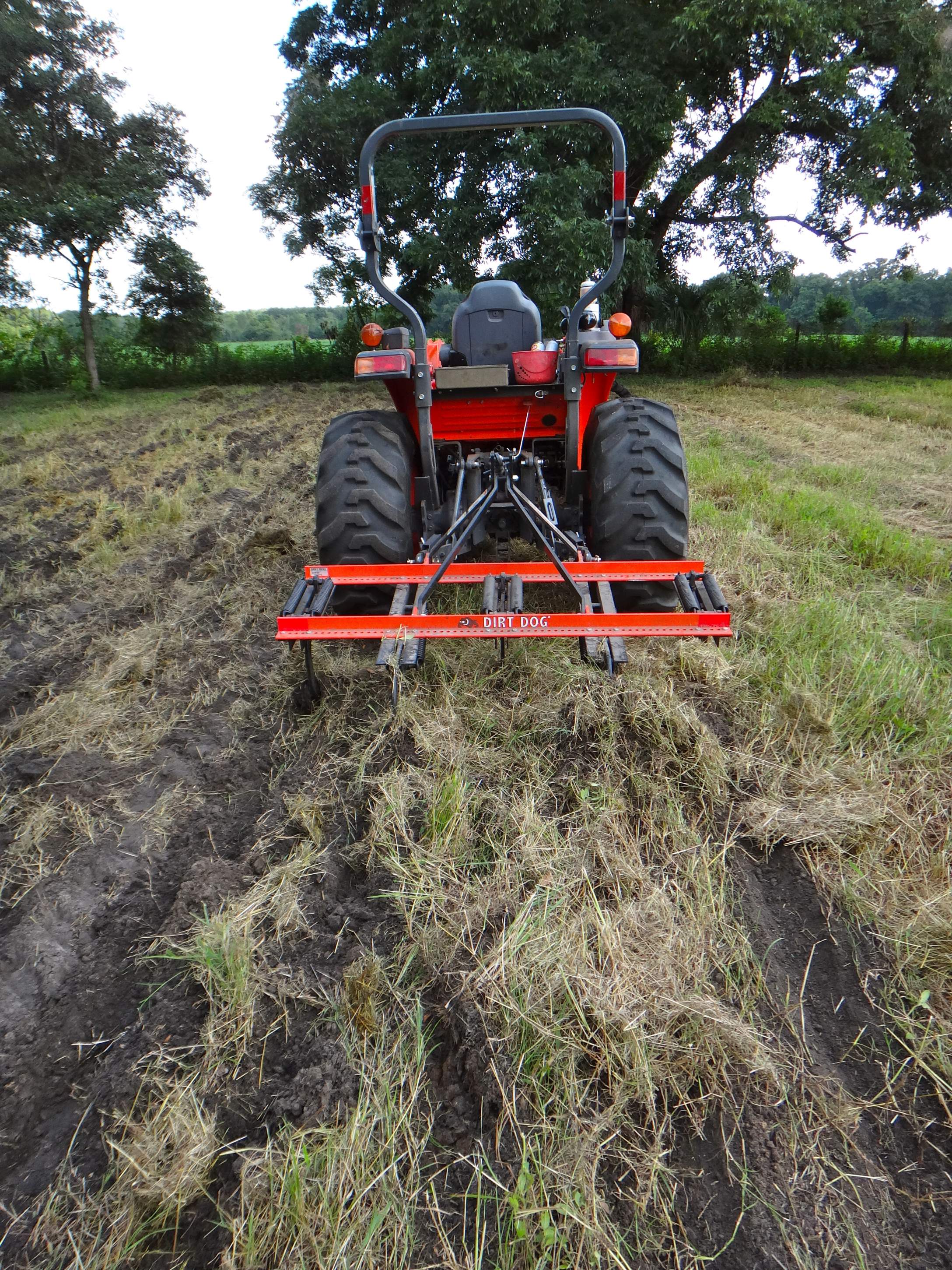

I would add periodic pasture aeration to your list of farm duties. PHOTOS.

It does look like I will probably want 2 pieces of equipment, used lawn equipment and ideally new tractor.
Due to the rolling nature of some of my "hills" probably a riding tractor for the lawn and dog area and a tractor (most likely with a cab) for the fields/pasture work.
The hay work is intending to be on the flat part of the property. Barn will be "up" on the flat and that is the same elevation as the side lawn/driveway/road.
I really do appreciate all the advise and links provided thus far.
Here is another thought. Hay is very expensive here in Texas. I could set aside pasture land to grow Hay if I invested in the proper equipment up front.
