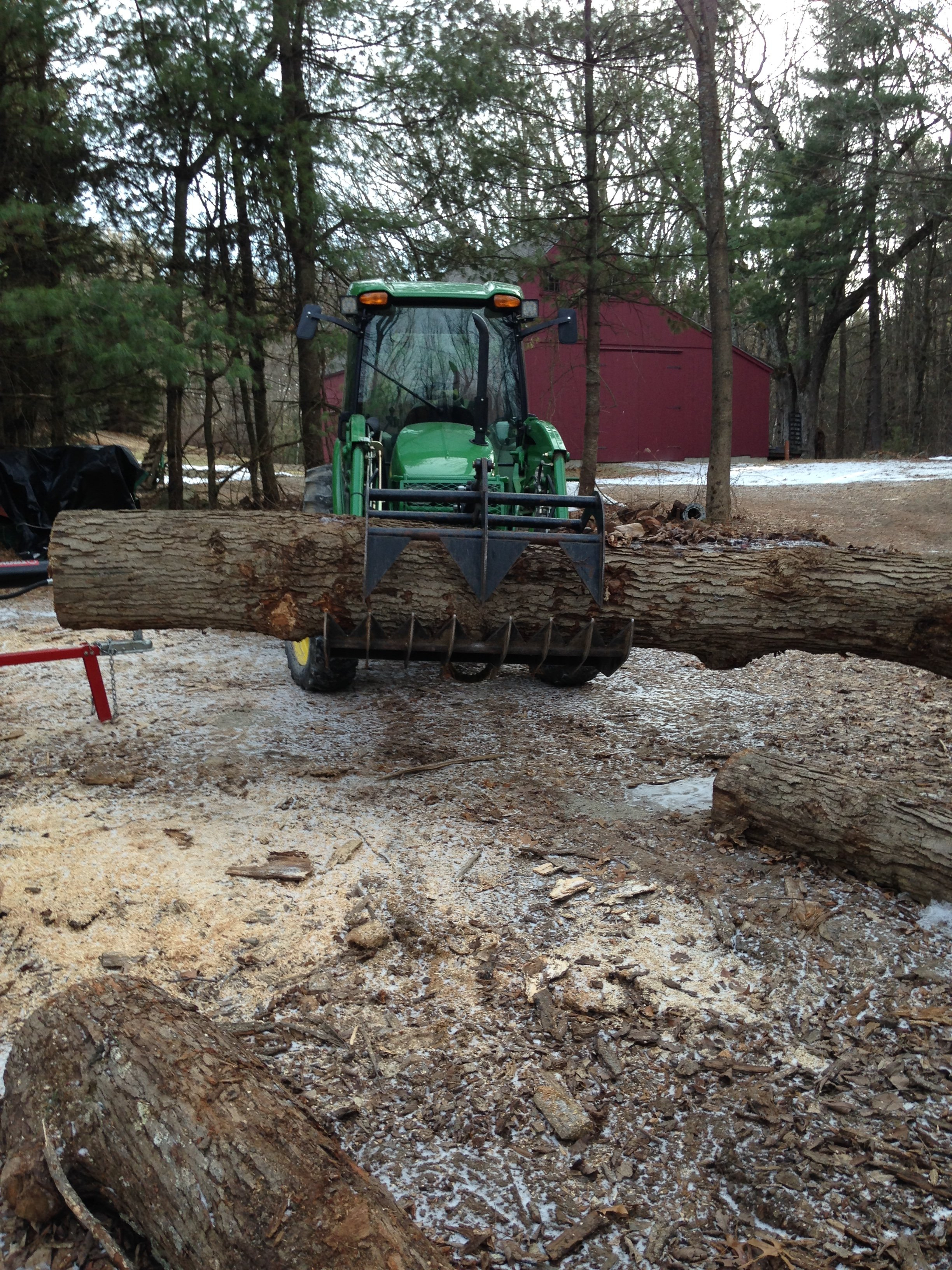

Well for what its worth I have had a 48" Wildkat Economy grapple. I got in on ground floor 9 years ago and paid 700 bucks delivered to Mass. Only issue I ever had was I was trying to "hog out" a buried bolder by opening all the way and digging with teeth while trying to roll back with grapple locked onforward edge of rock I cracked the welds where cylinder is attached to box beam. Cut a couple of 1/4" thick wedges and welded on-end of problem. As my avatar shows you can get a lot of firewood on it Like you, I use it for clearing brush as well as bucking logs. I'll take the weight savings (350lbs) any day vs lost payload with a heavier, wider grapple.

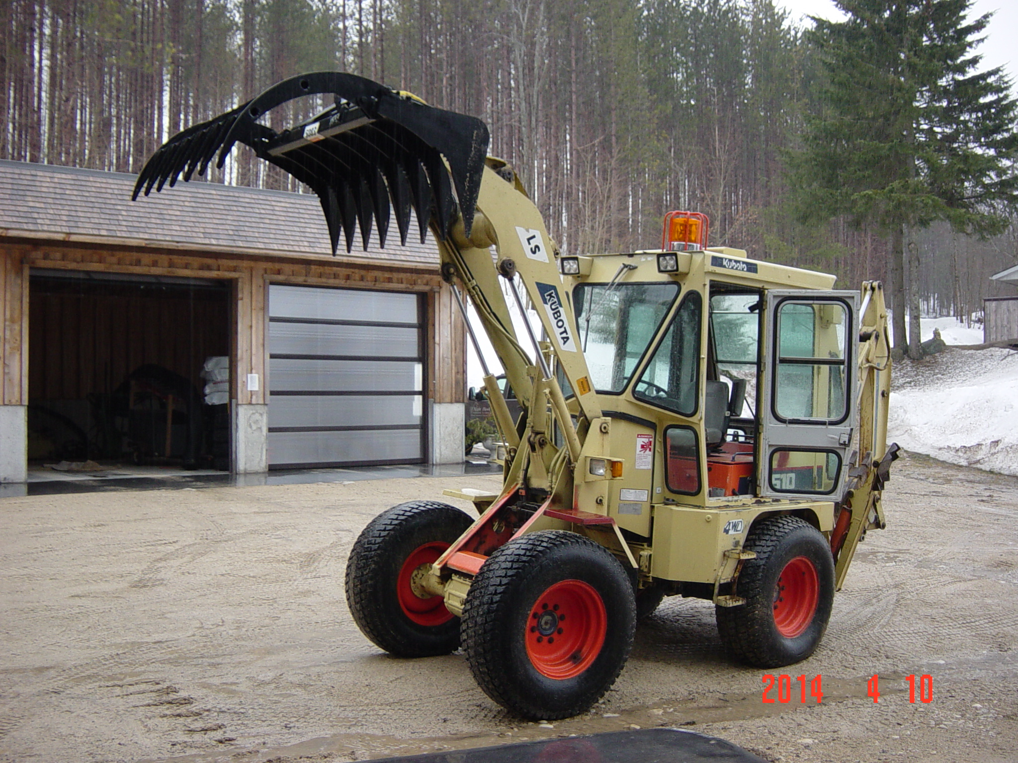

I bought this cheap, junky, no-name grapple off a guy (new) that he bought at a Richie Bros Auction in the states.
I have abused it, wrenched on it with long material and it has suffered zero for breaking or bending.
