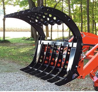

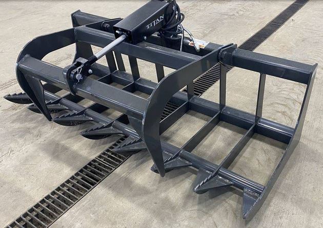

I am looking for recommendations based on using this grapple on Branson 3620h (36hp) 20 series hydrostat with a 2700 lb rated FEL. I am on a heavily wooded lot that I intend to work on opening up in select areas so I will be felling all sized trees and needing to either skid them out or pluck from the cut end using the grapple. I will also be doing a lot of heavy brush and branch clearing of stuff that is already dead and on the ground or that I will be cutting and pushing with the teeth of the grapple to get the smaller surface roots ripped up.
Initially I thought I would need the grapple with the longer lower tines and small single lid to grab a large load of brush, branches and tree trunks but the more think about what I want to do, the more I am leaning towards the smaller tine full sized top lid. These style grapples appear to allow better driving forward into the ground to rip out small roots and then be able to back rake with the top lid tines.
The EA 55 Inch Wicked Root Rake Grapple looks like a better choice over the EA Single Lid Wicked Root Grapple for Compact Tractors. I also will be using it to pick up medium sized rocks, sections of old concrete/stone walkway and various piles of random materials scattered around the property.
My dealer wants to sell me the Titan 66" single or double lid root grapple with the large lower tines but with the "V" shaped lower teeth. This grapple only comes with large upper teeth on the lid and it seems the back raking and plucking of rocks/walkway would be very limited but I would like to hear you experienced guy's thoughts about all of this.

I will say that the 240 pound Wicked 55 is the most popular, compact tractor maximizing grapple EVERY created!!
I'm glad to chat about it on the phone anytime, to help you or anyone else choose the best grapple for your tractor and application. 828-464-1200

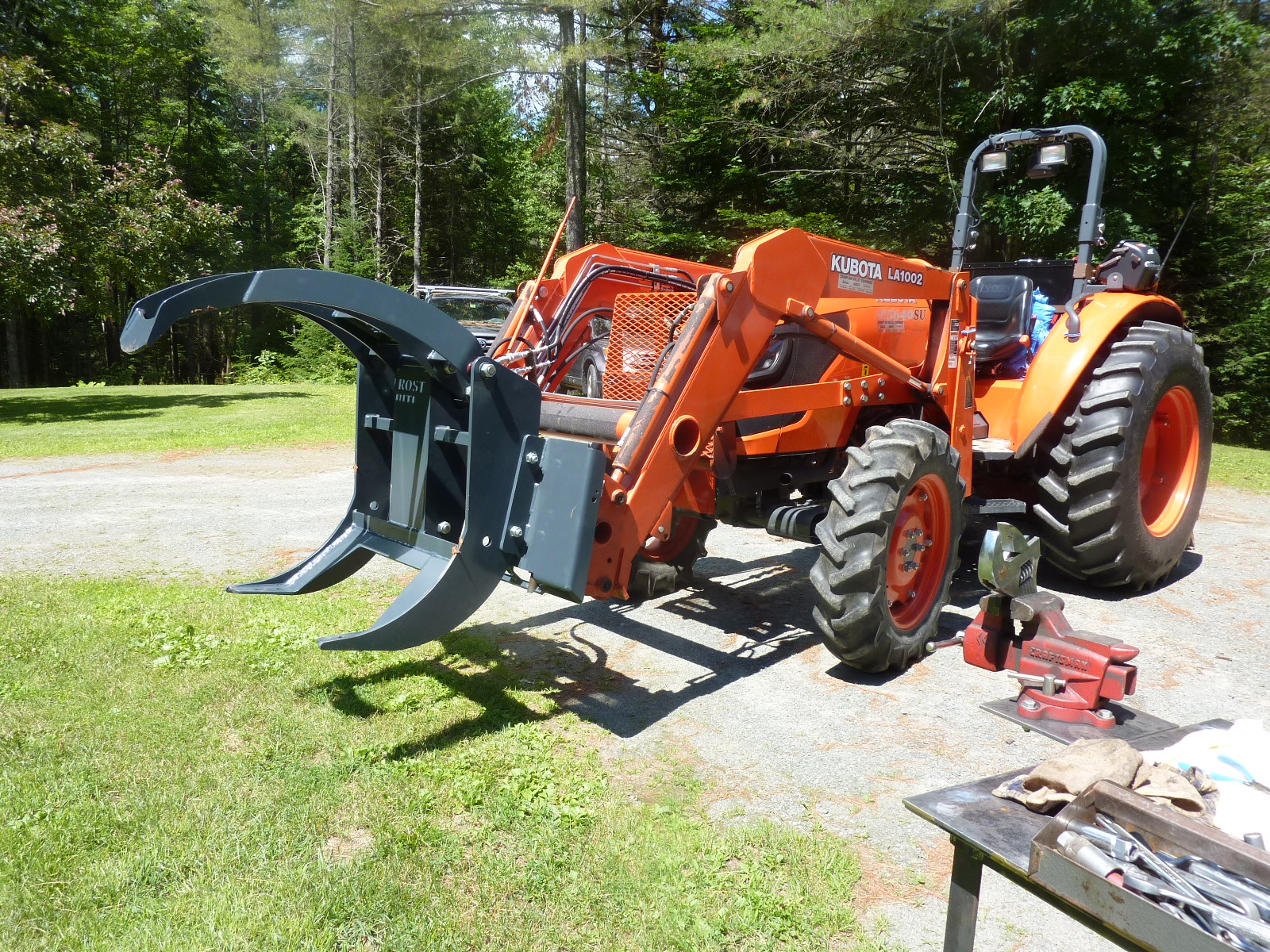

Seven years ago I went thru the process of - "which grapple". I have little need for a brush grapple. I do want to move large sections of pine trunk and dig out and move rather large rocks.
I purchased a Land Pride SCG1560 rock & root grapple. I had the dealer install the grapple and a WR Long third function valve. I took my OEM grill guard to a local weld shop and had that modified. It's been such a great implement - I've not had reason to ever reinstall the bucket.
View attachment 686694View attachment 686696

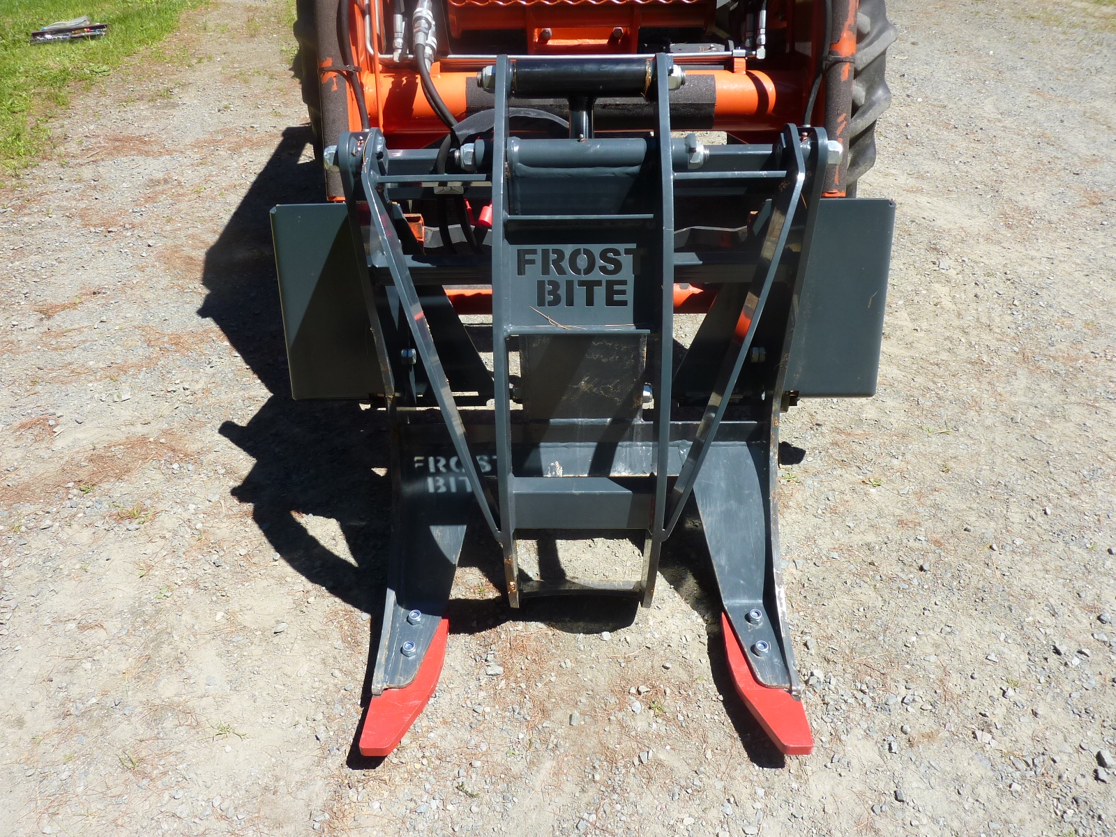

I almost went down that path, until my dealer suggested a Frost Bite style grapple (I got one made by Sundown). I was looking to move logs, and rocks. I am SO glad I got the style I did.
It's less than 1/2 the price of a clamshell type, and weighs about 1/2 as much (preserving your lift capacity).
As Gordon mentioned, maneuverability is key. Unless your log sits on a flat open space that is at least as wide as your grapple, you're going to have a hard time picking it up. You'll catch the edges of the grapple on high spots on the ground, rocks, or other logs. Or, you'll be forced to pick up the log using only one end of the grapple, risking torquing it.
When moving rocks (a major use of mine) the ground has so many rocks that I would never be able to get under one, without the edge of the grapple hitting, and getting hung up, on another one.
If you have wide open woods, this is likely not a problem. If you're like me and have dense, tight woods, with rocks everywhere, it will be a major headache.

Here's an example of what a frost-bite style grapple can do. These two piles of rocks were dug up out of an area measuring about 50 ft x 20 ft.IMG_20200824_172129.jpgIMG_20200808_130039.jpgIMG_20200808_130051.jpg
