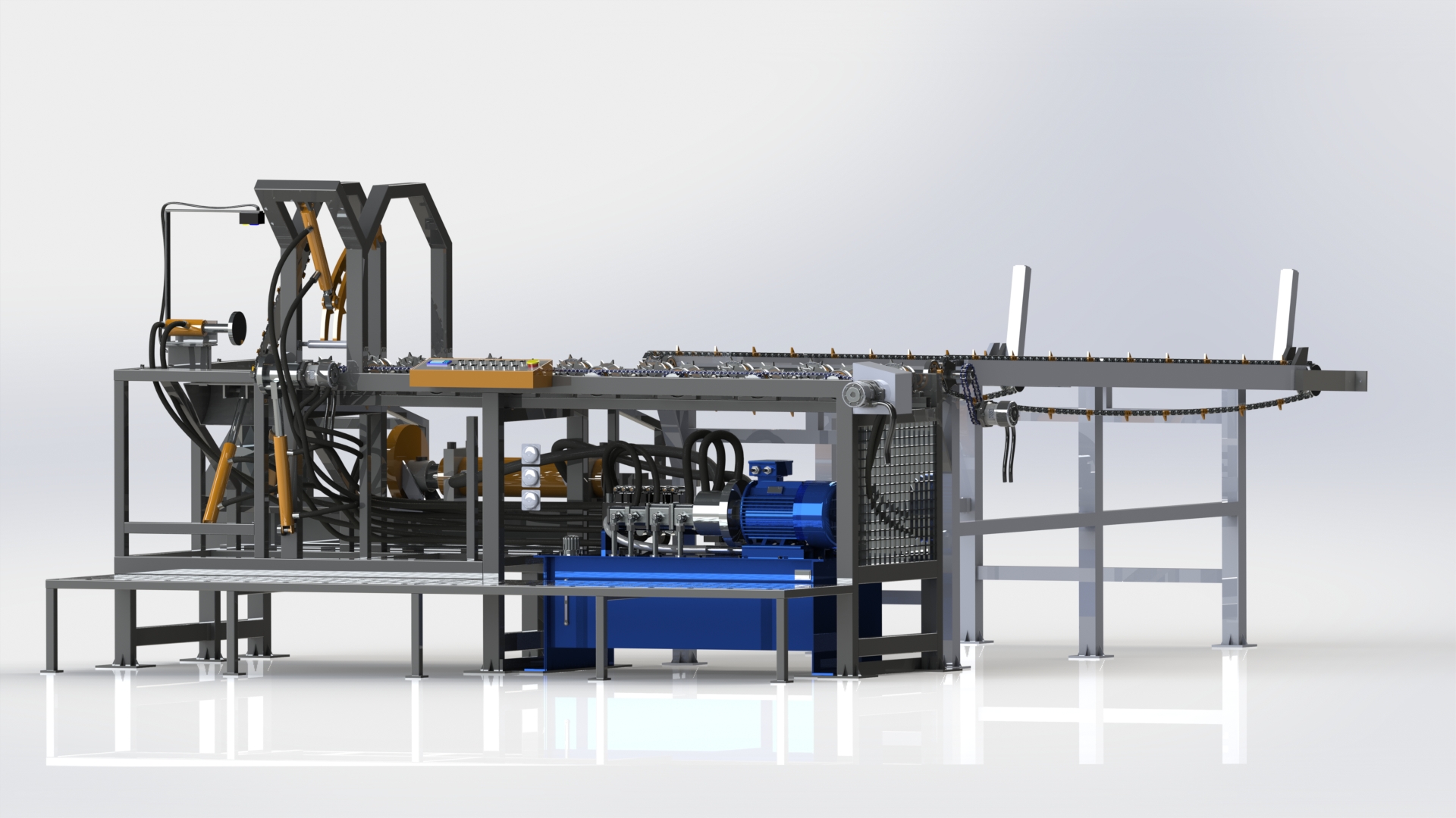

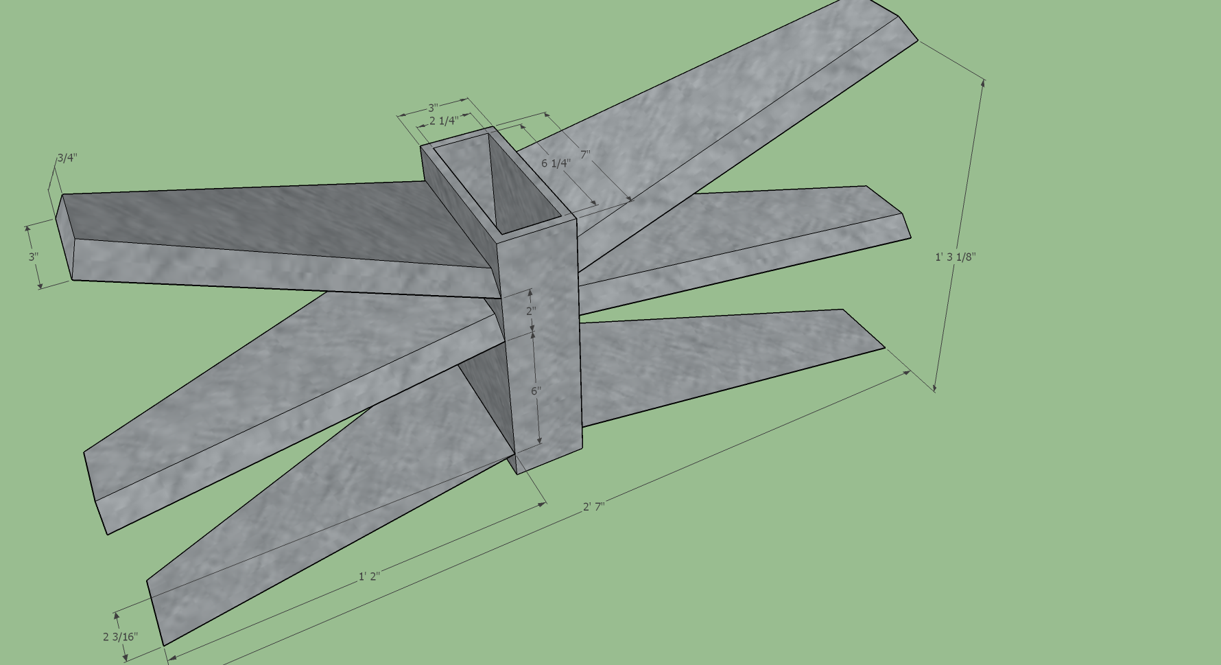

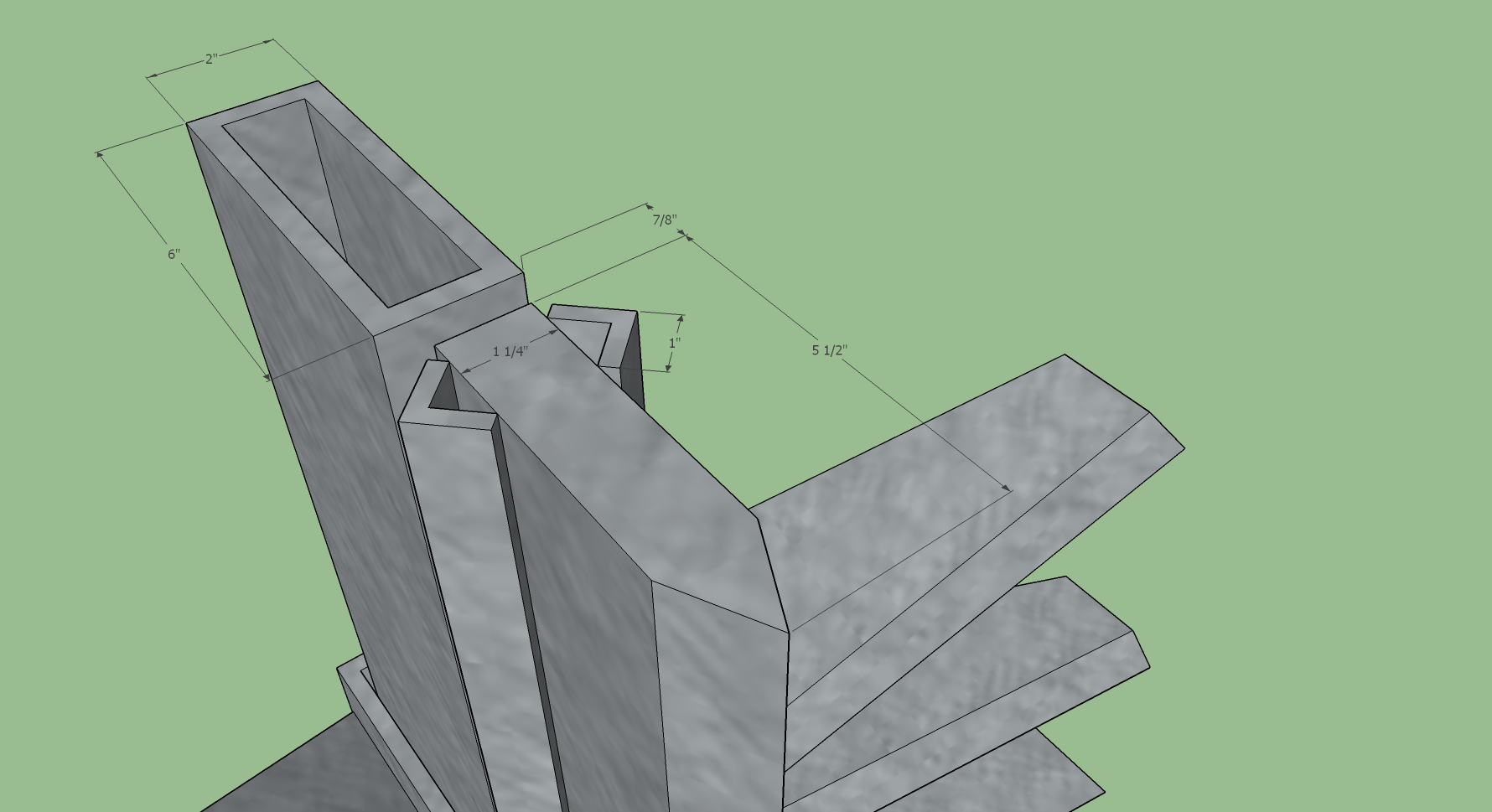

I don't know that I've really spelled out what we did since the design change moving away from the box.
Dimensioned images of the wedges are attached. The main wedge is 28" tall.
Status update: We got our last load of steel today. Next up, mounting the motors and pumps, mounting the valves, purchasing and running all of the hydraulic lines. Still need to fab the hydraulic tank too.
Some of the steel is to build the out feed flipper tray to split output between 2 pallets.
We have a motor for the out feed convener coming as well.

Thanks that is very helpful. I'm still gathering pieces and parts but I would like to start work on some of the parts that I have pieces for like the wedge, hydraulic tank, fuel cell, along with some other stuff like brackets for the pumps and motors. I got rained out the other day and I decided to start working on the wedge. I have a piece of plate that is 24" long by 18" wide and 1 1/4" thick that I was going to cut up and make the main piece out of but decided to wait until I could check some other wedge designs to get some measurements off of before I cut up this nice piece of plate. I'm planing on hopefully being able to get two out of it and maybe playing around with another configuration to see what else I could come up with.
