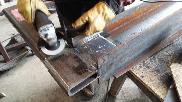

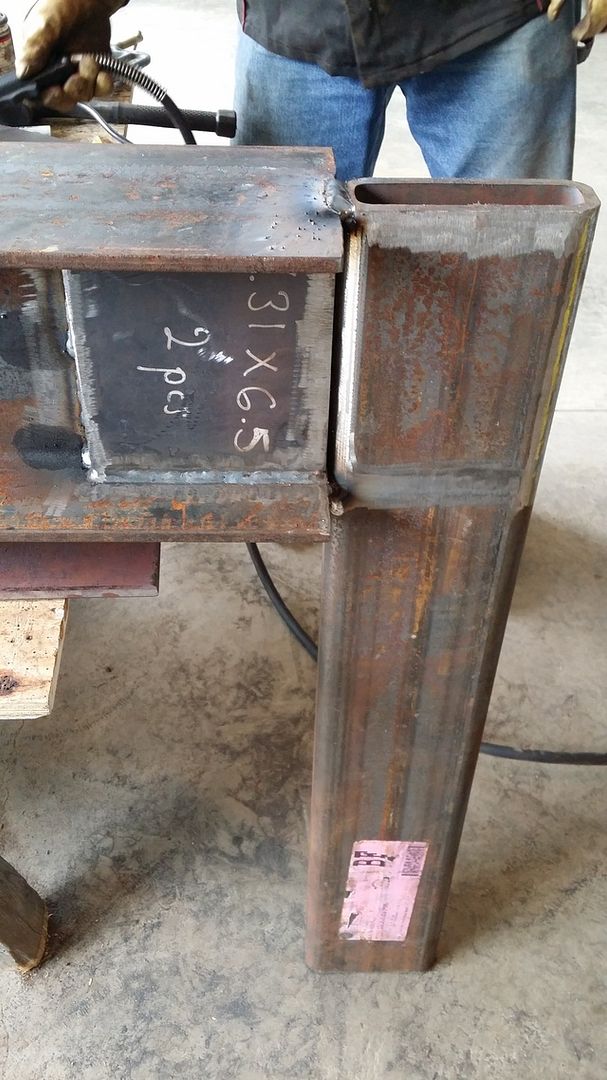

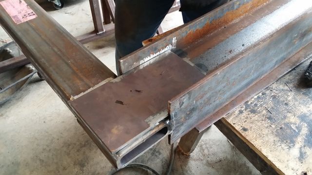

Today we set up a dial indicator to get a baseline on splitter beam deflection. We put a log sideways in front of the wedge and ran the splitter up to 2000 PSI (19 tons). We saw the beam drop about .150" under the cylinder mount. It seemed like we had a lot more than that the first night we ran it. However we were running it at night and visibility was leaving a bit to be desired.
Next we boxed in the beam running 3/8" plate down each side placing it 3/4" in from the outside of the beam so that our pusher can still run freely.
Tomorrow we will check to see if we've reduced the deflection.

We tested it out today and I don't know what to think. Along with boxing in the beam we added a support directly under the cylinder attachment point. In doing this we can not measure the reduction in deflection. In the video below you can see that we've now changed from the beam bowing down at the end under the cylinder support to a beam that bows up.
Note: the box runs the full length of the beam. We had to use 2 pieces per side and we overlapped them by 6". The 8x20 piece you see marked is the outer piece.
Thoughts? Is this acceptable?
We located the cylinder 8-1/2" above the beam so that it would be in the center of an average 16" log. I'm wondering if this was too high and that is the root of our problems.
We could try to move the cylinder down. This is not a popular idea since we have no idea how we would ever drill a 1-1/4" hole through that 1" plate while it is mounted in the machine. Or we could reinforce it some more. I am thinking of getting a 30"long piece of heavy C channel and setting it upside down on the top of the beam. Cut a slot for the cylinder support and weld it all around. Either that or getting some more 1" stock cut and weld a web on the front of the support that tries to spread the force down the beam.

Way to high. I personally think it should be as low as possible
   / Another Firewood Processor #105
Can you add a gusset from below the ram attachment to above the seam between your reinforcement plates? Looks like nothing travels there?
The other option would be adding another rib in line with the web of the beam but below the lower flange. Maybe some channel to box it below?

I'm guessing the height of the ram from the beam is a major contributor to the problem. Looks to me that it's the length of the lever of the mounts that is the problem, which shows up as beam deflection.
I could be way off here but throwing the thought out for you anyway: due to the short length of the cyl mount (as measured parallel with the beam) compared to the cyl offset which you say is about 8.5", the forces from the cyl are acting at a 45 deg angle (or so) to the beam. If the beam and mount were extended further behind the cyl, would that allow the force angle to be more acute than 45 deg and reduce the deflection? Or would the weak spot still be at the leading edge of the cyl mount and nothing be gained?
I don't quite follow your description about the C channel but if you are looking to add more beef to the beam, nothing beats depth when it comes to strength. Is it possible to stack another H beam under the existing one?
   / Another Firewood Processor #109
For bending, stacking another I-beam like mentioned above would certainly help. For twisting, some gussets perpendicular to the web would help.
Ken
   / Another Firewood Processor #110
It's hard to really see in the video.....for me anyway, but to me that really doesn't look that awful bad. You are going to get some deflection no matter what you do to it. Where the problem comes in is when it deflects and don't move back into it's normal shape. How much more you could throw at it before it gets to that point is the question. You could be almost to that point now or it may be that you could throw another ten/twenty tons on it before it reaches the point. Another thing to remember is that the large majority of wood is going to split well before you get to the point of what you are placing on the sideways chucked piece of wood you are testing it with now.
As others have noted you are rather high with your rod attachment on the pusher and also the height of your wedge is going to add to the problem also. Your cylinder should be as low to the beam as at all possible and remember the pusher block nor the splitter wedge needs to be the same height as the wood you are splitting. Tall wedges like your are better suited for a box type cutter where you will get some added support from several different points rather than just at the bottom attachment point. Just my 2 cents worth of thought thrown in.....nothing written in stone.

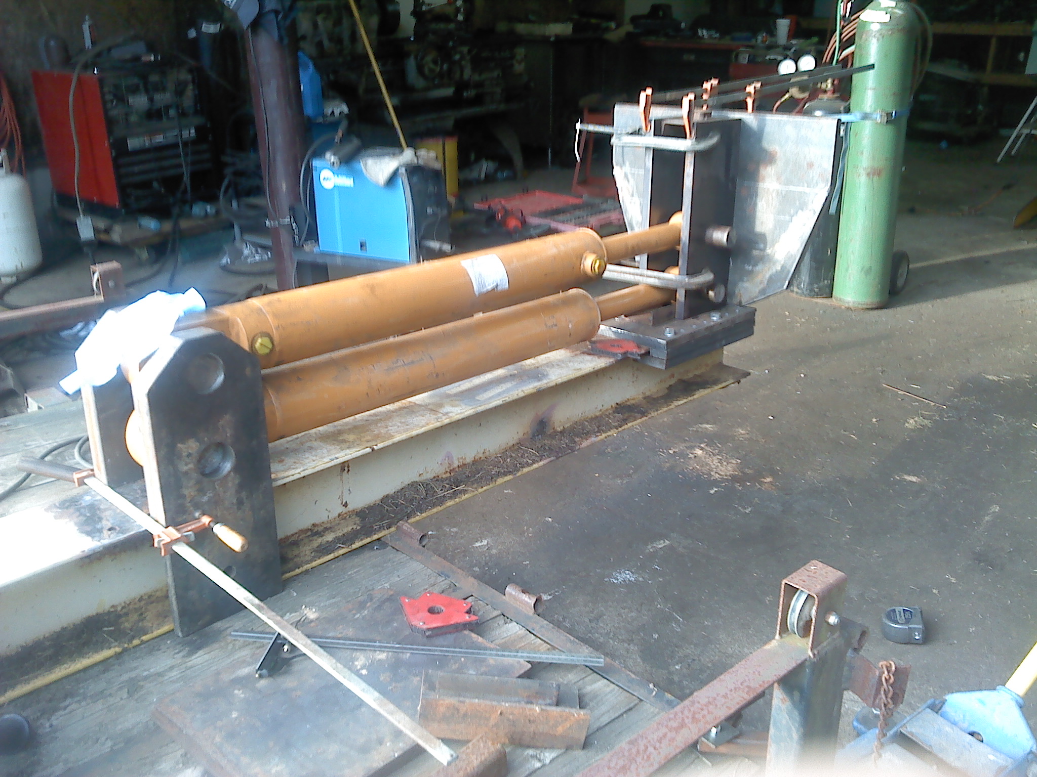

Ill throw up a pic of my cyl mounts. 0822151909.jpg. Of course my mounts are for 2 cyl instead of one, but my pusher block is the same 20in tall as yours. Past experiences on a few other splitter builds and I found pretty much the same thing you have with high cyl mounts. The higher you mount the cyl, the more the base mount is going to flex. While my top cyl is mounted at about the same height as your single cyl, I mounted the bottom cyl as close to the hbeam as possible. I also chose to use to side plates for the base instead of one center mount which will give a little more support when pushing. I havent boxed my beam yet, but your pic's of boxing the beam is pretty much exactly what I had planned. I also intend to plate the top of my beam. Plating the top of the beam will provide a lot of support when it comes to bending/flexing the hbeam under load. My thought for you are to lower your cyl mounts as low as possible. Make your slide/pusher plate as long as possible and then brace the pusher to keep it from bending backwards. My current splitter has a 5in bore cyl and is mounted with a single 1 in plate at the base like yours, and the sides of the web are plated with additional 3/4 plate, both sidesbut it only extends about 6 or 8 inches toward the front of the hbeam. I have never noticed my hbeam flexing at the base of the cyl. The wedge end of my beam is plated on both side with 3/4 plate and 6in channel on both side. securedownload.jpg, I have seen it flex and I actually think I bent the hbeam where the plateing ends. My wedge is 24in tall adjustable and a 6way. If your not able to lower the cyl mounts, you might consider just welding ome sqtube between the cyl and beam. You can sandwich the base mount between the tube to give it some extra support at the same time. probably the cheapest, easiest fix and will really give your hbeam a boost of strength
I think the URL is a little off, Your not a dumbass, dumbasses dont build what you have built.
#112
Thanks for the info muddstopper. I had seen your dual cylinder design somewhere on here but had forgotten about it. Very interesting indeed!

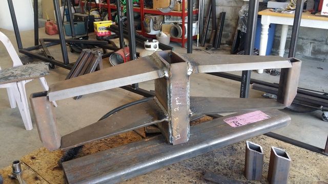

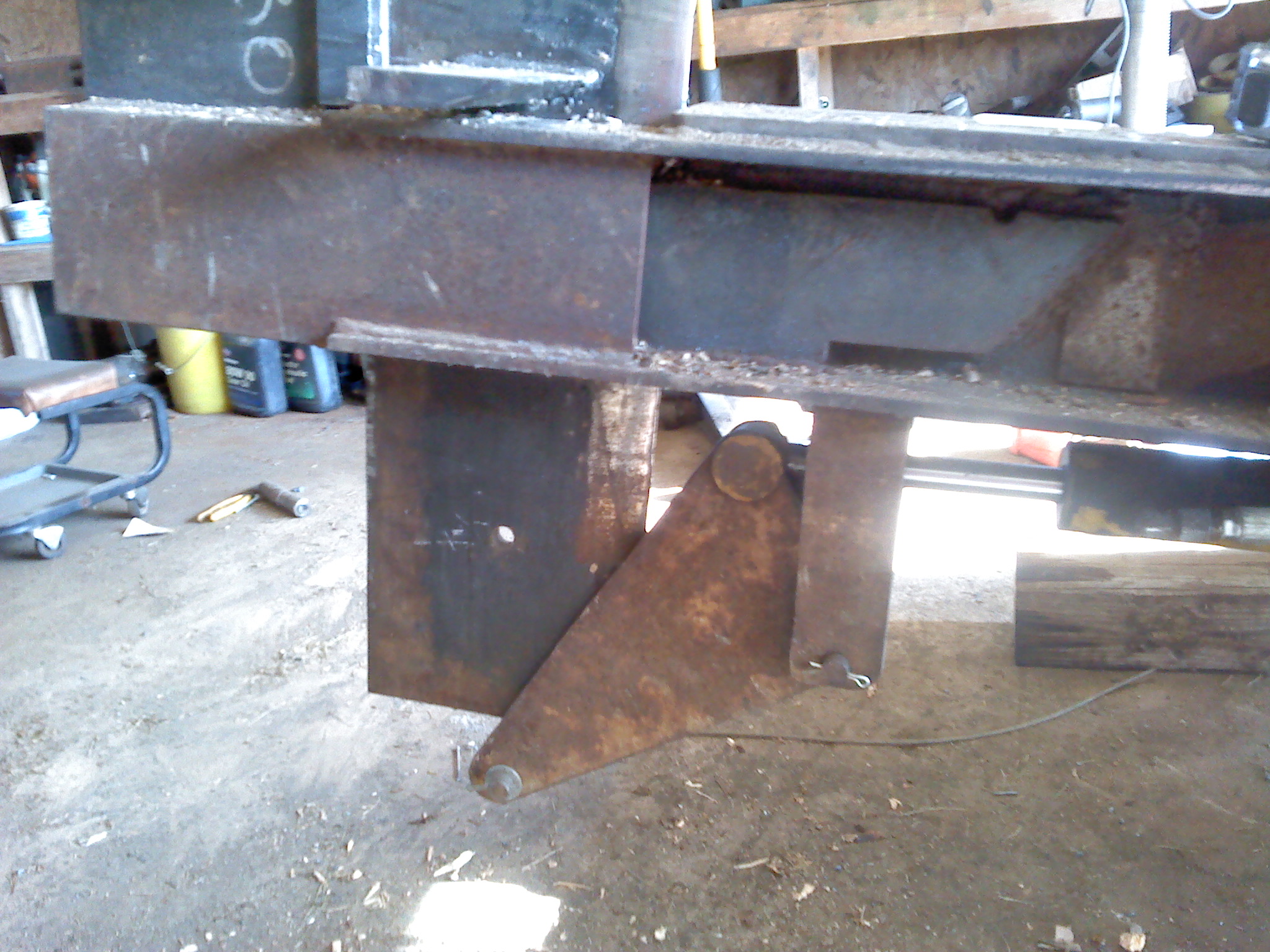

Update: We processed about 6 full cord this weekend and found some issues that need to be addressed.
Issue #1 Bending the pusher plate forward.
Since our load of logs had so many that were small in diameter it showed us just how easy the pusher could break its welds. They cracked right down the middle. The cylinder being mounted 8-1/2" above the beam and us not having larger gussets in there caused this issue.
We then put a log cross ways at the top of the wedge and tried to push it as far back into position as we could. We re-welded the vertical members and are planning on adding gussets. Unfortunately in this picture you also see the results of our second issue. The pusher lifting off of the beam.
This pic shows the gussets we plan on adding to the back of the pusher as well as a piece of C-channel we want to add to support the cylinder mount some more.
Issue #2 Lifting of the pusher plate.
Here you see how the plate lifted.
The spacers in between the pusher sled and the lower plates was left a little too thick. We have since machined them down and hope that if things are tighter they wont start to bend quite so quickly. Again, we feel that this is mostly due to having the cylinder mounted higher.
So to fix a lot of this we will need to drop that cylinder. But right now the top of the pusher plate leans forward towards the wedge. A bit over 1/2" difference over 20 or so inches. With this lean now welded into place we have an issue. If we drop the cylinder now, whenever we run larger diameter logs we will be pushing the pusher plate up at the front similar to what is shown in the 2nd picture . So for now we are just going to add the gussets and try to get this years wood done. Over the winter we plan on squaring up the pusher to the pusher sled (likely building a new one) and dropping the cylinder by 3 inches. We are thinking that we would not make the pusher plate nearly as high so we keep the forces lower. We will run the splitter roof supportsfrom behind the pusher plate.

Well, first, congratulations on processing 6 full cord, that's a big accomplishment.
If you're going to reconfigure your cylinder mount, don't just drop it 3 inches, drop it all the way to the bottom and brace the top of the pusher plate. Here's a picture of my pusher plate that's lying on it's side. The cylinder is as low as possible with bracing to support the top of the plate. I've had no issues.
I don't think machining the spacers is going to be enough. "Where's the beef man!!!" The steel guides need to me much stronger and it looks like you need several more bolts and you should make them grade 8. As you know, my machine works a little differently but the guide is made of 1/2" steel and is continuous from one side to the other. A picture from the bottom should show what I mean. If possible, I'd use the underside of the beam, otherwise, I'd beef that up significantly. I think if the guide had been strong enough to resit the upward force, you may have bent the top of the I beam, it may be a good thing if failed where it did.

I was planning on adding that upside-down piece of C-channel on top of the beam to strengthen it a bit more. My Troy-Built 33 ton unit has that setup. Dropping the cylinder 3" would put it 1/2" above that channel.
We made those bolts and bottom plates weak on purpose to do just what they did. Obviously the last thing we want to do is bend the beam. We are in the process of making a bunch extra bottom plates. For the time being they will be a wear item that is checked daily That is until we drop the cylinder and get the pusher angle fixed or end up replacing it.
If that does not fix things then we will need to regroup. Maybe making something that wraps under the entire beam will be the solution. I never thought of that. I think we'd need to move one of the beam supports but that is not the end of the world. Is that nylon that you are using to reduce friction? How is that holding up?

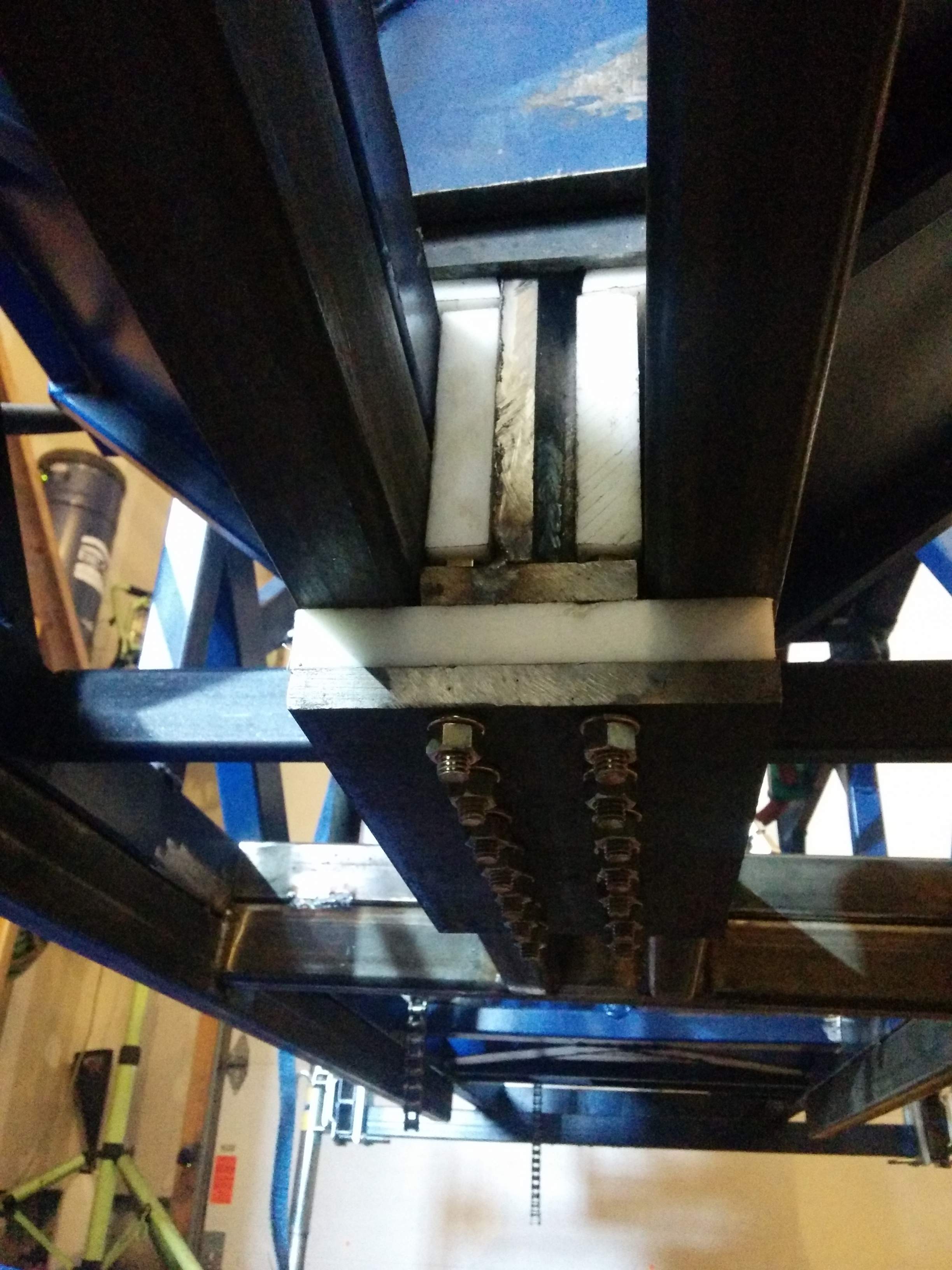

If using the bottom of the beam is an option (you can move the beam support), I highly recommend going that route.
I'm not sure if it's nylon or some other plastic. My neighbour used to run a plastic manufacturing company and sold me a large chunk that I cut into a blade for the bottom of my snowblower. The blower is about 1500# and it's used on a paved driveway. I've used it 3 seasons without any noticeable wear. I've only processed 6-8 face cord with my processor, but there is no noticeable wear there either. I don't think it's 100% required, but I had the material and I think, if anything, it will help. I had to cut some of that material away so that it didn't act as a brake against the bottom of my beam and I cut a little too much so I do get a little upward movement on my pusher plate, but everything has held up well so far.

We beefed up the bottom plates under the pusher plate to 3/8" steel. They bent slightly right after the install but have remained on there for at least 18 full cord. The old ones made of 1/4" steel would have to be replaced pretty much daily. We are pretty darned happy with that!
Note: We have NOT moved the splitter ram down as we were talking before.

Some of the logs we get in our loads are 20 feet long and our machine was only designed to handle 16 footers. The longer ones will usually balance okay on the rack if the butt end is towards the business end of the machine. However, when we drop them down into the infeed trough some of them will tip down out the back end to the ground. We're thinking about adding a 3 or 4 foot extension on the machine to better handle the longer logs.
Logs drop haphazardly into the splitter trough. Some logs drop right in place, hammer the splitter levers, and go. Others you need to wrestle with each piece as they drop. Not sure what to do there yet but we will probably try to do something.
