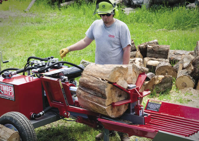

Opinions on splitter through design?
I like the V design of the bigger Twister Hornet models It will center up any sized log but that comes at the cost of complexity of the trough and especially the pusher / I-beam attachment.
Smaller Twister models have a more traditional pusher that runs on the I-beam. The trough ends about 10" before the wedge to allow for the log to spread out as it splits.

We stopped out to look at a Multitek processor a couple weeks ago and talked to the owners. After that we decided to change the wedge design to simplify the build. The box wedge just made everything so much bigger... After looking at Multitek, Timberwolf, and Built-Rite models that all use very similar wedge designs we decided to go that route.
We have a 1" thick x 5" deep main wedge with 1" angle welded on the sides for a spreader.
We have 2" x 6" rectangle tubing mounted behind it that the multi-wedge will ride up and down on.
The multi wedge will now be able to cut up to a 14" log 2 ways with the wedge all the way up and it can cut an 8" log 4 ways if all the way down.
It is still a progressive 8-way design but less complex since it does not have as many angled wedges and no longer has the box.

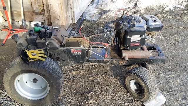

We have the two lawn tractors tore down.
I have a question for those whom have done this stuff before. The 22 hp engine had an electric clutch to engage the mower. Should we keep this mechanism in tact. This would allow us to start the engine without any load and then engage the hydraulic pump once the engine is up and running. Could be helpful in cold weather... To do this we would have to drive the pump via belt rather than direct drive with spider couplings.
You guys think it would be worth it?
We could likely find a similar clutch for the 18 hp if it were worthwhile.
   / Another Firewood Processor #45
Keeping the clutch means more stuff to breakdown/maintain.
   / Another Firewood Processor #46
When the clutch breaks you'll wish you hadn't. Direct drive it, just start at low throttle opening you should be fine. Mine is direct and easy to start, though maybe a bit tough to pull over when cold.
